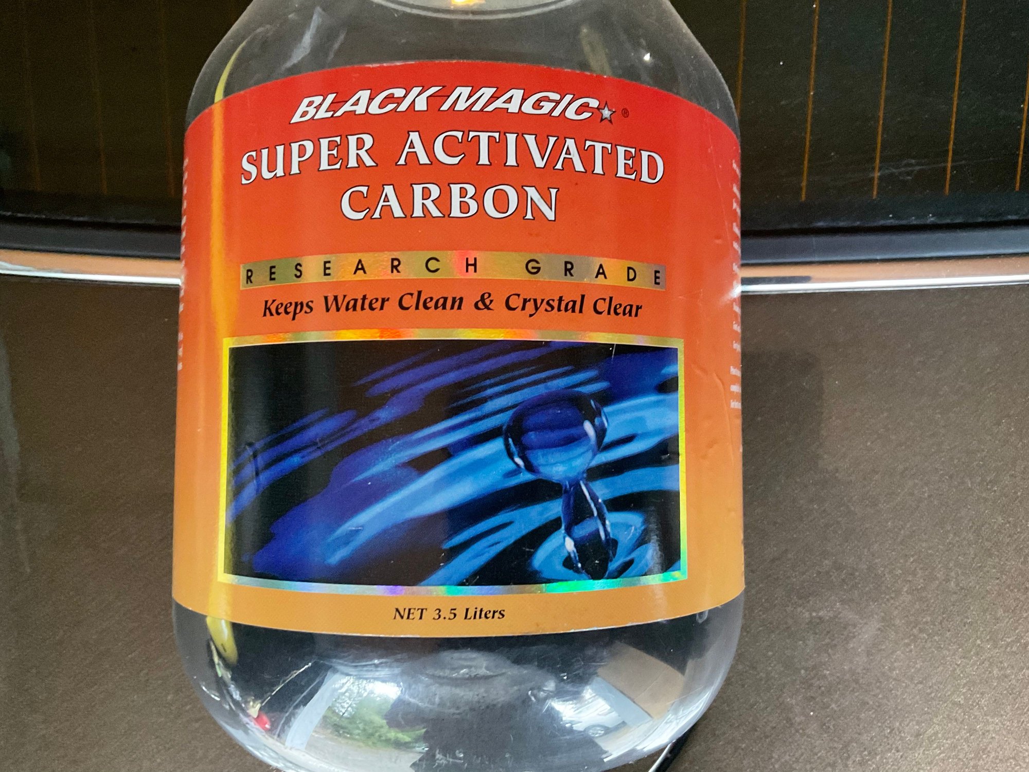

Old May 5, 2022 | 01:35 PM

Aquarium charcoal works well to replace the old charcoal. It can come a little hydrated; dry it very well first or the canister will drip for a few weeks. I’ve done it with good success on two of them. Cracked the shell open around an end seam and put back together with superglue.
