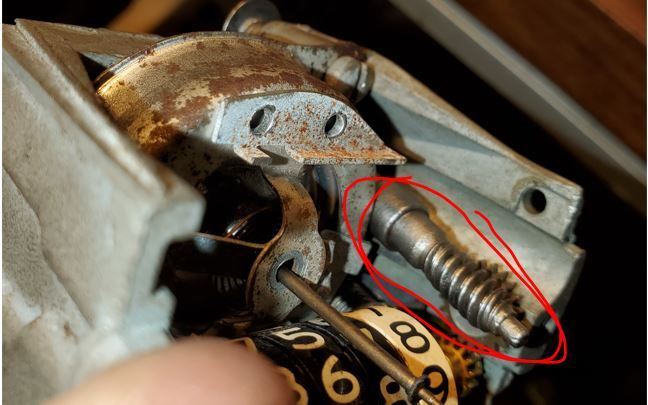

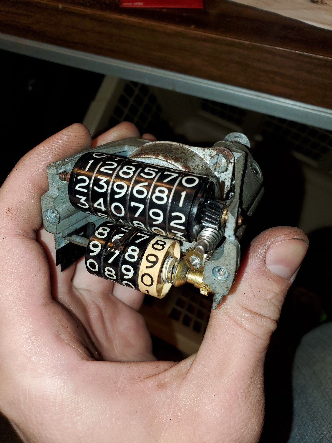

I had 2 main issues when I repaired mine:
1. The worm gear was stripped
- Not that bad of a fix. Many metal gears are available for purchase, but the best way to do it is to replace with a plastic one, if you can find it. This plastic gear gives a known weak point so the rest of the gears don't get trashed. I couldn't find a plastic one, so I had to replace with a metal one.
that's the metal replacement worm gear

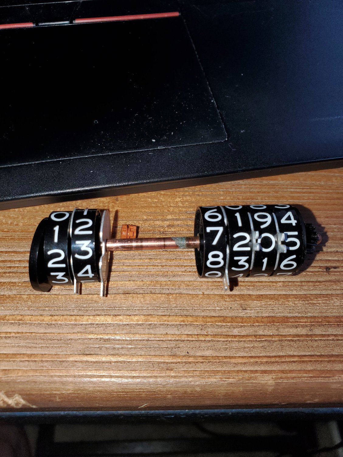

2. The number rollers on the odometer and tripmeter were frozen/stuck on the shaft. I think this is the reason why the worm gear got stripped. If you see how the mechanism works, you'll see that the speedometer turns that worm gear, that then turns the number rollers. I had to fully remove them and carefully free them up by working them back and forth, and putting the TINIEST bit of penetrating oil on the shaft. Be careful, though, the penetrating oil can make the printed numbers rub off.
The shaft looked a tiny bit corroded, so when I freed up the rollers, I used some steel wool to get rid of the corrosion make sure it was smooth.
(you can see that grey spot on the copper colored shaft; that's the corrosion I'm talking about)
If you go through all the trouble to remove the dash, speedometer, etc. I would make sure you check those number rollers, or you may have to do it all again.
Don't just replace the plastic worm gear

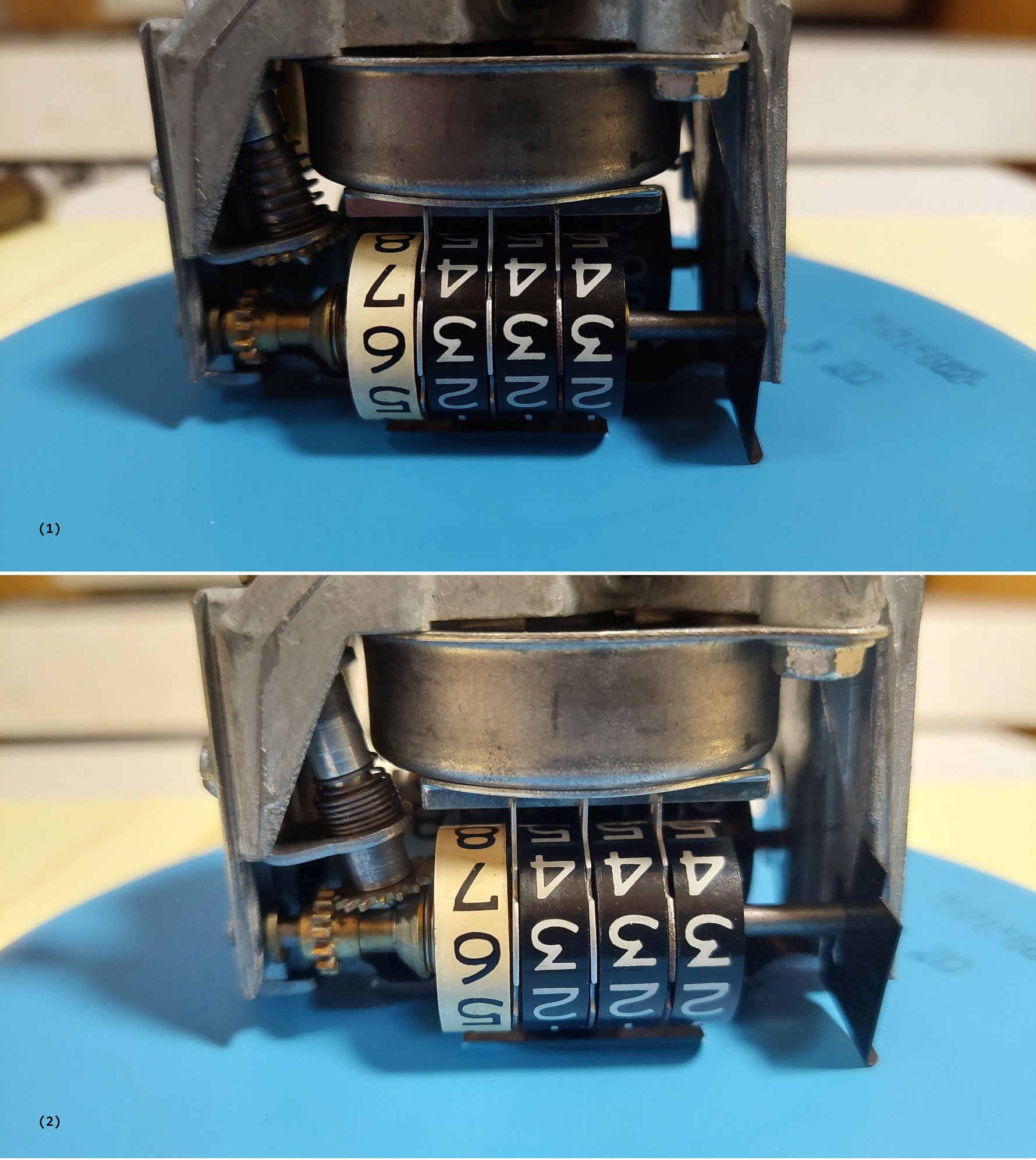

Good photos above!
I would also like to add, you can see in the 2nd photo above there is a small spring between the 1/10 and a smooth brass bevel section of the brass shaft.
When the reset cable is pressed in it allows the brass shaft to move just enough to disengage the side idler gear so reset can happen.
If that shaft is sticky and doesn't return the brass trip shaft gear will not make contact with the side idler gear that is the drive for the trip odometer.
That is the function of that tiny spring.
(1) Reset Cable Home position
(2) Reset cable pressed in
