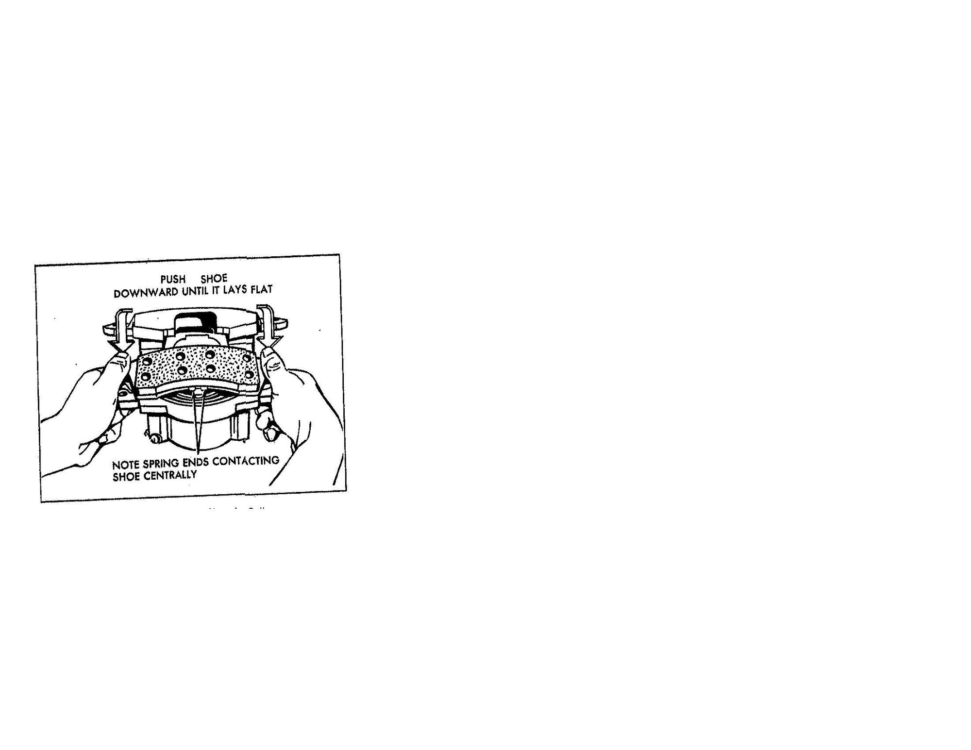

Originally Posted by Jd21476
It may be black because it has been running down the inside of my tire before hitting the ground. Either way, I called Autozone and they ordered me two new ones. I pulled these and will take them and swap them Monday
When you install the pads be careful not to TIP or ROCK the pistons from side to side, the piston must be pushed straight into the bore so as not to pinch the seal.
With the pads squarely in the caliper, place a 1 and 5/6" spacer between the pads to keep them pushed back, and then install the caliper.
