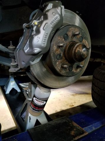

Do you need your specific calipers back for NCRS reasons?
Otherwise, just buy Lonestar rebuilds, and send your old ones back as cores. You can do this through a vendor, too, if you are assured of getting sleeved original Delco Moraine castings from Lonestar.
For example, I have a set of these in my 79.
https://www.zip-corvette.com/65-82-r...ring-seal.html
