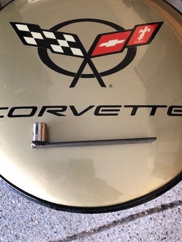

With the condenser and/or headlight actuators removed (I removed the condenser) and radiator support pulled forward there is enough room to drop a fire truck in that space. Below is a tool I made (3/8" 1/4 drive socket, J-B Weld, flat stock) to remove the lower condenser mounting screws. Dumping the AC charge and removing the condenser took all of 30 mins, way easier than pulling headlight actuators.
