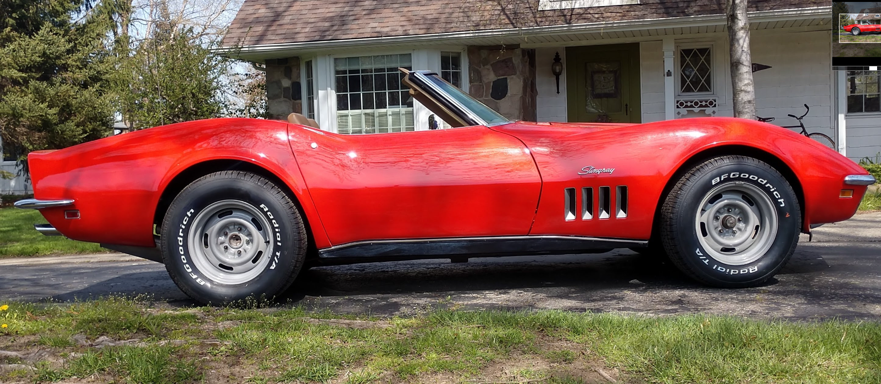

Well here is my new Old Vette. I've been working on a lot of little things to get some confidence for some longer road time. Today I replace the 15 year old 225/70's with 255/60's front and 275/60's rear. The rears fit OK (not sure if they look to big) but the fronts rub on the fender in front of the wheel. I am wondering if raising a bit with new springs would work, or if going to 245/60's would work. I suppose I could trim the wheel well but I don't really want to do that. Any thoughts? Other ideas?

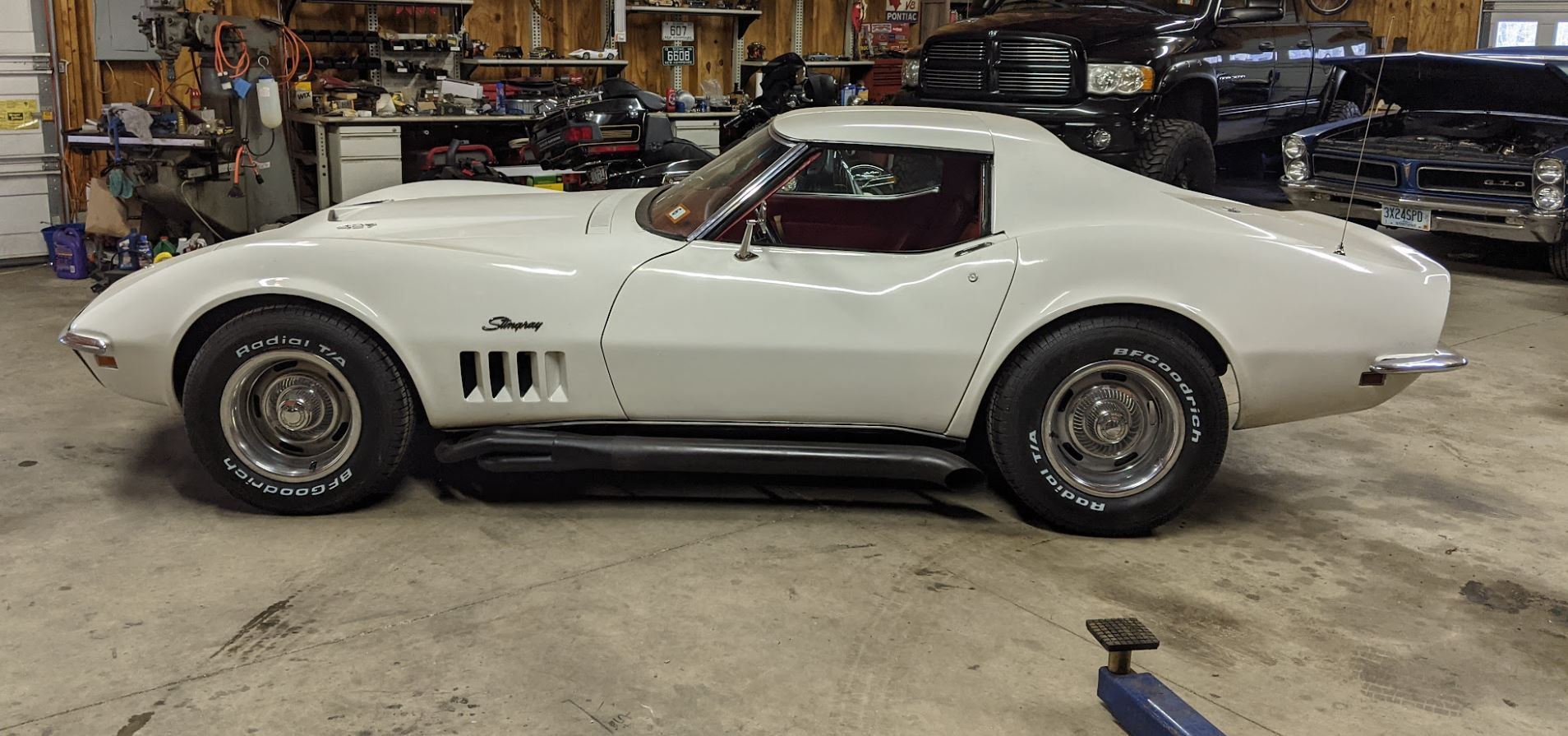

Another interesting thing... When i put 295/50's on mine, on 8" rims (3.5" backspace), just to mock it up and sit there all cool... the fronts hit the front fender BAD. Like... i thought i'd crack the fender to fully turn them bad. I chanced a short little drive with them, a few turns, a couple curbs... and ZERO interference... not even a scratch on the paint.Check out the pic. WEIRD.

This 69 has had 255s on the front for the last 32 years I've owned it. Has never rubbed.
I just last weekend replaced the 17 year old Dunlop tires with some new BFGs.
First time I've had 275s on the rear of this one though, have always had 255s all around.
