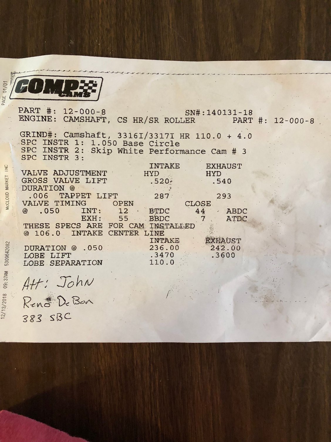

Back when I had a 383 and 3500 stall consistent 11.70 with Goodyear slicks 4.11 rear end I went with a solid roller to NOT be rpm limited like a sub 6500 rpm H-roller. I was shift at 7200+ rpm rev limiter set to 7500. All this with AFR 210 heads and 11ish C/R team "G" single plane with wood spacer custom Comp cams equivalent to say a Extreme energy 242/248 if you used the .200 lift numbers
