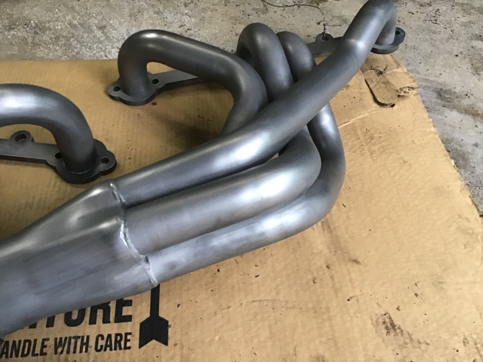

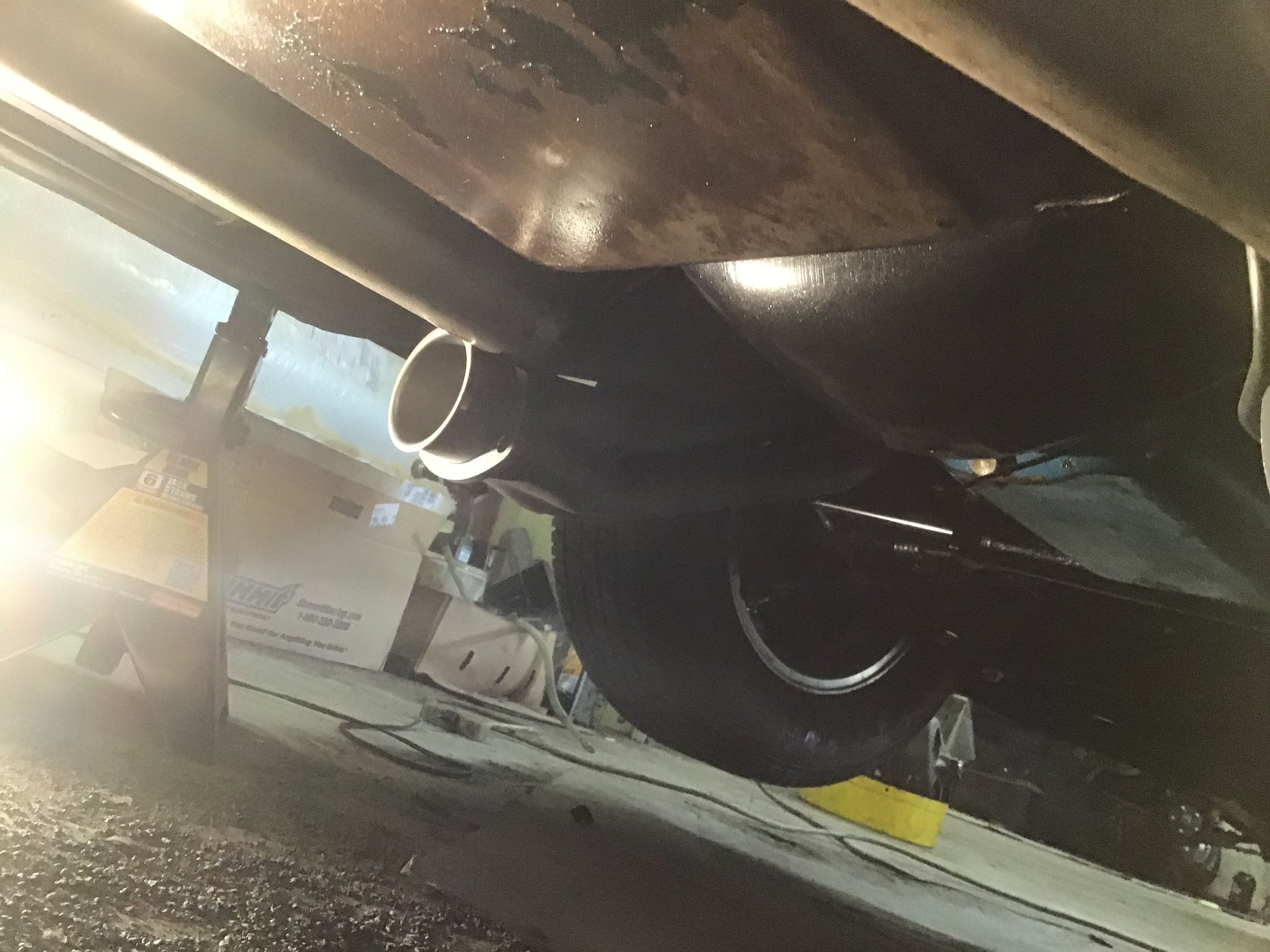

I put headers on my car,not sure who makes these,but ordered them and of course they are specifically made to fit my year,which they do,including clearing the starter,which I didn’t think they would,and I paid $200 for them and did the ceramic coating myself outside.so the issue is ground clearance,because they do hang lower than my stock pipe,but the thickest part of the header is at least a inch bigger,but the last few weeks I’ve had it jacked up,so hard to tell until I got it on the ground,and at the thickest part of my header I have 4 1/4 “,and from my stock pipe I have 7 inche,so,my question is what header will give me at least 6 inches of clearance. And anyone here with 1981 with headers,what brand are you using?

Headers are two inches below my existing pipe I want a direct fit,maybe different headers that don’t cost a arm and leg.
The car is in the air,but did lower it,and from the fat part of the header where the 4 chambers go into one,is just over 4 inches of clearance.
Headers that fit closer to the under carriage.

No,where the header drops down.and my concern is our bad roads and big dips causing scrubbing problems.

Those are low. Your connecting pipes aren't nearly that low.
I wonder if the manufacturer thinks you have to drop down lower to clear the motorized seat. If you don't know who made them, do you know where you bought them?

No,not really, I’m very inpatient and that was the first thing I ordered for the car,because as someone on here said,and I agree a corvette has to have long tube headers,and now about $5k later,and just ordered another set from Summit that is made only for corvettes,and to give you the same amount of clearance as the stock,so time will tell,but they will have to be ceramic coating.so,keeping my fingers crossed,oh,the headers are Summit headers Sum-G-9003.

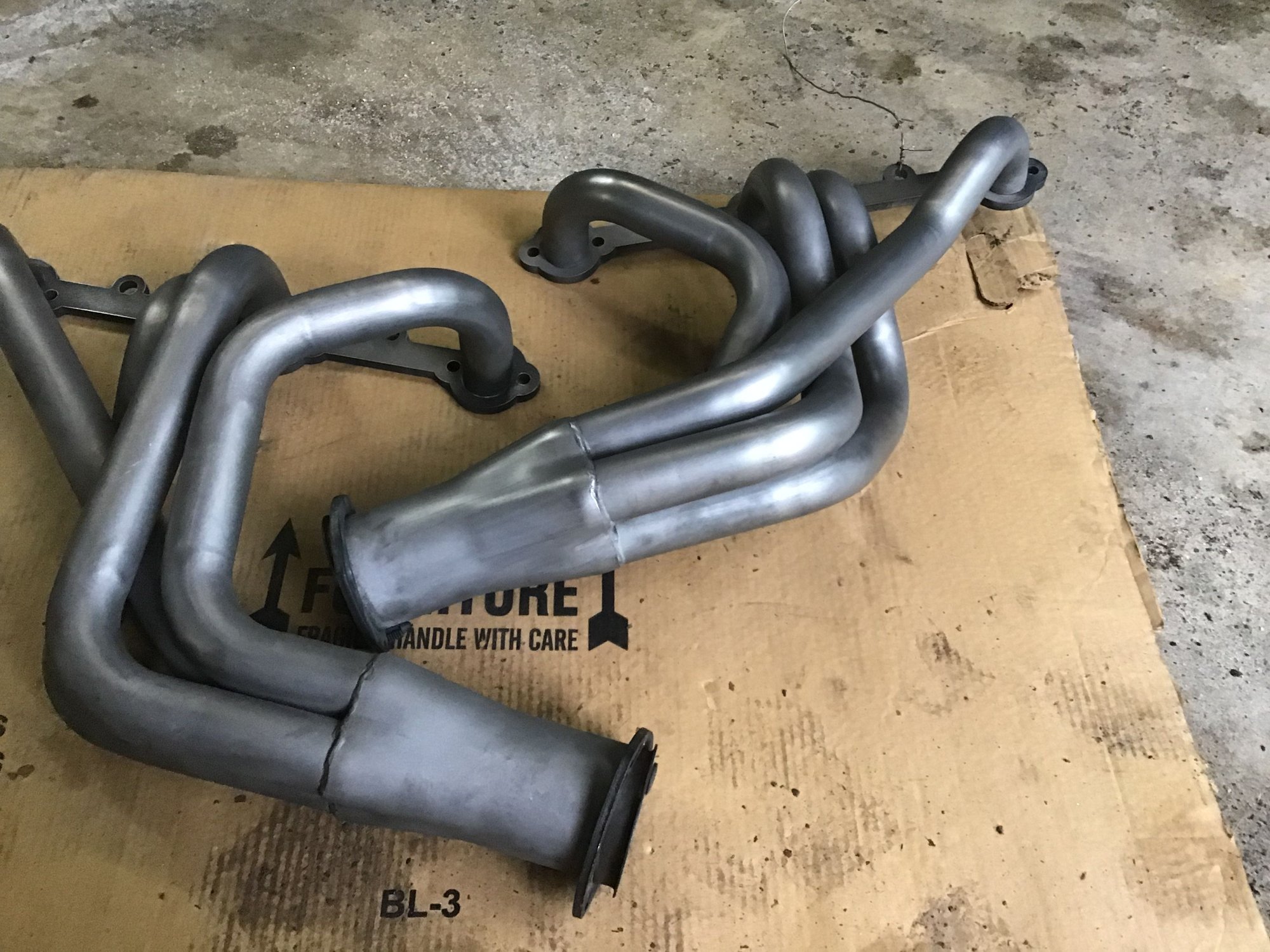

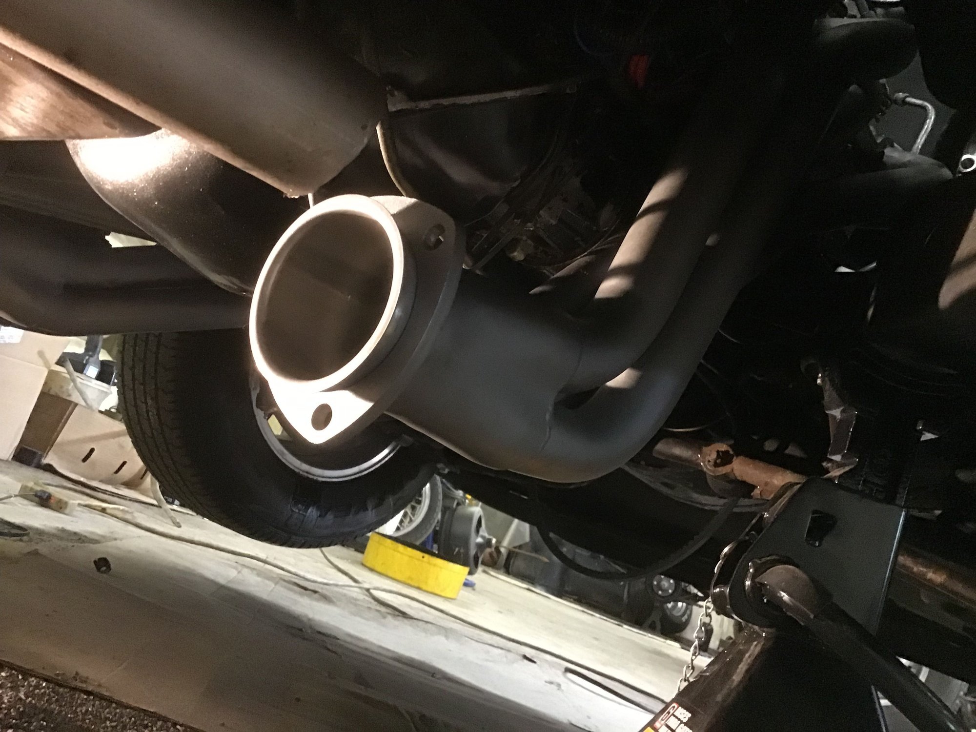

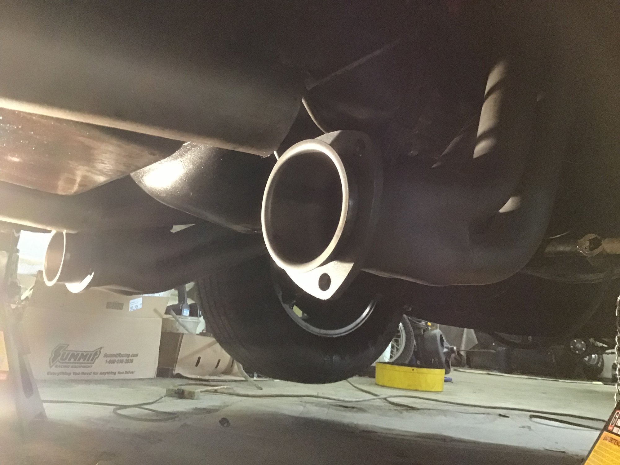

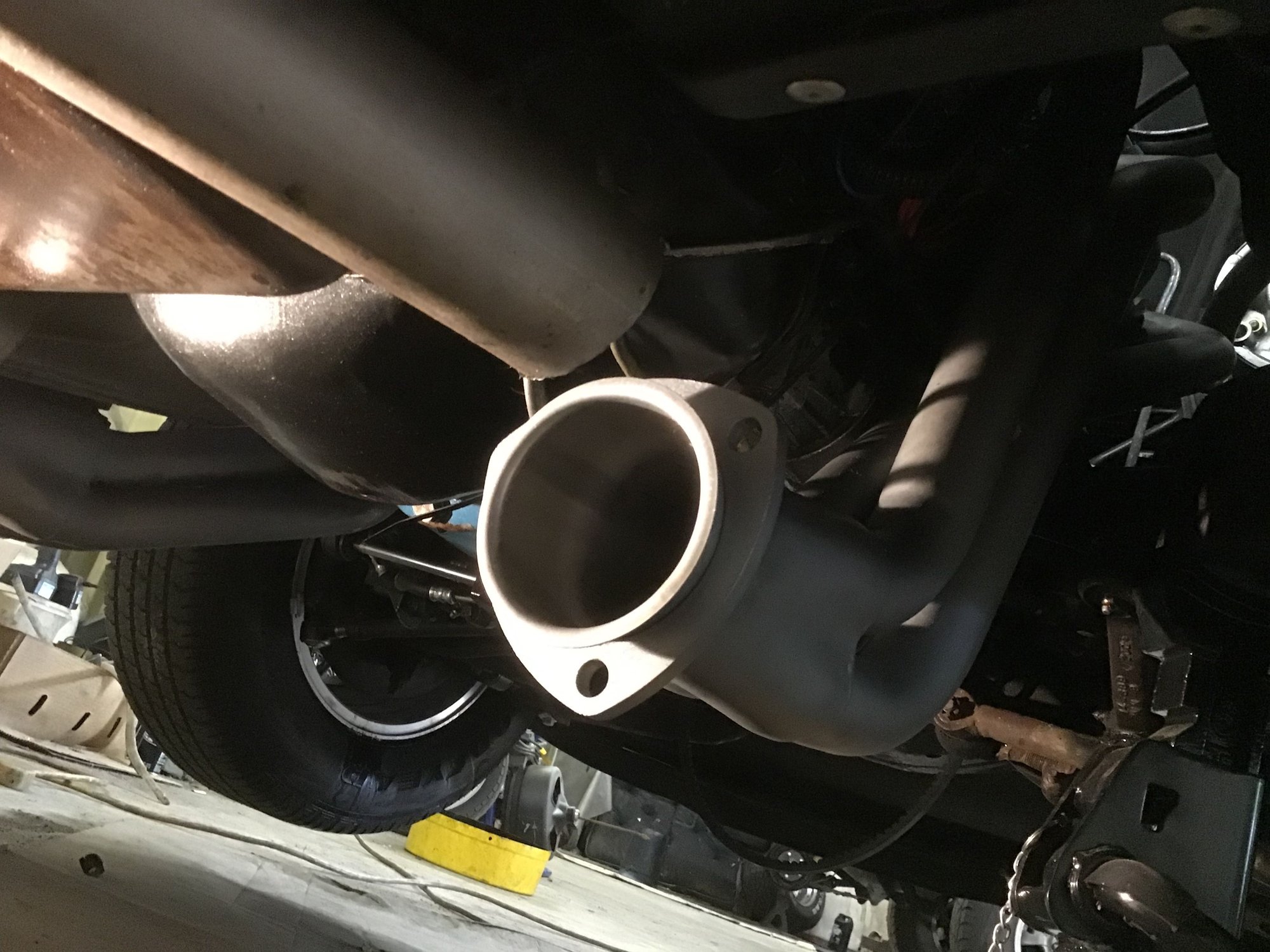

The black ones are the new ones,and have already installed one side to check ground clearance,and they lined up perfect with my existing pipes.
Now,they will have to be ceramic coated.

how are the bottom of the black ones relative to the oil pan?
Also, what brand and part number? Is your car a four speed?

The black ones came from summit and part # is G-9003,and no I have a automatic and no issues with oil pan.
