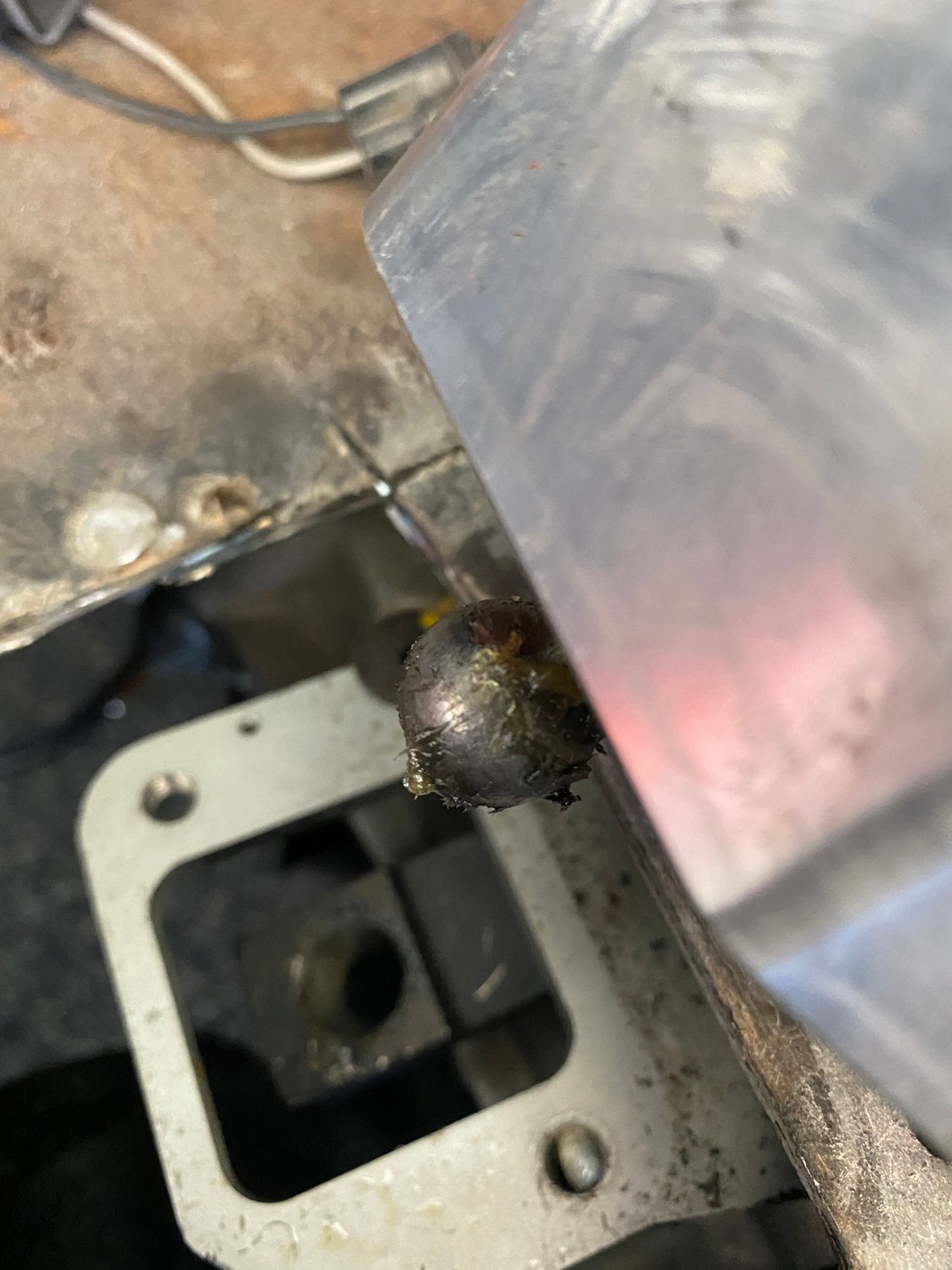

So I figured out what is wrong and I wonder if Im missing a part. The ball on the bottom of the shifter popped out of the selector mechanism. Is there supposed to be like a plastic cup or something to hold it in?

I would call Silver Sport Transmission. They will inform you.
Old May 14, 2022 | 05:53 PM
RBrid's Avatar
RBrid
Joined: Feb 1999
Posts: 1,052
Likes: 389
From: Woodinville WA
In my case there is a piece of plastic surrounding the ball. See the third picture: Three... two... one... lift off! - Page 32 - CorvetteForum - Chevrolet Corvette Forum Discussion
It's a TKO 600.
Old May 14, 2022 | 06:17 PM
kossuth's Avatar
kossuth
Joined: Jan 2003
Posts: 961
Likes: 275
From: Frederick MD
Not sure about the TKO but I know on the T56 there is a single roll pin on there that holds the whole shifter rail and shifter cup altogether. That roll pin breaks and this happens on a T56.
Old May 14, 2022 | 06:43 PM
derekderek's Avatar
derekderek
Posts: 13,082
Likes: 3,399
From: SW Florida.
the shifter ball and cup is a bunch cheaper and easier than the whole trans. call this one a win.

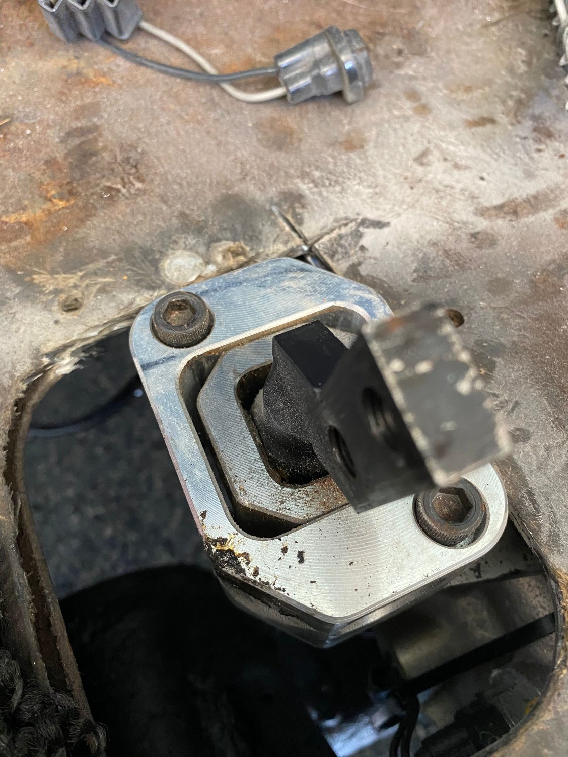

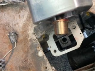

I found a brass collar after doing some research over the weekend. It said it was an upgrade from the nylon collar. Can it be used and is that true or is the nylon the only way to go?

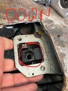

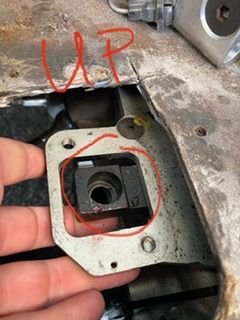

So I put a new brass collar at the end of the shift rod but is there something that holds the brass collar into the cup on the transmission? It just drops down and then the brass cup pops out. Am I supposed to glue it in or JBWeld?

Am I missing a part that fits under the shift lever part?
Old May 19, 2022 | 08:31 AM
SSTJeff's Avatar
SSTJeff
Cruising
Joined: Feb 2022
Posts: 12
Likes: 13
From: Maryville TN
First off, I apologize for not catching this sooner.
That is not the correct part. Your shifter is a proprietary Keisler Engineering piece which, by my guess, appears to be prior to about 2006 or so. This is referred to as the "roll pin" shifter which was problematic. I would recommend calling in and purchasing a new shift link which uses a captured nylon shifter cup. This will be a trouble free fix. Ask for Chris and tell him to see me when you get on the phone so I can explain what you need. 865-609-8187
