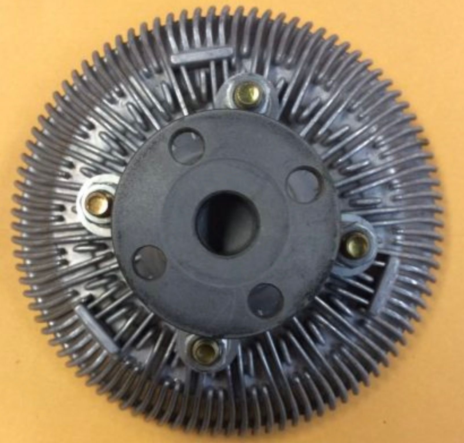

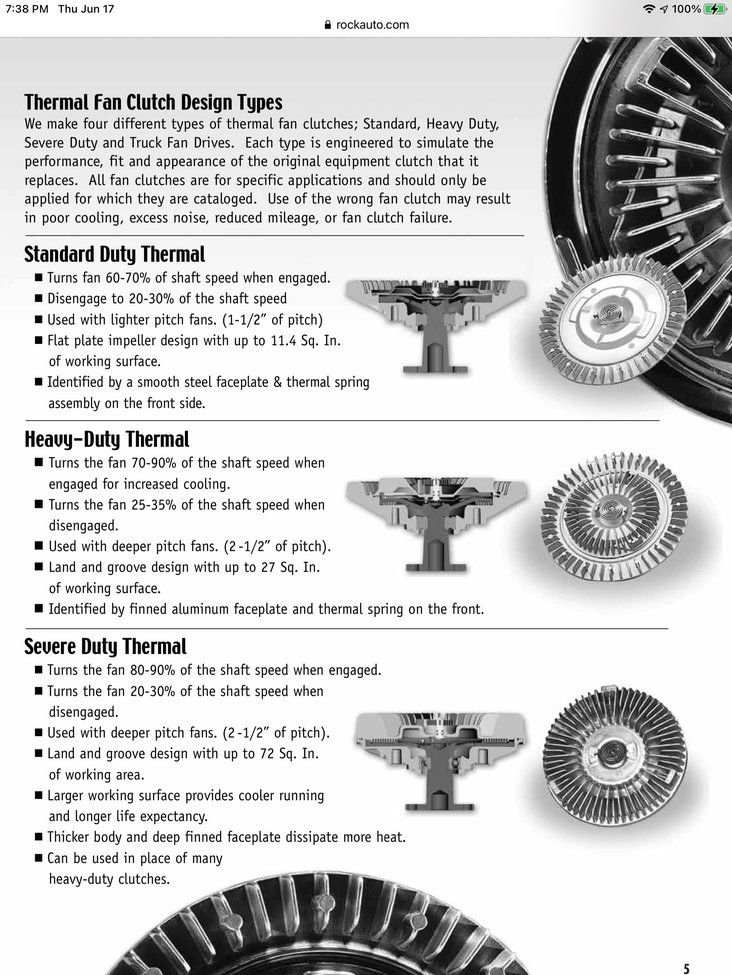

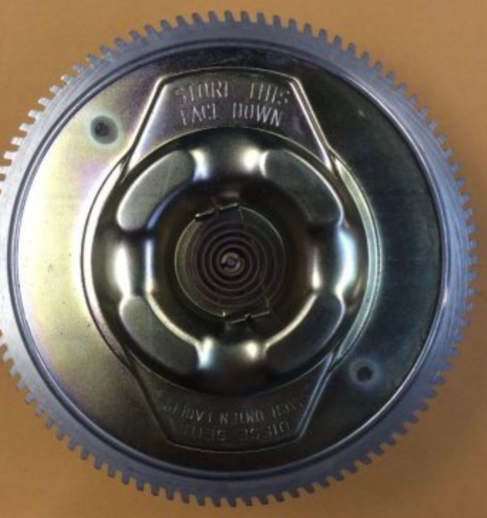

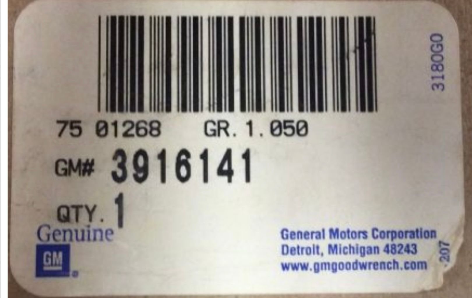

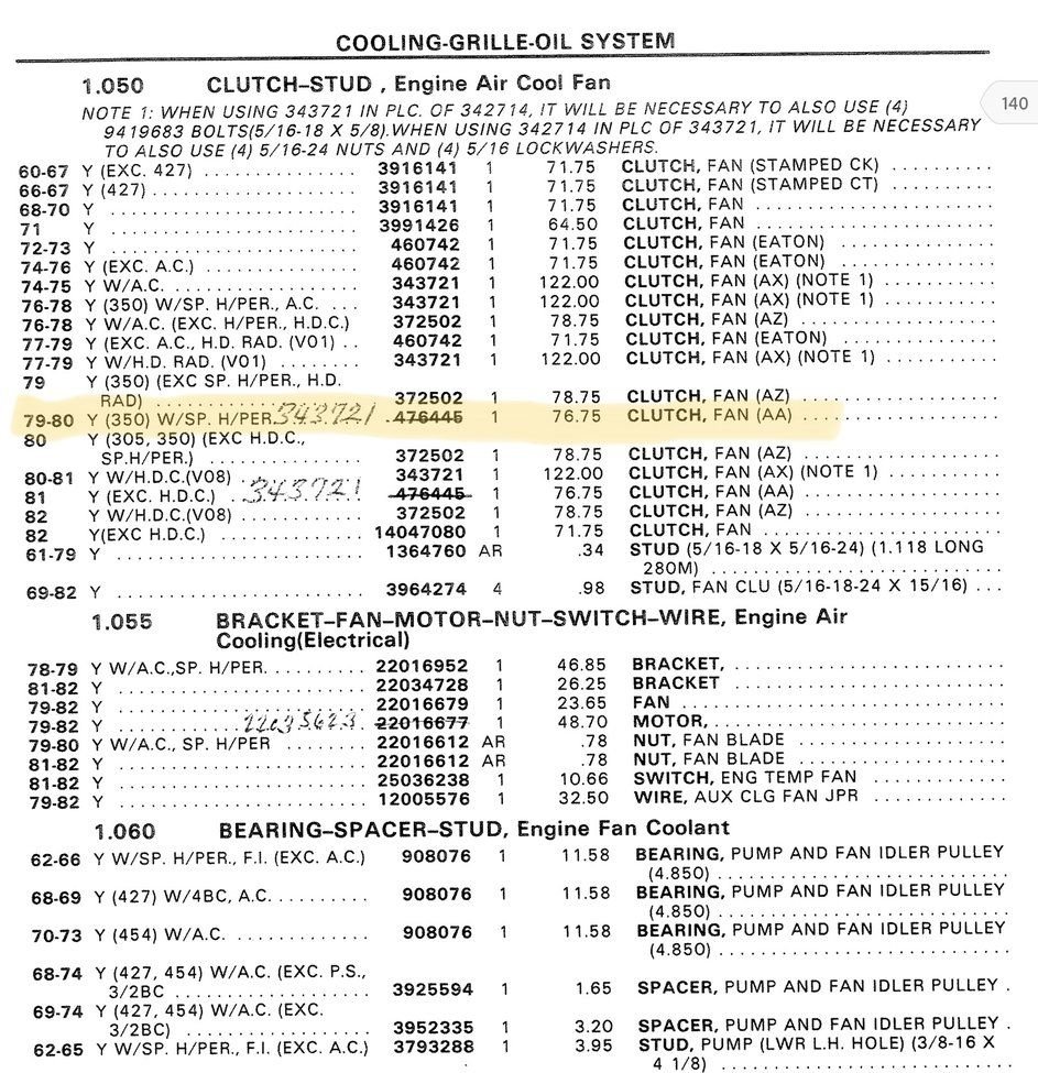

i agree.
op what did you buy? There are hd and regular clutches.. it should spin easy cold
here is my education..
note also as you increase severe duty it does spin a % when not engaged
https://www.corvetteforum.com/forums...re-79-l82.html

Thanks for the answers. I'm beginning to think the new clutch is working correctly. As to your question Interpon, it the Schwitzer sold by Cor. Central. It doesn't mention any duty rating so perhaps not severe as they would probably include that in the description.
The fact that there appears to be no difference as to being able to move by hand on a cold or hot engine and that noise wise "lock up" seems to be at about 2,500 rpm and nothing to do with temperatures as I thought it should. Maybe, as with bruiser it will take some time.
