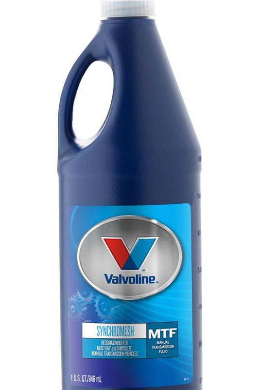

Tremic recommends MTF synchromesh for their manual trannies. So I use this and change it every time I have the tranny out. The idea of using ATF with friction modifiers in a manual bother me and other people that have to rebuild them.
