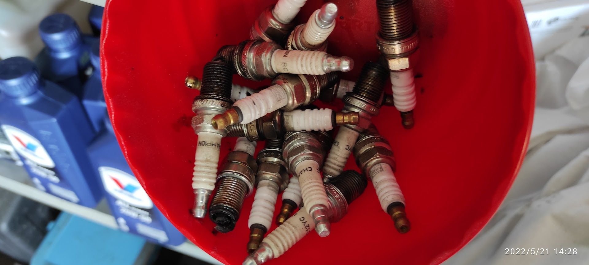

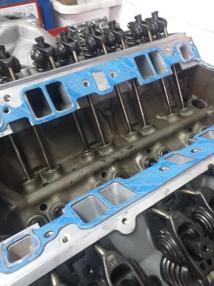

I found a pic of the engine when I placed the intake gaskets. Without sealant on the intake runners. And some of the many many spark plugs that i trashed.

Originally Posted by HeadsU.P.
You can use a tube of RTV or Edelbrock has a sealant called Gastiniche (sp?) that's in a can with an applicator brush.
I have replaced a lot of intake gaskets in my time and never used any sealant on the intake/exhaust portion of the gasket, but it makes sense. I did chase a rouge vacuum leak on my 65 after an engine rebuild and ended up pulling the intake several times and replacing gaskets to chase that down.
Looks like Gasgacinch comes in a couple forms.
1) Gasgacinch 440-A Gasket Sealer and Belt Dressing, 4 oz , white
2) Edelbrock 9300 Gasgacinch Gasket Sealer - 4 oz
Is Permatex 80062 High Tack Gasket Sealant, 4 oz. , Black the same and the above products?

Evidently, after watching a few YouTube vids there are a few people that install Intake Gaskets dry.
Then later, they wonder why they have a vacuum leak, fouled plugs, blue exhaust smoke.
Look for a red metal can. 9300 Inside the cap will be an applicator brush.
Nice & neat product made by a company that knows their way around Intake Manifolds, Edelbrock.

I didn't read all the replies but another common sbc oil consumption problem is not sealing the rocker studs that go into the intake runners. I've also have a couple eddy intakes with bolt holes that were slightly drilled off and when tightened down caused the flange to distort enough to leak at the nearby intake ports. Still I like to use gasket SEALER not RTV
