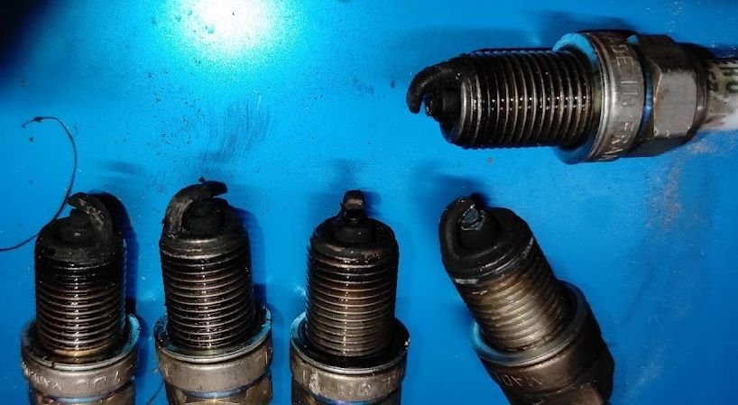

Originally Posted by stingr69
You could add some rubber umbrella seals and see if it helps. I doubt the seals are the problem.
A piston ring installed upside down is a possibility. Check the plugs for oil. Maybe just one cylinder.
All 8 plugs are equally covered of carbonized oil... I change them about every 500km
In the pic below 5 of them, one of many times that i've replaced them.
