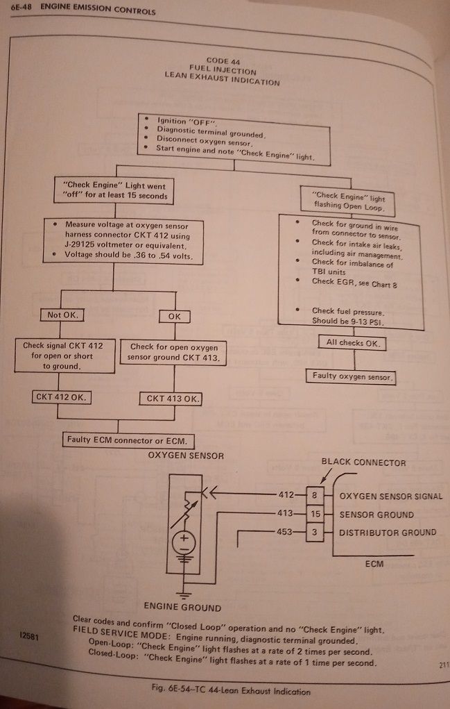

I don't know what GM Service Manual you are looking at, but the 82 corvette does NOT have a MAF sensor. So, I'm also assuming that you are using something other than the GM manual. STOP using it if you are. Instead, look at page 6E-48 in the GM service manual for the 82 corvette and follow the troubleshooting chart for a CODE 44 lean condition.

You're right, should've noticed that when I was looking up the manuals, the 82 has a MAP sensor not MAF. I really should invest in a physical copy of the manuals. Anyways, I found this on C3VR. Should I start with this?

Yes... That would be a good place to start. You would do better to procure a hard copy off of eBay. They are available and if you can get the color diagram version which is the original manual, the better. Makes it easier to follow IMO.
