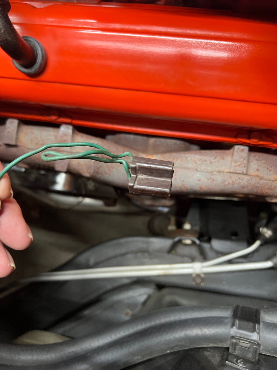

1971 coupe Found this plug on the right hand side fender well tucked down low thanks in advance.

automatic trans?
could be vacuum advance limiter solenoid wire plug.
right side=passenger?
I forget the "system" name but,
for smog the dist vacuum advance is limited until car is in 3rd gear.
A smog device/s system.

4 speed trans

OK, I think they had it also.
Trace the vacuum line from distributor and see where it goes.
By now I suspect that power robbing smog system has been removed.

It plugs into a temperature sending unit on the cylinder head between the 2 rear spark plugs there is a round hole in the chrome spark plug shield it goes in there, It is for the transmission controlled spark solenoid

Plugs into the two spade Temp sender part of CEC its located in the RH head
check this link and particularly our friend ALAN 71
https://www.corvetteforum.com/forums...-question.html

thank you seems to run good with out it plugged in I will just leave it disconnected.

yes, trans control spark system
TCS
