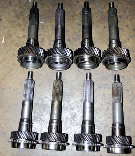

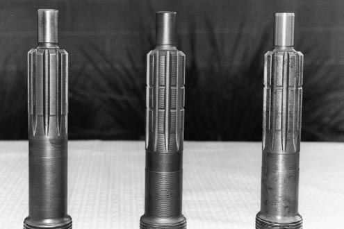

Originally Posted by sleepchamber
26 splines on the shaft.
I think I should have been more specific. The grooves or rings go around the input shaft. The number of rings will identify the 1st gear ratio of the tranny. There are many for a ST10.
A little hard to see in this pic, but there are grooves on these input shafts
Easier to see the grooves here on a 10 spline Muncie. None, one or two. No grooves is a M22, one groove a M21, and two grooves a M20

i always thought 0. 1 or 2 was m20, m21, m22 in that order with number of grooves matching last number...
Sorry, three grooves

No problem. 3 groove, from info I have, would be a 2.64 first gear. So essentially very close to the M20 wide ratio Muncie. Regardless, the BW ST10 is very good tranny. Ratios for 3 groove from 1st to 4th: 2.64; 1.75; 1.34; 1.00.
