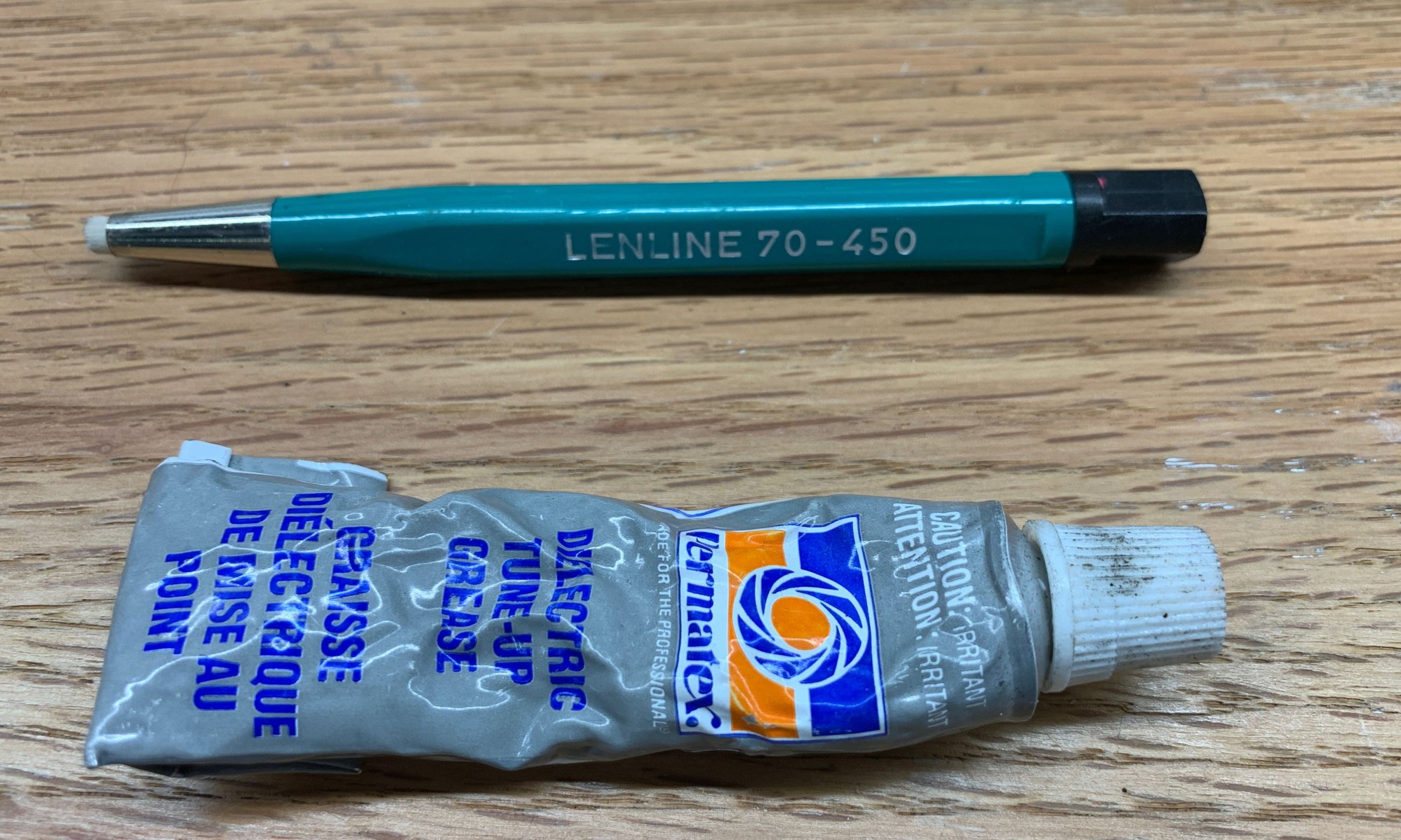

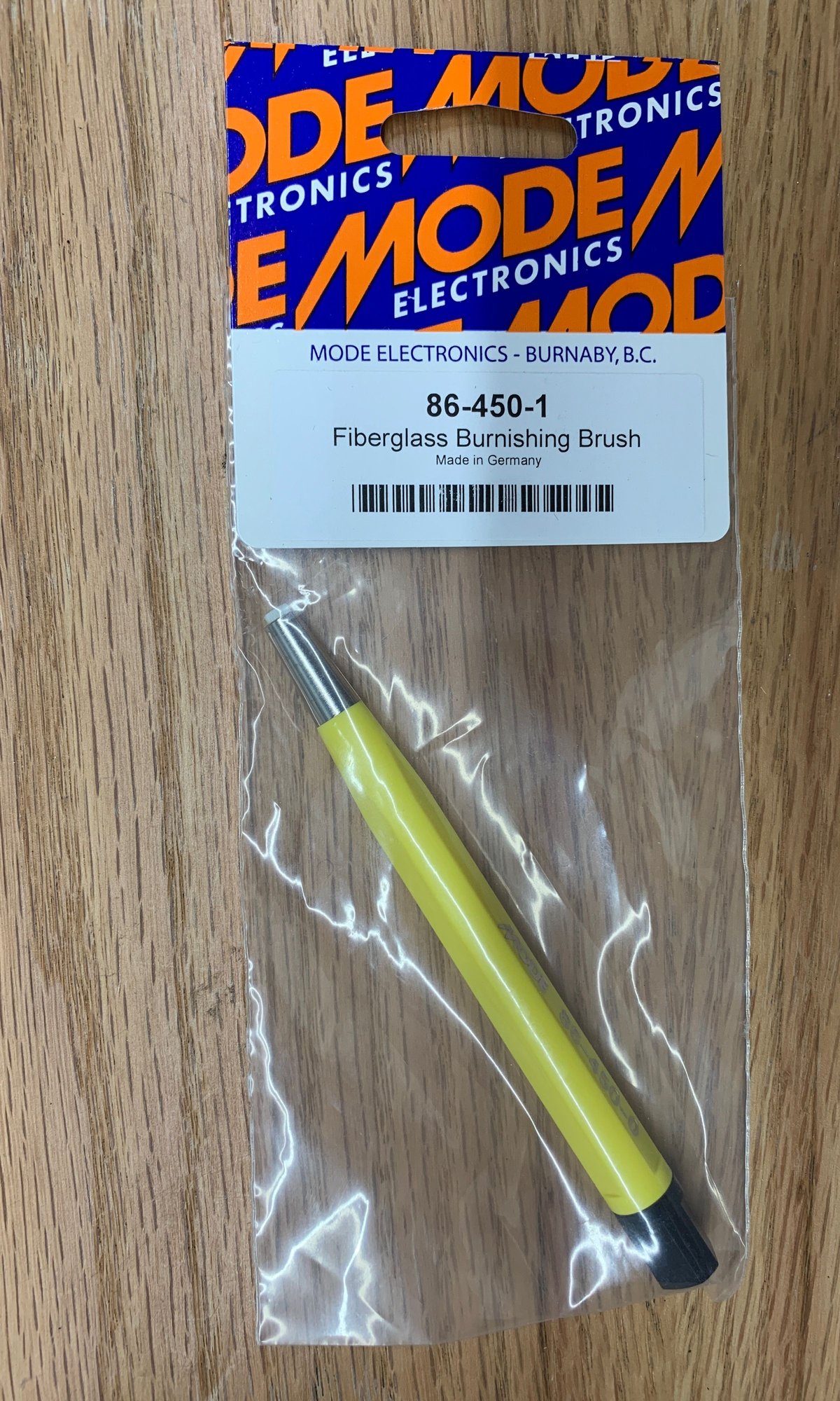

Fiberglass Burnishing Brush and some dielectic grease.
Been cleaning electronic and electrical contacts for many years with a Fiberglass Burnishing Brush. Does a good job at cleaning contacts that batteries leaked on as well. It has a million uses.
cheers,
Richard
