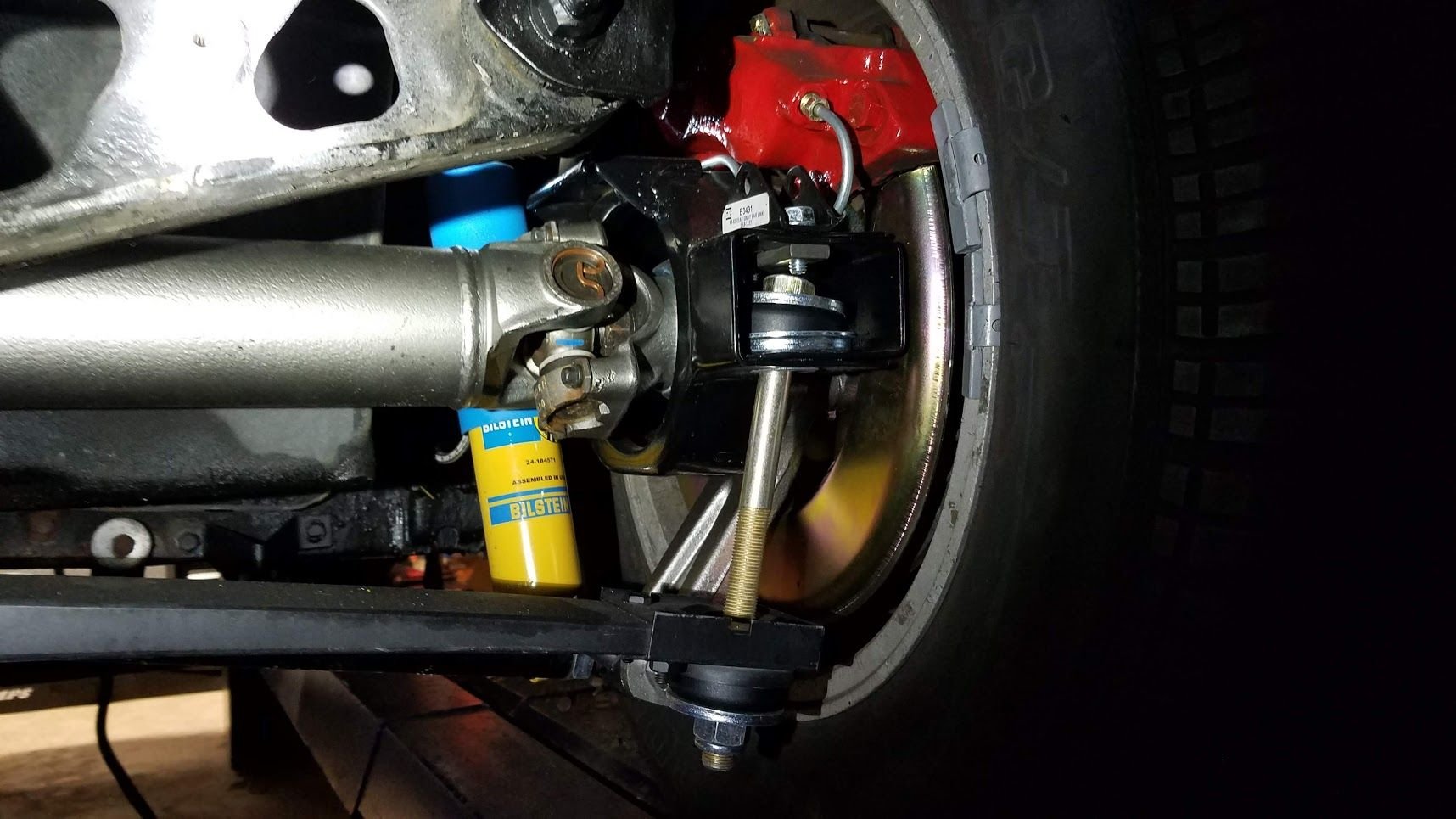

If you choose to DIY, you can buy the poly bushings from Energy Suspension. 3.2104G (black) or 3.2104R (red)
OOS at Amazon, but in stock at Summit
https://www.summitracing.com/parts/ens-3-2104g
https://www.summitracing.com/parts/ens-3-2104r
Here are the black ones, with 8" bolts (only 7 used), and level half-shafts thanks to a VB&P spring. The poly bushings leave room for the stock sway bar mount. There's nothing special about that Grade 8 bolt and Nylock nut. You could drill a hole for safety wire/cotter pin if you are concerned. Yes, I regret not getting the red ones.
