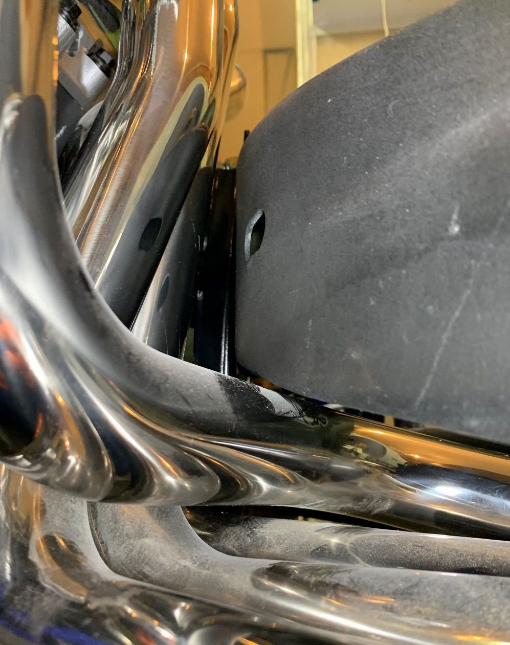

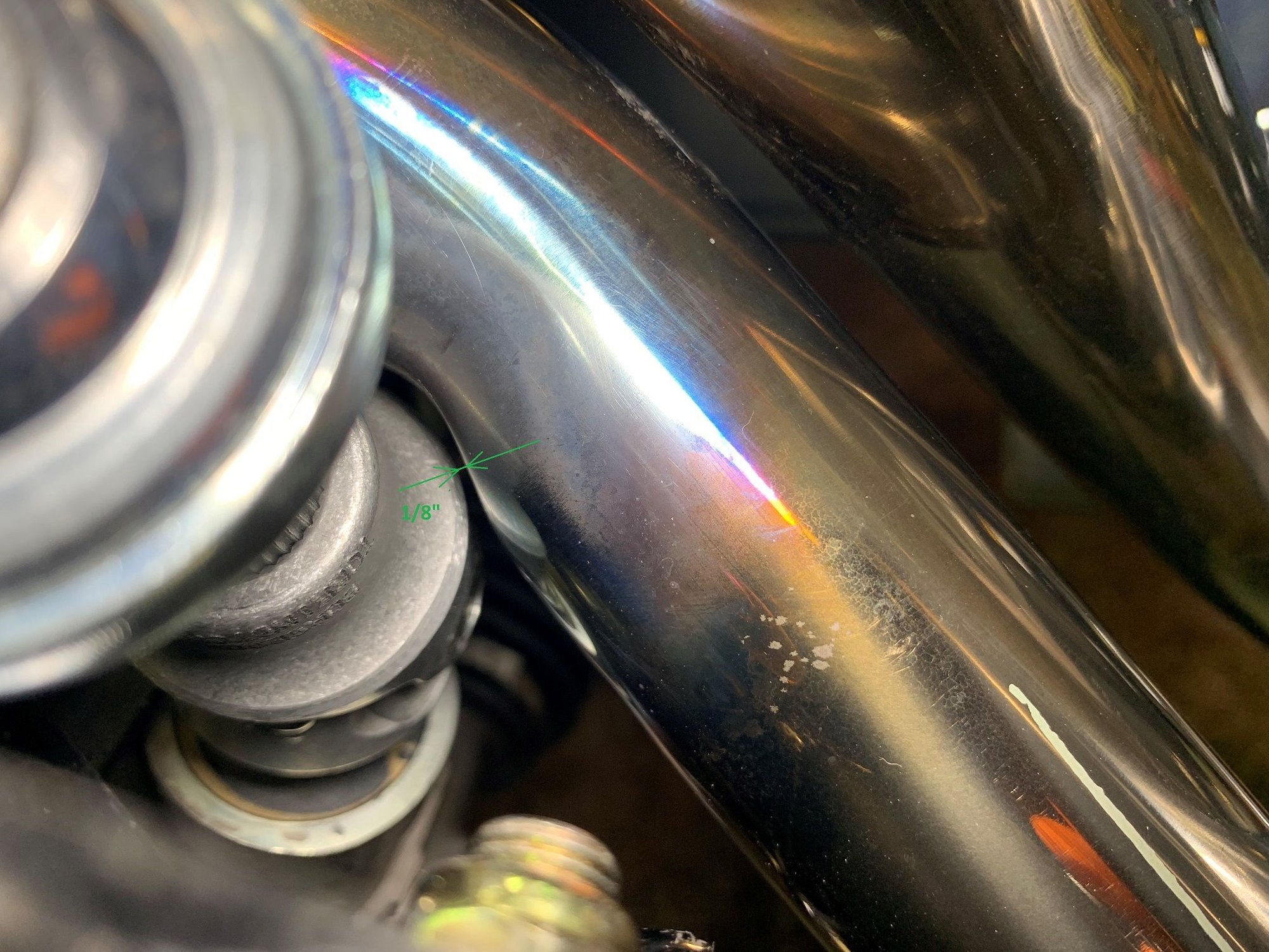

Hey folks, question: how much header clearance is needed in my situation?
I have a Dart 400ci SBC, polyurethane engine mounts, the steeroids rack and pinion and Doug's 1 7/8" stainless steel side pipe headers. There was interference between the header and steering u-joint at the red circle level:
I reluctantly dimpled the header:
And ended with about 1/8" of clearance:
The interference was about at the same elevation as the polyurethane engine mounts. So the driver side bushing would have to compress quite a bit to cause a contact.
Am I OK as it is or do I need to butcher the header even more?
Thanks! -Regis

Drivers side engine mount only compresses on deceleration with the motor. Would have to be real aggressive with a manual to get that. With an auto I don't even think you could do it.
Misses by an inch, misses by a mile. Those SS (look chrome coated) headers are going to VERY HOT for sure. A fair amount of heat transfer will take place there. If they were ceramic coated it'd be whole lot better for everything under the hood.

Thanks REELAV8R - all good info to know. It is a manual gearbox, but I'm not aggressive :-) I guess it'll be fine on the driver side then. I am still grinding a steeroids bracket on the passenger side for clearancing of the header.

Engine Masters did a segment on how much they could dimple a set of headers before it would cause any performance changes during their dyno runs.
They totally mangled a set of headers and saw no performance loss during their dyno tests.
It is an amazing video to watch if you can find it.
If you are at all worried about engine movement and contact with the headers at the steering joint, then swap out the poly engine mounts for a set of Moroso solid mounts.
Nothing moves and you’ll have no vibrations.
You might even gain some needed clearance.

Agree on the above dimpling and performance. It was surpising. I would give it a little more clearance while you are in there. Best to do it now while they are out. I would say 1/8" is a little close. You could also then use some header wrap afterwards to insulate it some. DEI makes some good stuff. Just do a small section.

On the driver side, I did a little more banging and I now have a bit more than 1/8" clearance around the steering U-joint. I have like 1/4" clearance where the pipes go underneath the chassis. I think that's all good.
