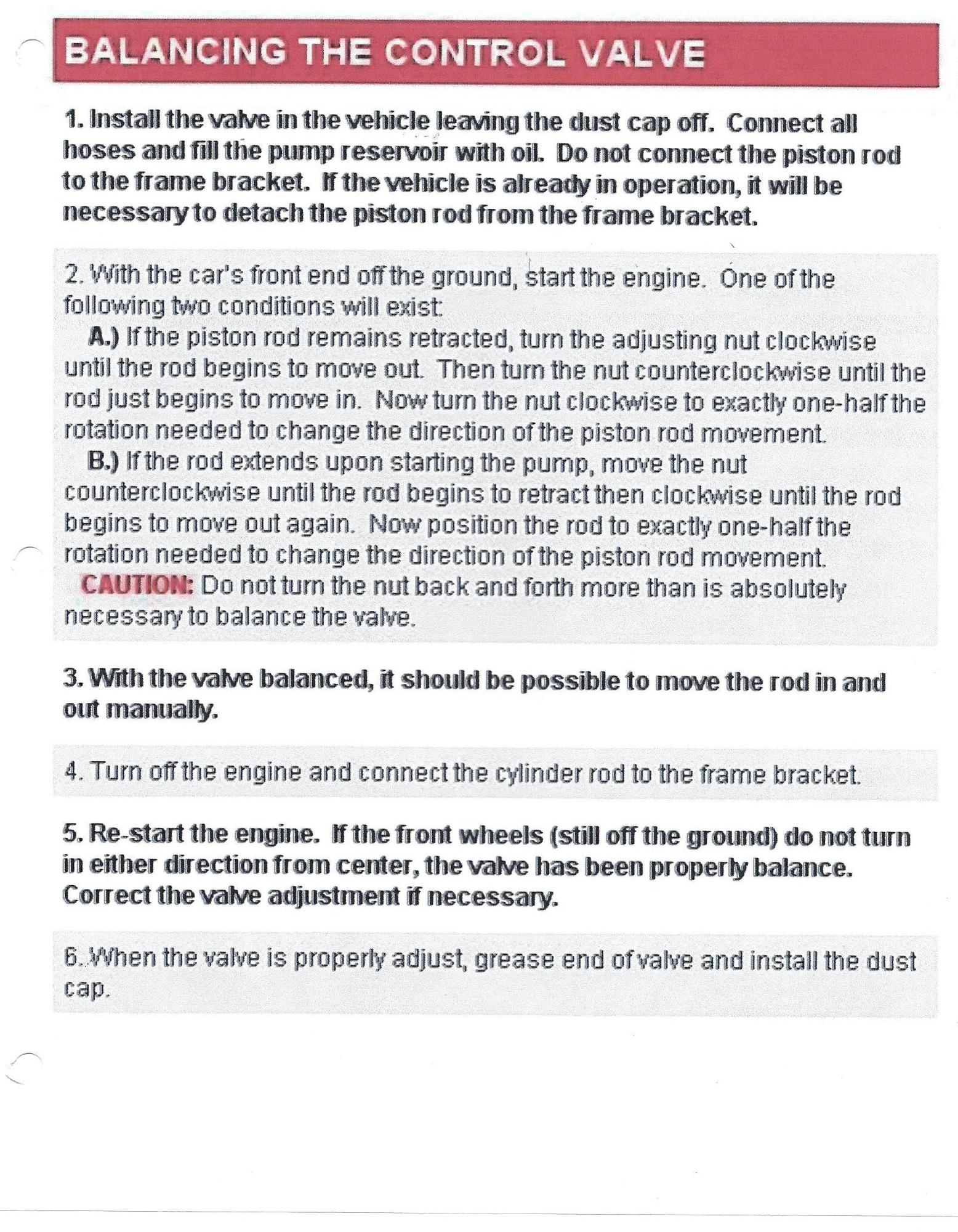

Do you have power steering?
If yes then see if the power steering control valve is balanced.
Do NOT pump any grease into the zerk fitting.
Quick question why should you not do that because I definitely did
Because too much grease can burst the seal.

If it has a zerk fitting it gets grease, including the P/S control valve. The problem is most people tend to over grease things. One pump in each zerk is all that's needed.

Most of the decent alignment techs should know about the balancing the control valve. Yes many cars today have a rack and pinion versus the old recirculating ball systems but they are by no means obsolete. The car should not be pulling to one side or the other but Corvettes tend to intimidate some clowns who work at aligning cars using a machine that tells them everything.
A weak power steering pump would not make one side pull like you described. It would squeal when you turn the wheels when going slow and such. It wouldn't help you as much as it should but not be making one side pulling more than the other.

Anyway check the PS control valve centering first. You said a new one was installed. That does not mean they centered it. Jack the front end up off the ground, start the car, and see if the wheels move right.

two things,
what are the facts about the statement I have highlited?
Rebuilding the power ram and ball assembly is tricky.
Shaft seals, rubber mounting ram specs and a good ball.
I had the same issue, centering/adjusting the ball did nothing.
Only a full rebuild of the ram system fixed the issue.
I can't understand the "3/4" difference issue unless something is bent?

then I vote for complete ram, valve, and bushing work to steering system.
