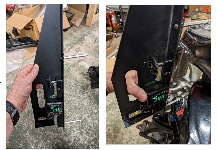

If someone wants to read their caster directly this is how I did mine. I measured it (the rearward tilt) directly at the grease fittings for the two ball joints.
For a DYI person, the most important thing is that the two sides are the same, or you will get a pull like the OP did.

Glad you got things going in the right direction. DIY Alignment measurement for C3 is a good skill to have. I track my car and check alignment after every track day.
Here is what I have used for years. Quick and repeatable results. I compared my results to a Chev dealership alignment rack to verify the methods.
My DIY Alignment method - CorvetteForum - Chevrolet Corvette Forum Discussion
