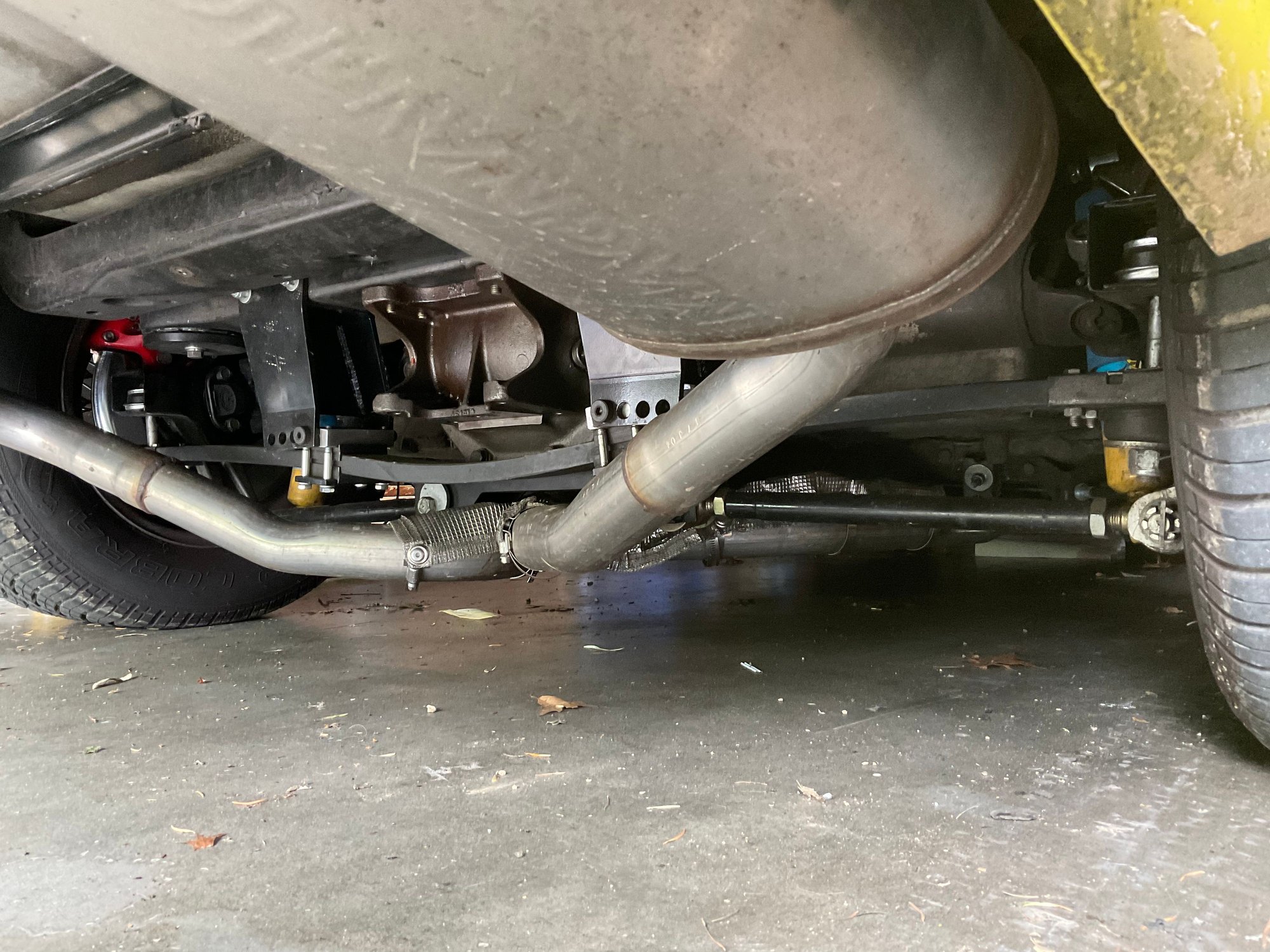

Purchased a project car several years ago. Came with the VBP dual mount set up and spring. Installed both, but now seeing pics that don’t look right.
Spring I mounted says “RDM” and also “331 – K=280.” Maybe RDM means rear dual mount?
The problem is every pic I see of other dual mount set ups has a flatter, thinner spring between the mounts and thicker ends. My spring is rounded and thicker in the middle, and thinner on the sides. Worried if the mounted spring from the PO was designed for center mount, would there be problems in ride and/or strength, especially at the ends.
This first picture is my setup. When on ground, the spring is flat between the mounts and bends upward on the sides.

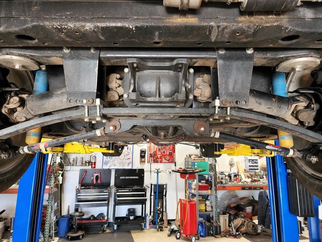

Here are a few pictures found online of the same system. Definitely a flatter (even concave) and thinner section between the mounts, and much thicker at the sides.
Another.

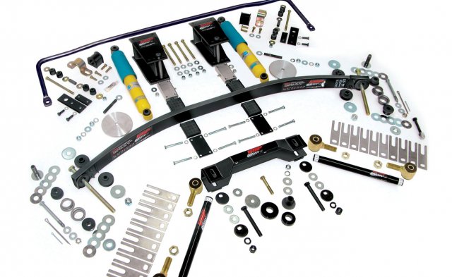

Here is a pic of the kit..
Should I be worried about this setup?

Thanks for the comments everyone, but mystery solved.
Just spoke to Dan at Vansteel and he confirmed that RDM does mean "rear dual mount." So, even though my spring looks different than the other pics, and is very thin (5/16") at the trailing arm bolts, I don't have to worry about losing it on the freeway because the previous owner messed up his order.

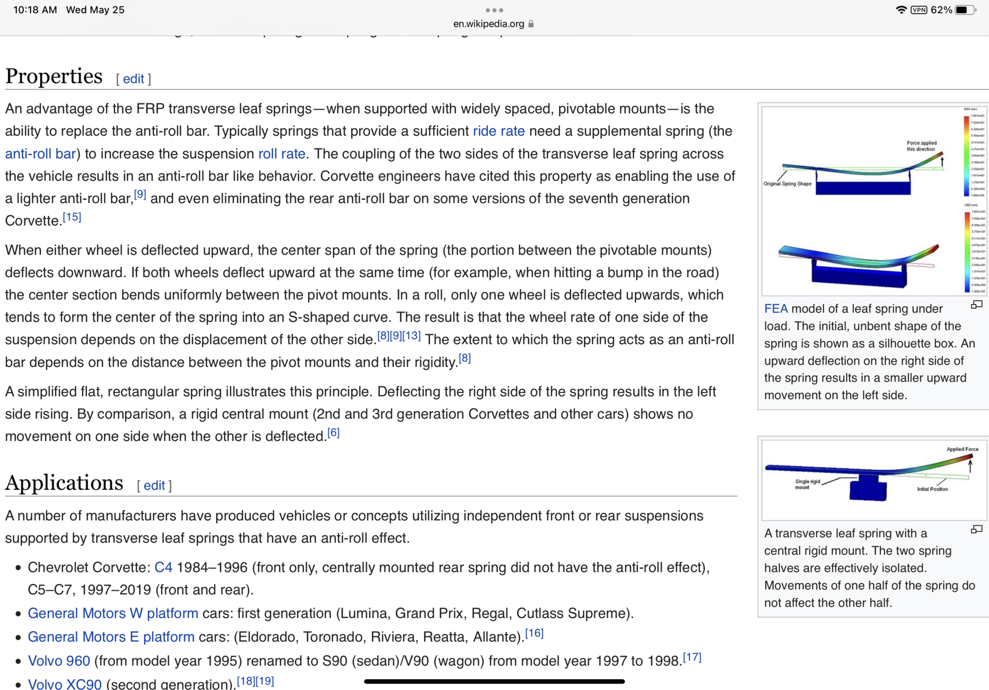

Good to hear. Dual mount does give you better handling and doesn’t affect the duty cycle of the spring. Later generations of Corvettes went with dual mount. Here’s a wiki I found that you might find interesting.

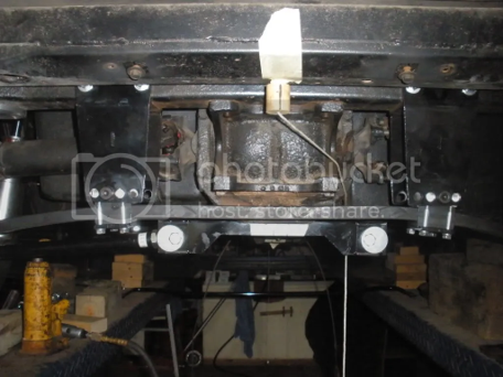

This is an older install of a VBP rear spring on my 69, I installed it about 20 or so years ago - certainly not as clean and shiny as yours! I guess my car is more like that cheerleader from high school, pretty on the outside but kind of a mess underneath? These photos show the missing spring clamp cushions on the passenger's side.
I don't have any photos of the spring with the weight of the car on it (sitting on the ground), I will see if I can go grab one.
Call VanSteel, they have the rights (I believe) to the old VBP stuff and helped me out with a few missing bushings (flat cushions) which turned out to be pretty important.

I would love to test drive this spring. It seems that it would corner very well. As the car corners the opposite side wheel squats a bid which would lower the rear and keep the car flat, when cornering. Cool.
