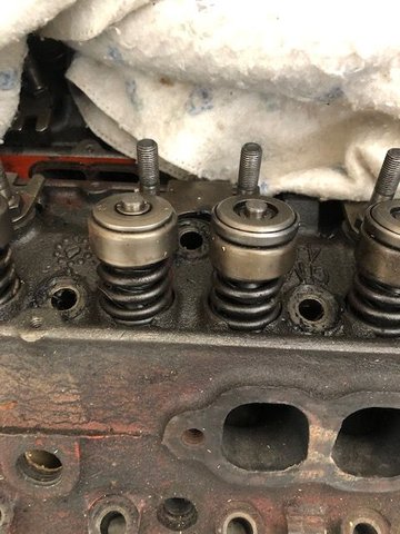

The factory O-ring seals work with factory style 2-groove valve stems so you need those to start. You also would need those HEAVY factory valve retainers and the factory metal umbrella shields. If don't have all 3 of those items, the original O-rings will not seal anything.
If I'm understanding the above I should use the OEM valve retainers that are on the 330545 heads vice what's currently on the WP head.
330545 L82 Head
WP Head Installed on Engine
330545 L82 Head
The factory retainers are long enough to reach the second groove on the valve stems where the O-ring rides. Aftermarket valves rarely have second groove to accept the O-ring and aftermarket retainers are too short to reach the O-rings if you did run a 2-groove valve.
What it boils down to is that you can run ALL the factory stuff OR go with the aftermarket setups. You seem to be leaning to reinstall the stock heads. The factory style O-rings, 2-groove valves, and steel umbrellas will get the job done for you.
That said, NOBODY does that anymore so you might get pushback from others. Most car guys are running positive style aftermarket seals and lightweight retainers without the metal umbrella shields. Your machinist might also try to steer you that way. It is perfectly fine to go either way. Both will get the job done and keep the hood closed.
The valves in the WP heads have 2-grooves but I hadn't thought about the aftermarket retainers being too short to reach the o-ring, thanks for pointing that out.
My goal during this cam swap was to keep the WP heads on the car as there is nothing really wrong with them (I'm assuming). The engine smokes on startup and less after running for a few minutes but still some smoke out both sides. Compression and Leak down tests are good so I'm thinking a combination of valve seals and leaking intake gasket causing this.
I don't want this to turn into an engine pull unless it has to, if I go any deeper I might as well just pull the engine.
If you do keep the WP heads, pop off a retainer to see what they used for seals. I would probably just replace them with the same.

Sting, the WP heads only used the black nitrile umbrella seal.
Derek, yes I will check the valve guides as I replace the springs and seals.
