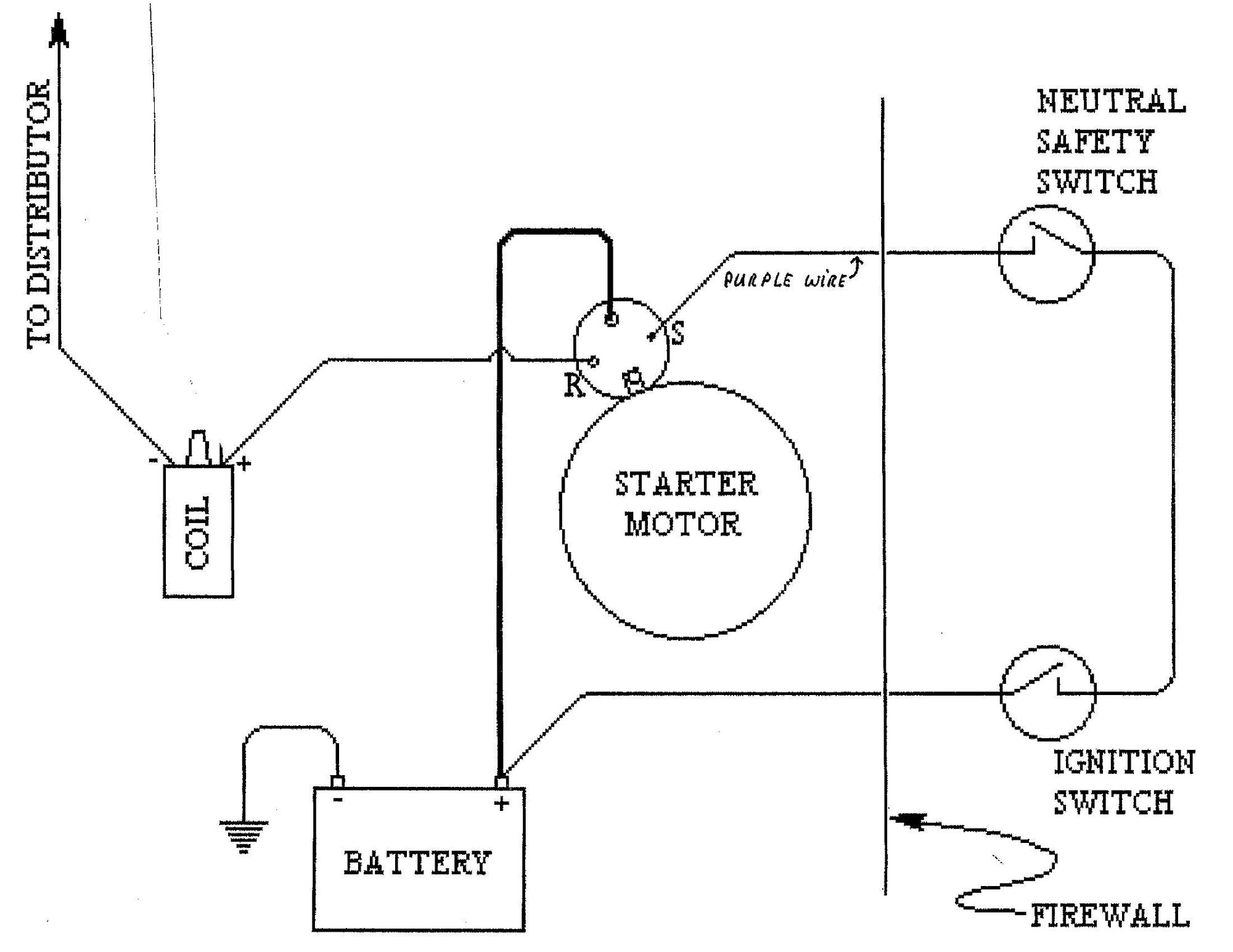

Have you checked the Neutral Safety Switch?
Basic starter wireing:

1975, stick. Thanks for responding. I have located the clutch NS switch with purple & white wires, but I did not check continuity as all looked well. I'm in the middle of restoration so my entire dash has been removed. I suspect my big foot has pulled a wire off while using the clutch. There is a orange wire (it looks like it was taped to a white wire from the factory) with a bare end that shows continuity when the switch is turned to the start position. I think I should invest in a good, color wiring diagram. The orange (and white wire) comes from the largest part of the wiring loom and turns toward the cabin/instrument panel. Does any of this help?
