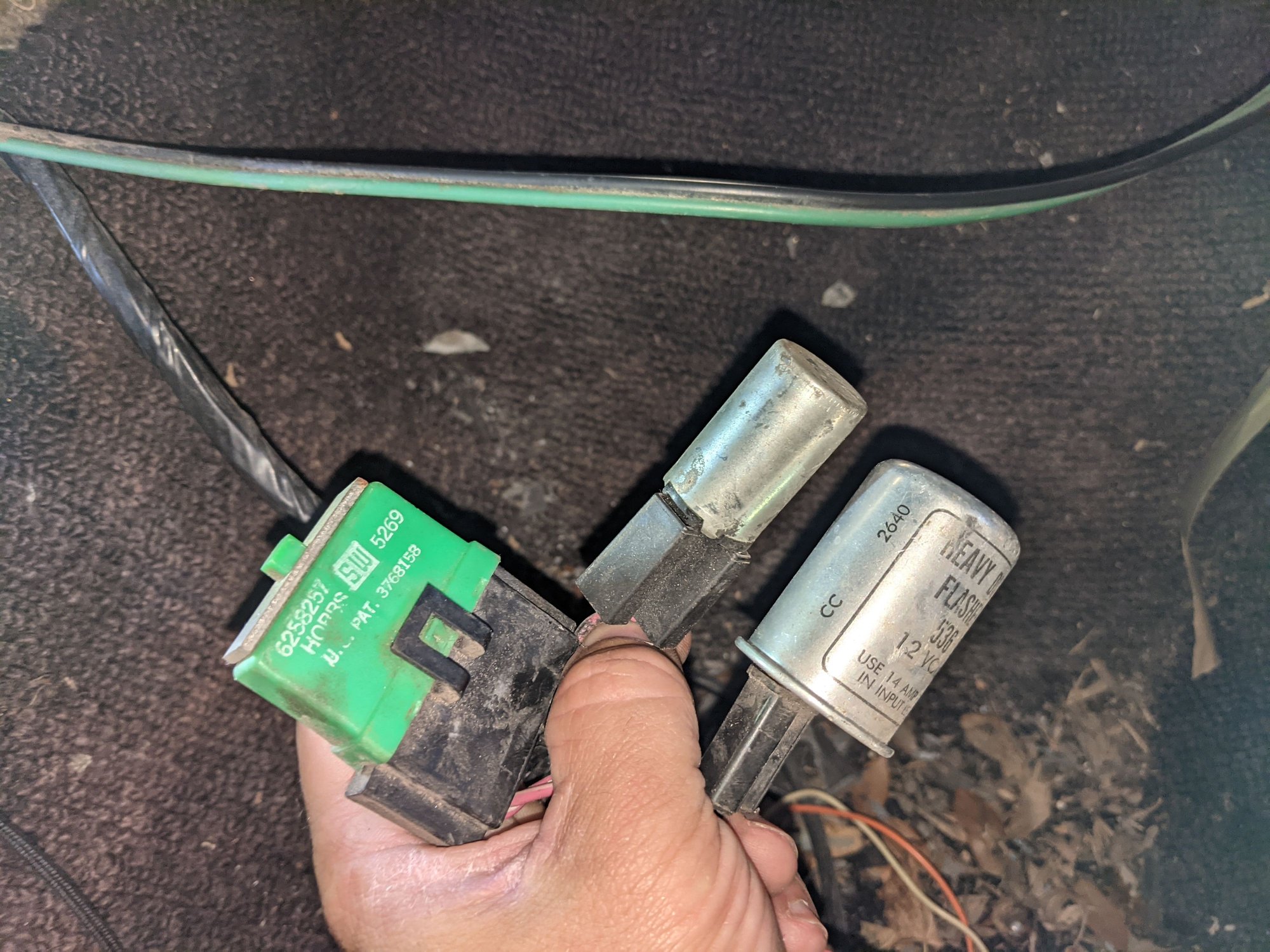

The big cylinder is the turn signal flasher, the green guy is the headlight buzzer, but what is the small cylinder?

Yes 76, 2x pink and a black. I double checked the pinks, they are both just plain pink (no pink with a stripe.) Pink is the key-on 12v that all kinds of stuff is connected to and I assume black is a ground, but I don't know what this is and I could not find it on the wiring diagram I have. All the cylinder says is "Made in USA."

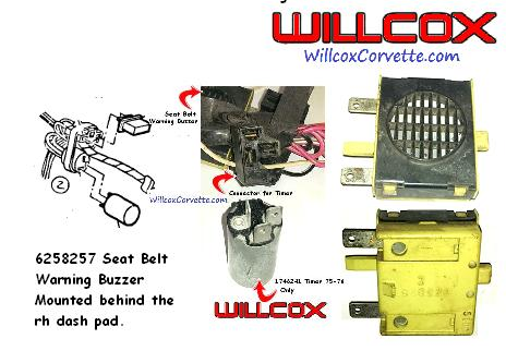

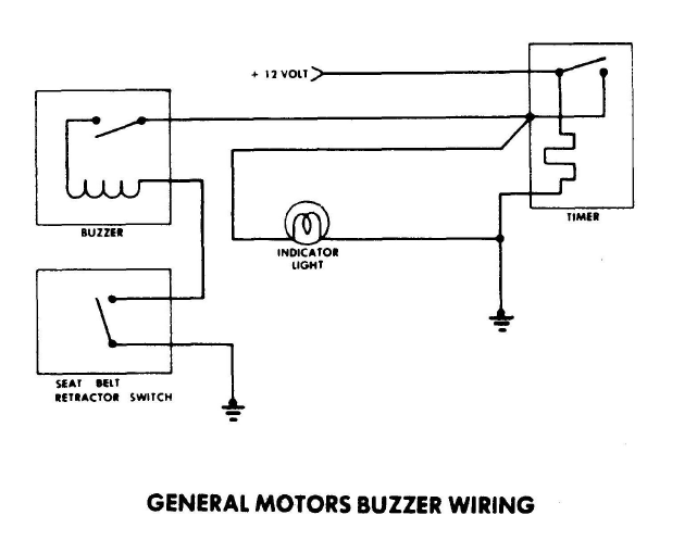

Not a courtesy light timer, but you made me think in the right direction. A 76 has no push button on the dash for the seat belts like an earlier C3 has - it's the "Fasten Seat Belts" light timer.
