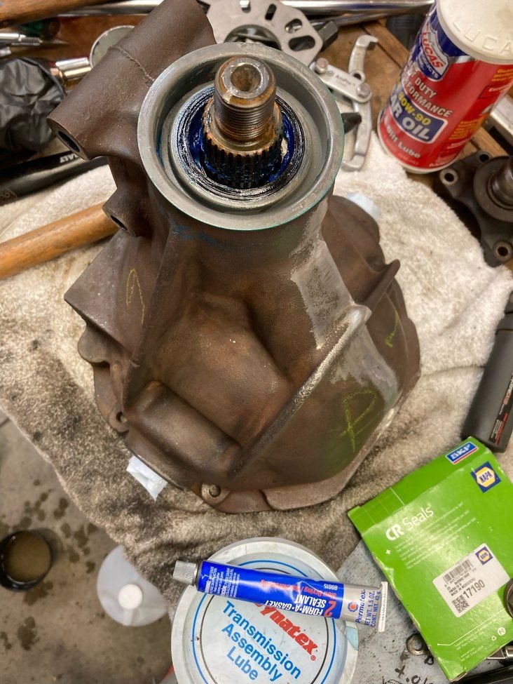

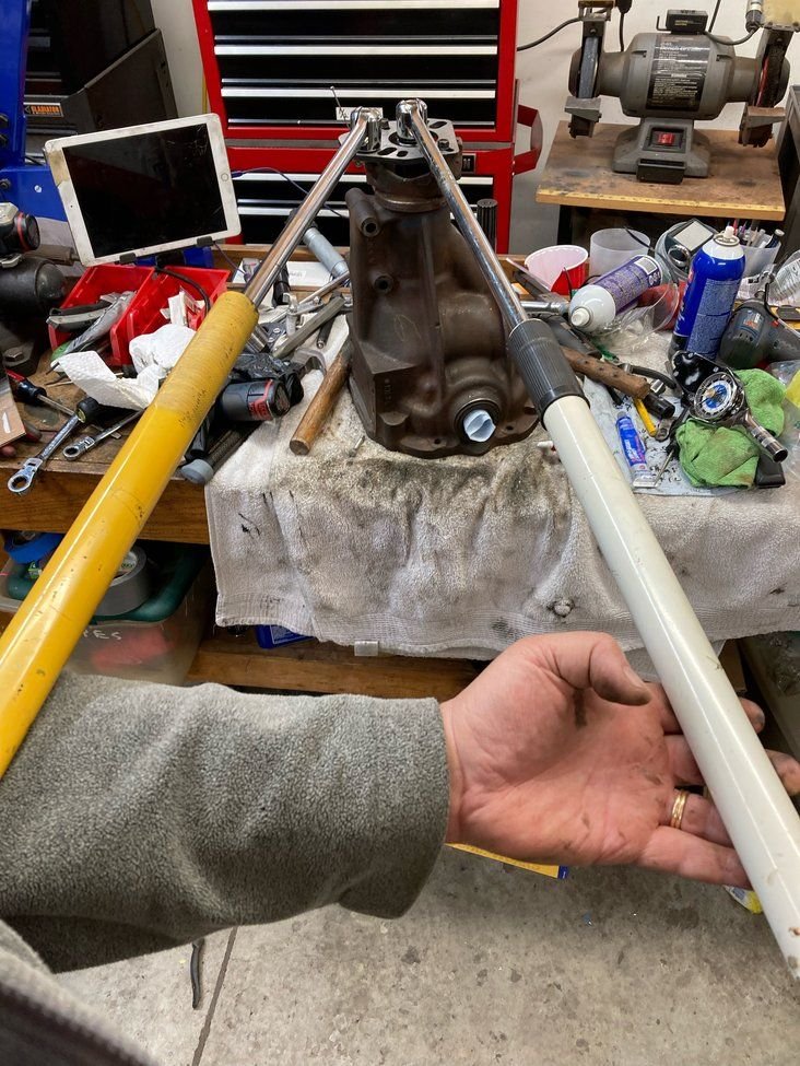

I didn't need anything like your bars to tighnen the nut to the original position. Did you replace anything other than the seal. I am guess if you have a new crush sleave then those torques are required. I am guessing as the torque required but I placed a bar through the have shaft end
to prevent the diff from moving and used my 1/2 deep socket until I hit the marks. Compared the effort to turn the diff yoke by hand. This diff has 210k km (130k miles). Still the org factory diff the car came with. Other than side yokes still factory original.
Picture before.
picture after.
