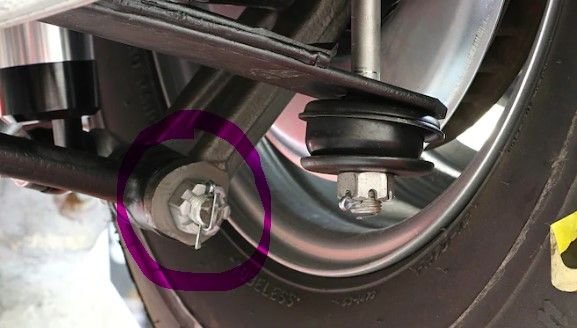

OK, this one is! My point is more that they BOTH use a cotter pin locked castle nut which negates the nuts loosening. Also the rod is captured in the yoke with the shock mount.
The shock mount is also knurled to bite into the yoke so it also does not move thereby also keeping the strut rod in pace even of the cotter pin and castle nut backed fully off.
The nuts on the rod come loose not the shock mount

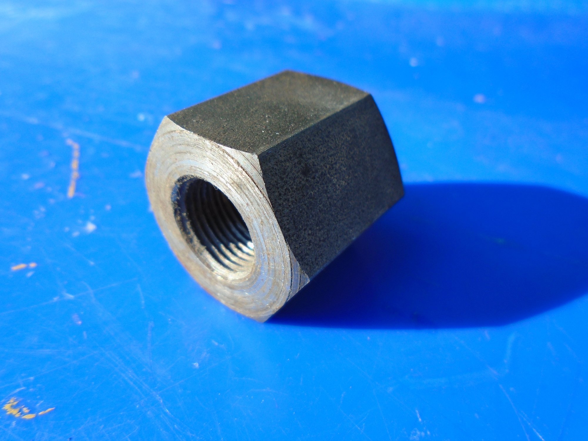

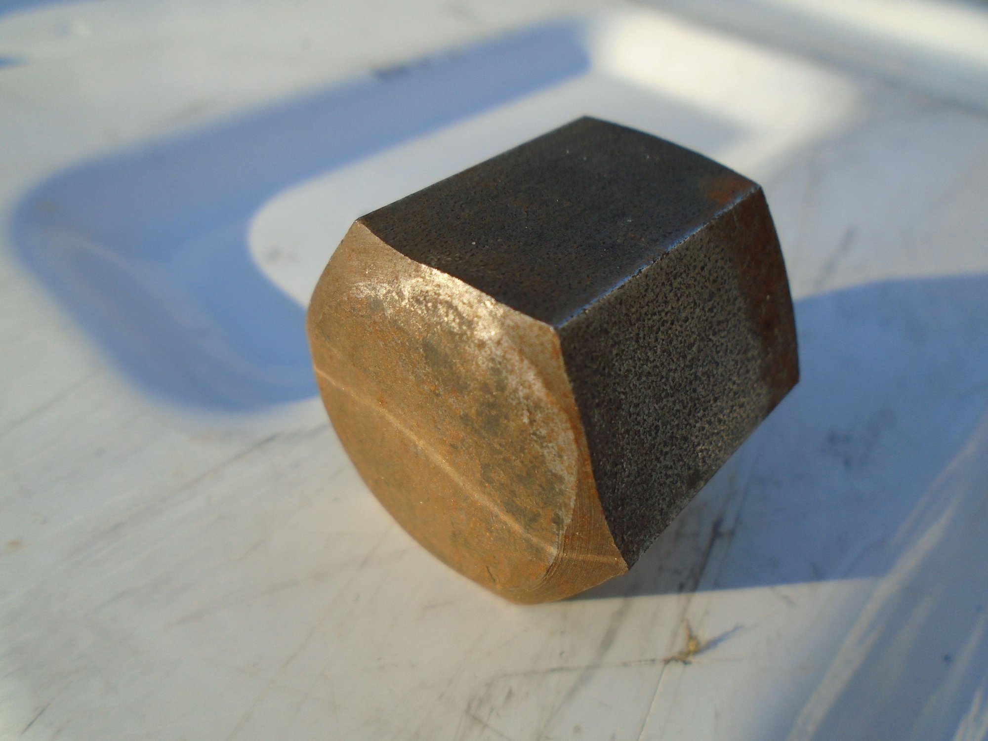

Shock mount removal tool
To Strut Rods
