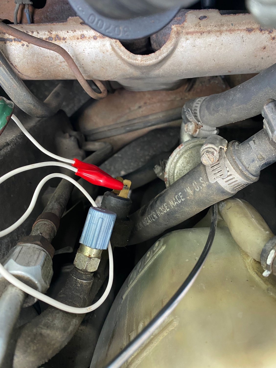

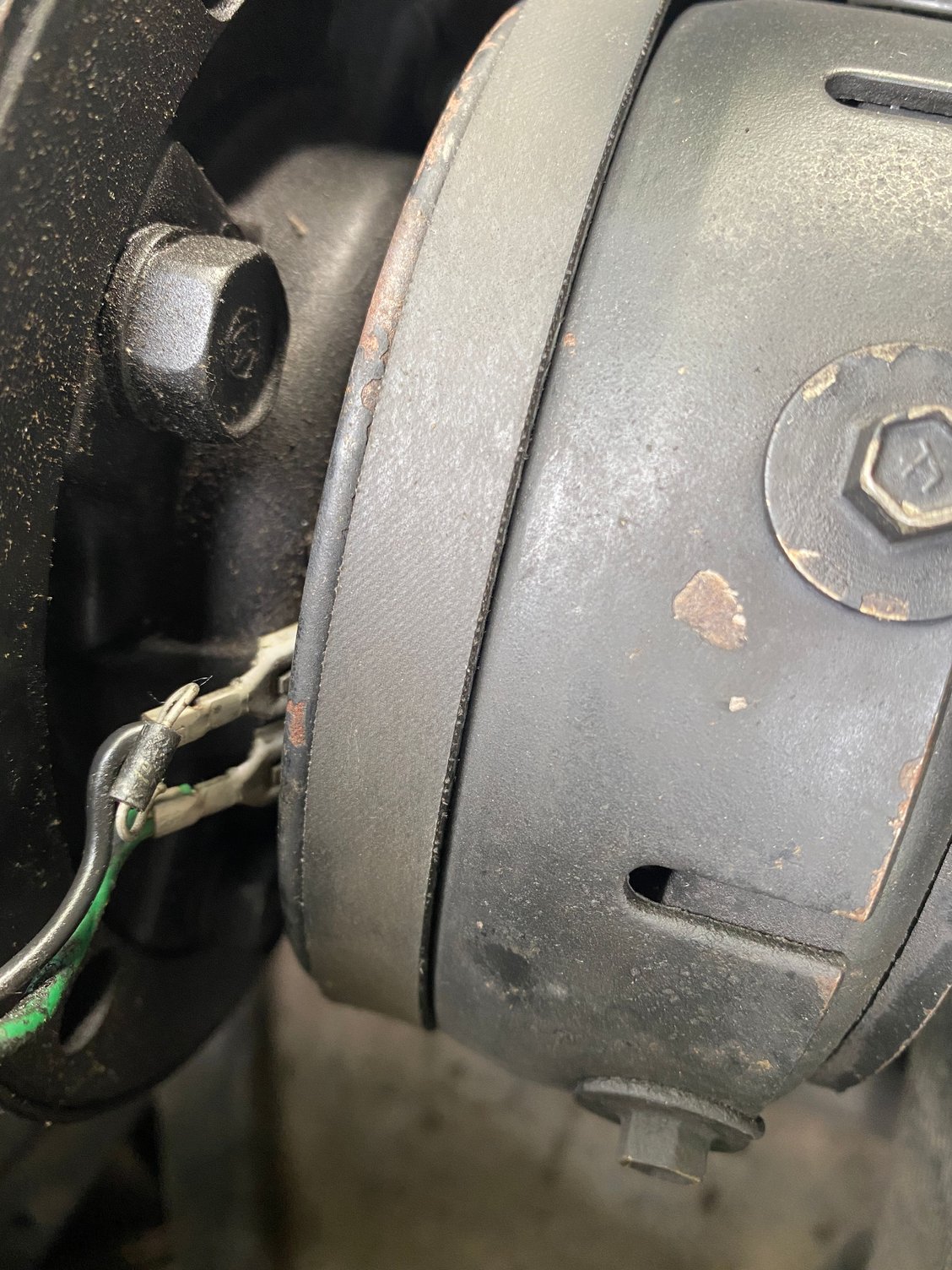

My '81 was converted to R134a over a decade ago. I rarely use A/C, but upon trying to use it for the first time in at least a year, it only blows hot air. I noticed that the compressor clutch wasn't engaging. I took off the connector on the compressor, and I am not getting 12v at the connector. Also, there's a switch further down the fender, across from the exhaust manifold, that I believe is the pressure switch. No voltage there either. I read that I can jump the terminals, which I tried, and still nothing. If it's a refrigerant leak, is there no safe way to engage the clutch just to see if it works? Could I use a bench-top 12v power supply and apply power to the compressor terminals safely? Any other suggestions? Thanks!

By putting the jumper wires across the switch like you did is like trying to turn on a light bulb without power. lol
One of the green wires at the 2 wire rubber boot connector should have 12vdc with A/C on.
If the pressure switch is satisfied it WILL pass voltage through the switch to the compressor clutch through the other green wire.
For testing only, jumper the 2 green wires at the 2 wire rubber connector with A/C ON and the clutch should engage.

Okay, I got a chance to properly jump the terminals, and the clutch did indeed come to life. So low refrigerant must be the issue. Thanks all!
