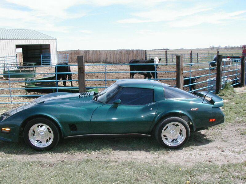

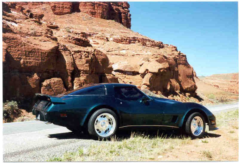

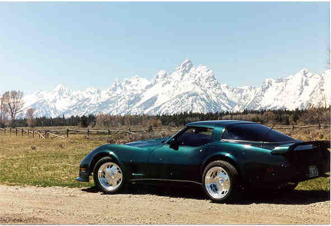

You should just measure the back spacing and you want to end up with 4.0 - 4.5 inches in front with the spacer width and 4,5 - 5 inches rear.
Actually the 255/45/17 is a good width for the front, but 9.5 inch can use up to 275/40/17 width They are both small 26.1 and 25.7 diameter and I use them on my 79 with correct wheels on the front of my 79.
This is a picture when I was trying 255/50/17 and 315/35/17 rears
These are 255/45/17 and 285/40/17 rears

Thanks for the information about the back spacing, that will give me something to work with.
The gaps on your car look the nuts by the way
