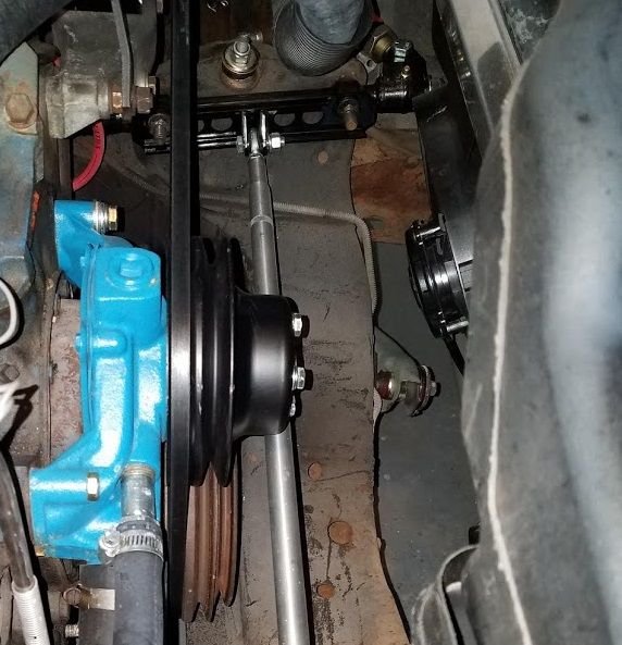

Bonus photo of my 80. The fans ONLY turn on when the car is stopped and idling for a few minutes.
