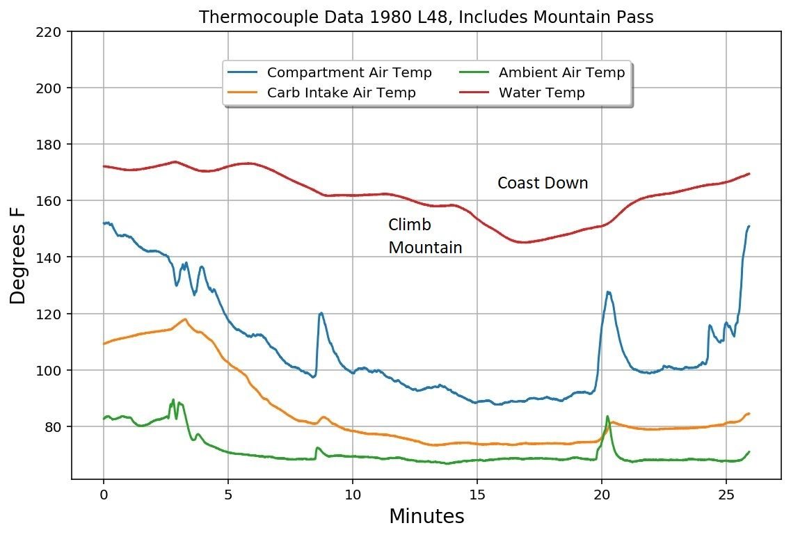

The free HP is nice. If you have 1240 RWHP, you might not notice the difference. But with only 240 HP (or less), every bit helps.
But I didn't go to electric fans for the free HP. Look at how much room there is without the stock fan shroud and (always spinning) clutch fan (post #3). That alone is worth it to me. Even if you count the alternator, the whole project cost less than $400-, and since I enjoy doing electrical stuff, it was money well spent. That alternator will cover future mods, so I don't mind.
To answer @CorvettePassion's question:
Selectable cooling: Depending on your fan controller (or your ability to program an Arduino, or however you want to solve the problem), you can have the fans come on as needed, or with the AC, or on demand manually, or stay on for a period of time after you shut down the car.
The tremendous space savings (as mentioned).
Due to the orientation of the C3 radiator, there is likely less airflow under the hood. I have a dual-snorkel CAI in both cars, so I don't care. My 80 (with electric fans, side pipes, and not much insulation) is cooler inside than my 79 (with the stock clutch fan, under the car exhaust, and lots of insulation). Both have the heater circuit bypassed/plugged, no A/C, and the same Lars-style tune.

I took the time to carefully write what I wrote, and I tried to declare all of the relevant variables. Each car is different, and the location of the exhaust seems to matter a lot more, at least between my two cars.
Your engine is not cooled by air flowing over it. It is cooled by water flowing through it.
I do have this data. During this particular run, the fans never came on. Ambient air was measured under the front bumper, compartment air was behind the air cleaner assembly, intake air inside the air cleaner above the carb. Again YMMV, but it seems that if you spend a lot of time in traffic, you'll need AC and an on-demand electric fans.

Yes,.....I know it is not an air cooled engine. And this is often confusing when people talk about electric fans versus clutch fans. You have TWO things.....one is engine temperature, which is dictated by many things, but radiator effectiveness being very important. Clearly....electric fans are better for engine cooling, but I also know that electric fans are often added when a new ALUMINUM radiator is installed. Two changes at the same time....with the fans being given the credit for the improvement, when in reality the new and better aluminum radiator could be a big part of the improvement over an old radiator.
But,...my question is more about engine compartment heat....NOT engine cooling. Engine compartment heat becomes heat back into the car and on us passengers. Much of that is mitigated by proper rear hood seal, foam horseshoe collar over the bell housing, good seals on all the heat box doors, etc. And then, the firewall needs to have no holes, and the insulation in good condition. All of those things that Chevy put in place when new need to be still functioning properly. In my 77, I used Lizardskin ceramic spray over the entire inside of the car, as well as Lowes Reflectix under the proper jute backed carpet. In my 77 there is ZERO,....and I mean ZERO heat from the engine compartment into the car. I can drive on 90 degree day in summer comfortably....and in reality my right foot is only inches away from the headers...NO HEAT ISSUES. And I do not have AC.....don't need it, don't want it.
I believe one reason for this is that I have airflow into and out of the engine compartment, out through the factory 77 side vents. So, again.......do electric fans, mounted at a down angle, that only run when engine is hot enough, going to ventilate the engine compartment like the factory fan shroud / mechanical fan......that is blowing air through the compartment, top down, all the time...even if it is hot air,.....its moving air.
I have read multiple posts on this, with lots of theories about what the airflow is actually doing....but every car setup makes it a different scenario. Modern cars are packed to the gills wth stuff.......ZERO airflow. You open the hood....its solid. My engine compartment is uncluttered, and open because I toss most of that stuff in the garbage.
Its just a question, and maybe my theory is wrong. My main reasons for NOT wanting electric fans has to do with my basic premise to stick with original on this car, plus modifying stuff is a rabbit hole....one thing leads to another. I am not really interested in electrical mods. Lastly....I hate the look. I WOULD like the open space around the front of the engine, especially when I have to work down there.....big block will only make it worse. But that is not enough of a reason. The BIGGEST reason I would go elecric fans is if I cannot figure out how to get a spreader bar installed......THAT is a mod worth doing.
