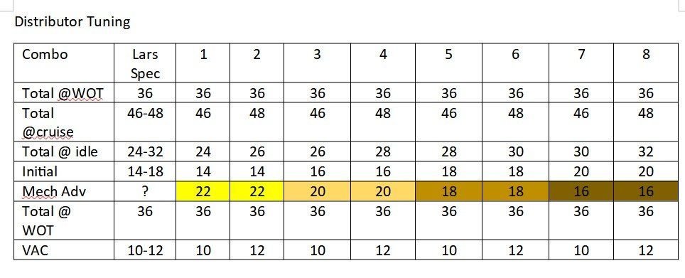

So just double checked and I now have too little mechanical advance... getting 28 at 900prm with 36 total.. looks like I need to fix that first. its possible one of the weights is sticking

Originally Posted by relivingthepast
There should not be any mechanical advance stating at idle. Probably need heavier springs on the mechanical advance. Then you can set the idle timing to around 10 degrees. The idle timing and mechanical advance needs to be set up first, and then you deal with vacuum advance.
Example : 10 degrees initial advance. Mechanical advance starts above idle rpm sloping to 30 degrees at 3000 rpm to 34 degrees total 4500 to 5000 rpm
Vacuum advance adds to mechanical advance for 45 to 50 degrees at cruise rpm
I get that but I have two issues there.
1. the engine will not idle at 10-12 degrees it idles very rough when I advance it to about 15 and starts to smooth out at about 20 degree
2 now that I changed the weights to the mr gasket weights, no matter what it seems, I lost some of my mechanical advance curve... I just tried different springs and I get about 24 degrees base timing with 35 max mechanial.
right now I have another vac advance can on the way as the adjustment on mine does not seem to have any effect on vac advance. I am idling at around 40 at about 900 rpm but to make matters worse my mechanical tach cable interferes with my oil pressure sender so I did not have it screwed in while turning the distributor the second time around as my whole dist is advanced a bit more now with the new weights..
I'm half inclined to just buy a different hei tuneup/curve kit.
weird thing it its behaving the same as before even with the changes... after it warms completely up the rpms go from 1100 to about 600-650 when in gear and the whole car jerks when shifting into gear due to having the rpm way up at 1100 to avoid stalling. drove around and it seems fine once in gear no strange noises.

Ok so ive been messing with the springs also put a slight dab of grease on the slides under the weights, I also went back to ported vacuum which allows me to shift into gear and back to park with much less increase/decrease in rpms and clunk. with the car idling at 900prm I am at 20 degrees this allows me 35 degrees of mechanical timing which all comes in before 3000 rpm. vacuum is 15 inches at 900rpm (with no vac advance) according to this chart i'm ok with 20 initial so I should be ok right? My numbers are somewhere between curve #7 and #8 currently. I did notice I have like a 1/16' or play in my distributor shaft from left to right almost as if my cam gear and distributor gear are not meshing tightly enough but the teeth on the gears both look of and I had initially adjusted the cam button for very little play. I imagine this could be effecting my initial readings slightly.

According to comp the stock 2000 rpm converter was fine. This was one of the reasons I went with the 270 and not the 276 HR cam. plus if I set the mechanical advance to 20 and put the dist on ported vac it shifts into gear fine. The issue there is there is too much advance at light cruise.
I did make headway. I discovered my adjustable vacuum advance is not stable between 15 and 17inhg and in fact does change when tested with a vacuum gun. Still waiting on the replacement I ordered last week.

no I tried different combinations of weights. it might have explained the stumble I was recently getting when accelerating though. that doesnt explain the main issue though which is a huge reduction in timing and rpms when going into gear. I am pretty confident this is a vacuum canister issue now.

the weights were the limiting factor not springs but if they are too stiff they do indeed limit advance.
