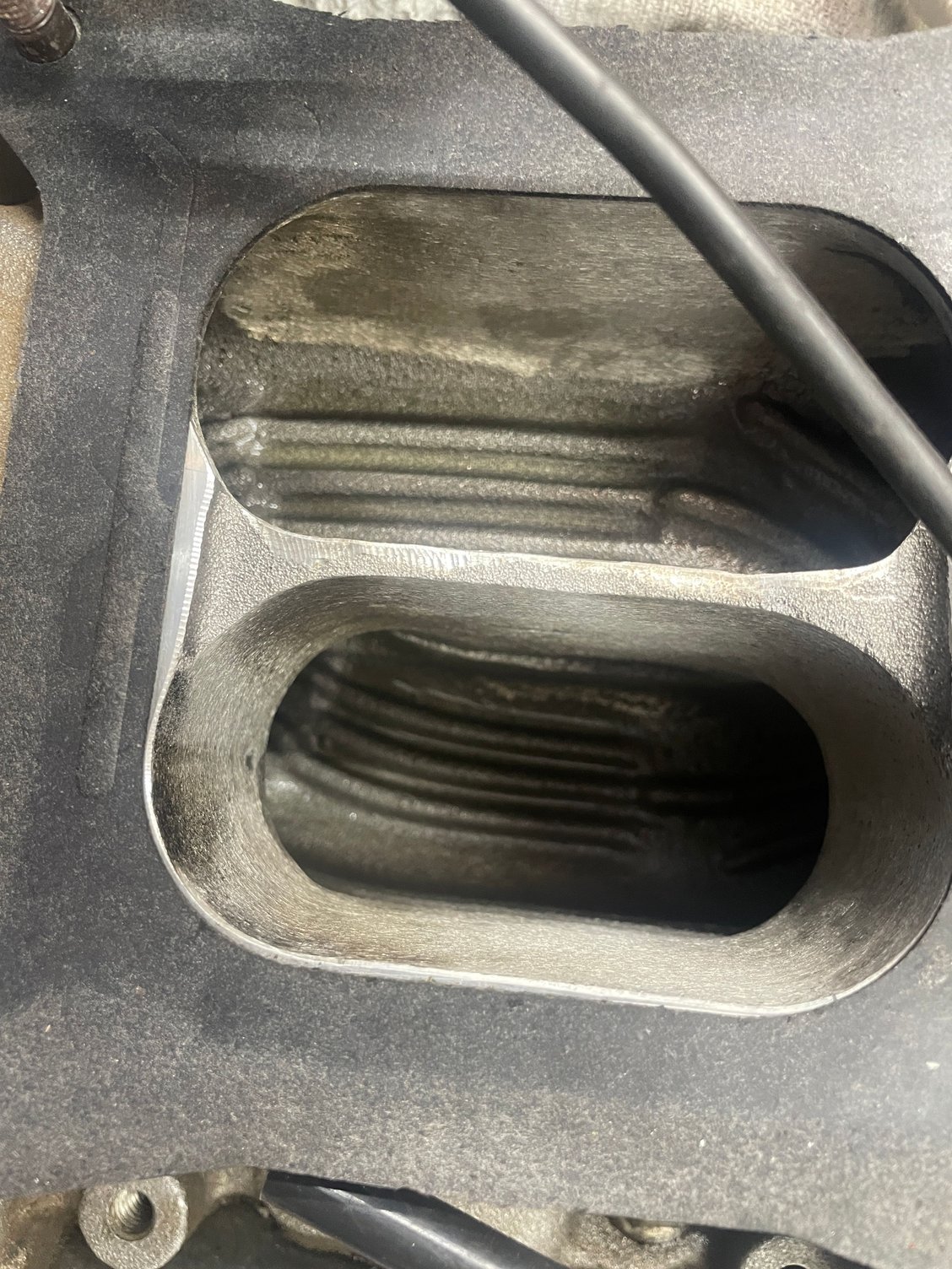

Port mis match?

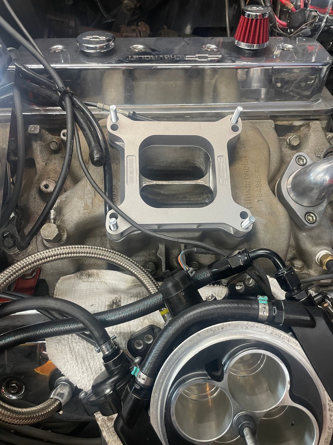

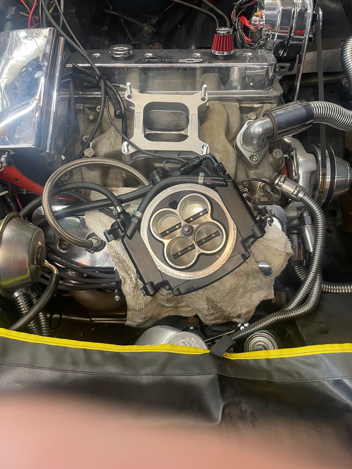

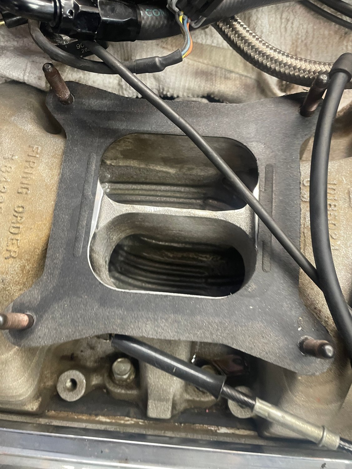

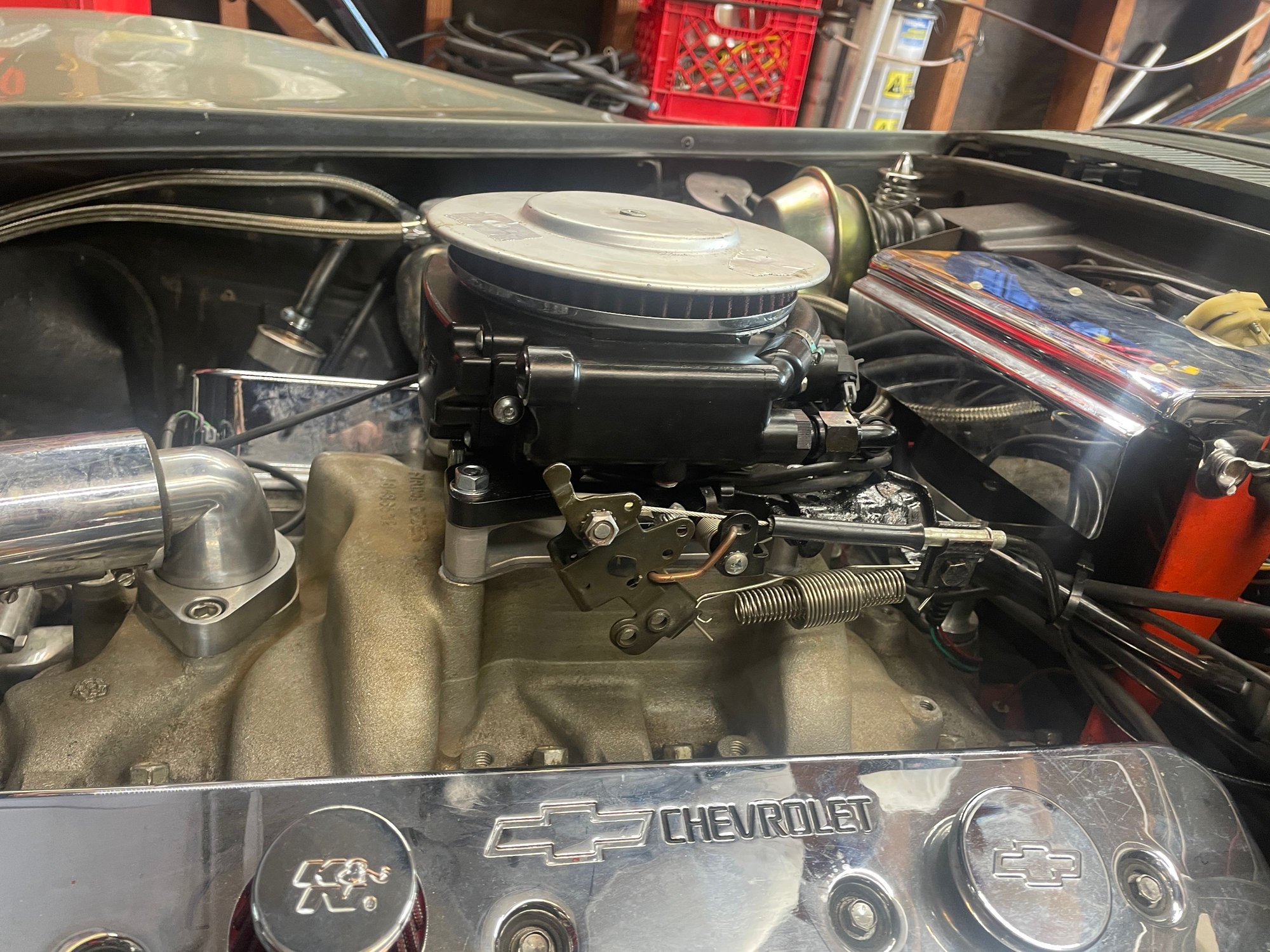

Well the pooling fuel theory seems very likely.
I removed the sniper to install a 1” riser and found some pooled fuel.

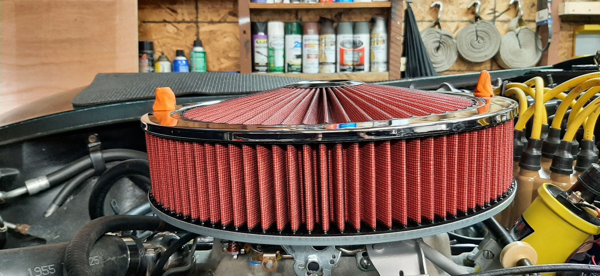

unfortunately the spacer makes the tbi unit too high and I can’t fit any air cleaner in my collection except the oddball home made job I used for a project a few years back.
I may drive with the home made air cleaner just to test if the rich condition changes with the riser.
I am using a modeling clay blob to check clearance.

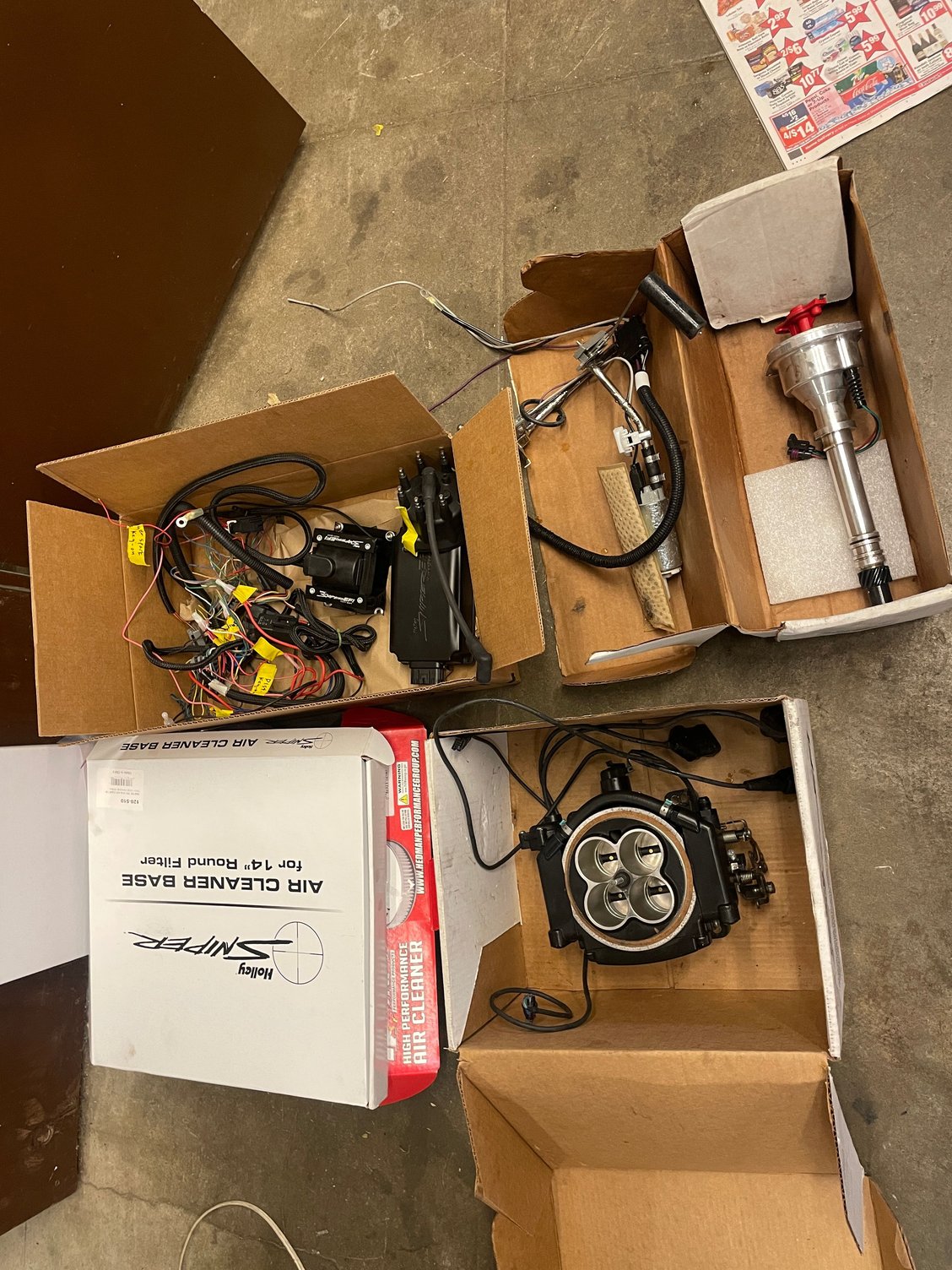

Goodbye Sniper I’m not going to miss you at all!
-the birds nest of wires that are absolutely the wrong lengths to ever bundle neatly

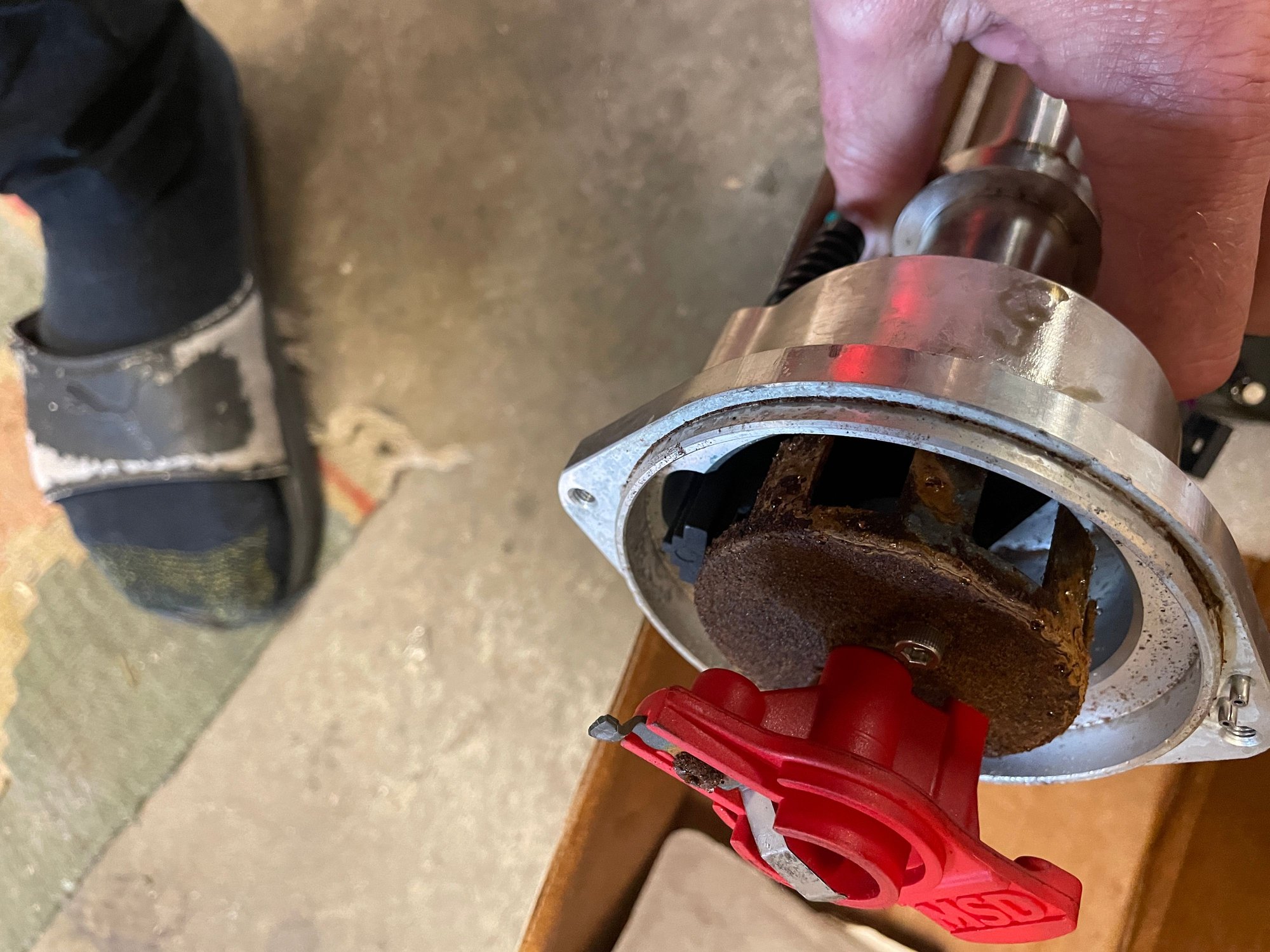

-the pos quality distributor made out of -the most rust attracting metal know to man ( this is somehow the only rust on my car)
-the the need to tune via laptop
-the fuel gauge inaccuracy
-the nebulous fuel distribution issue maybe due to manifold
-the concern that some solid state board will die leaving me stranded waiting for a back order part - all of it goodbye forever!!!!
yesterday I removed all the sniper stuff and reinstalled old school fuel sender and mechanical fuel pump on the side of the block.

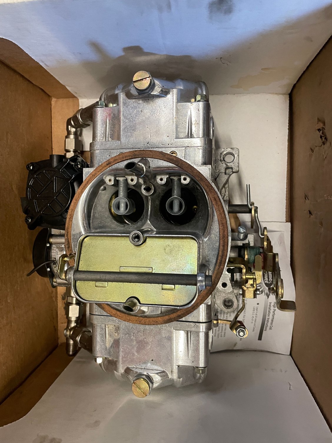

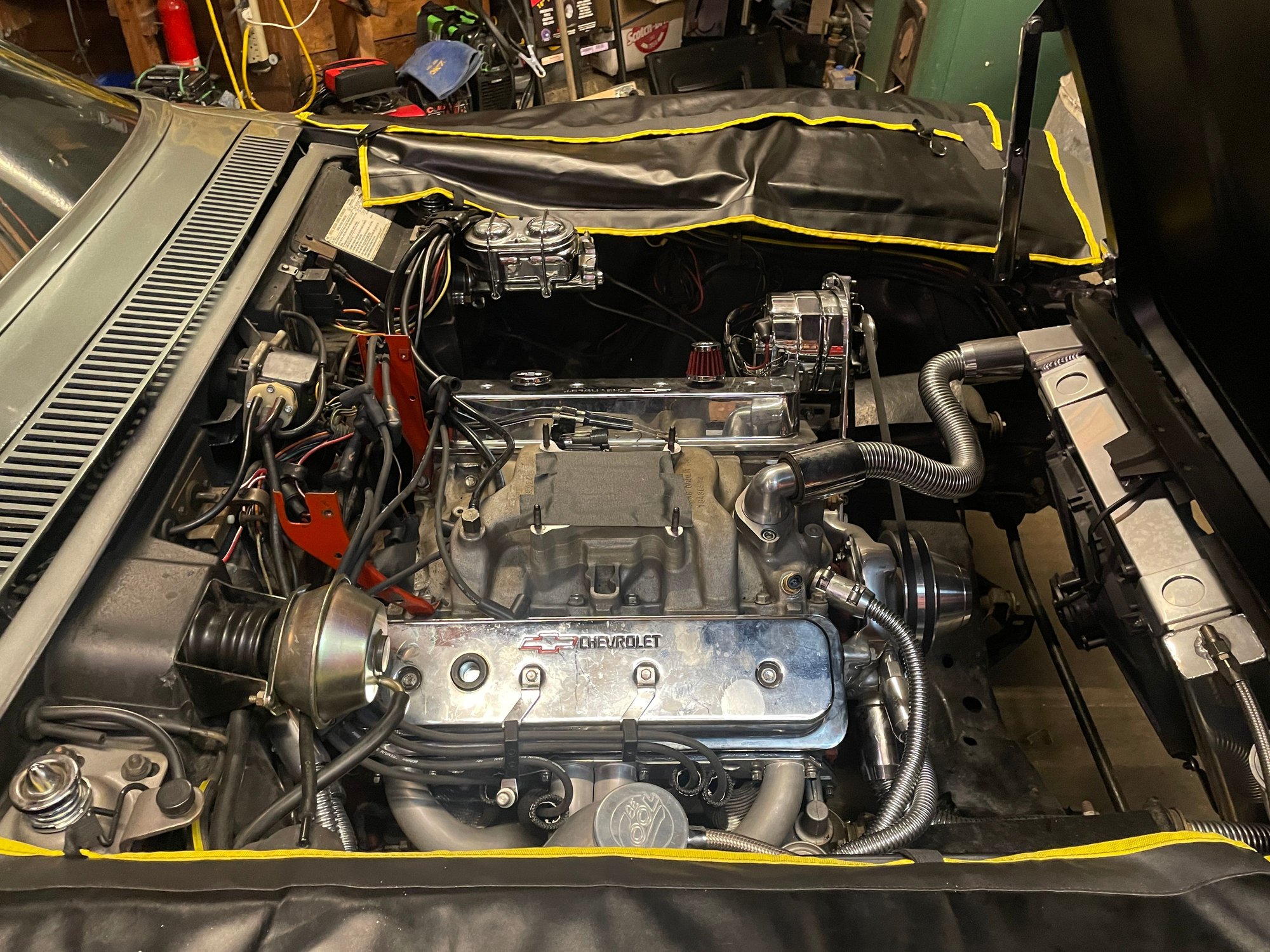

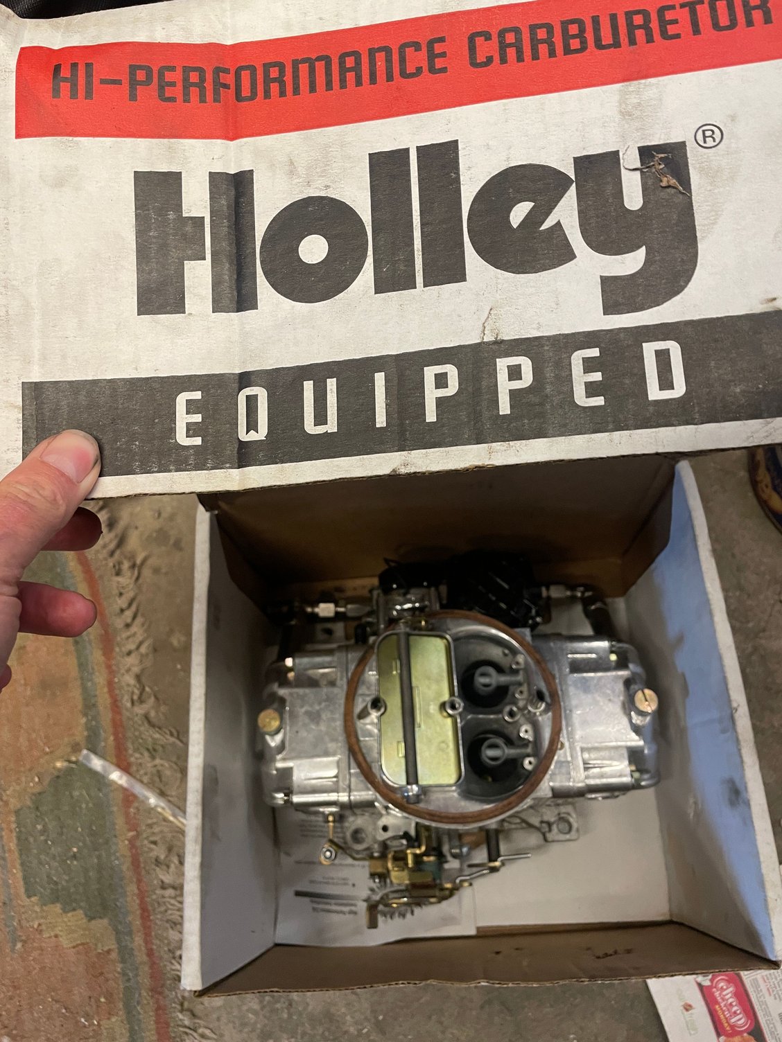

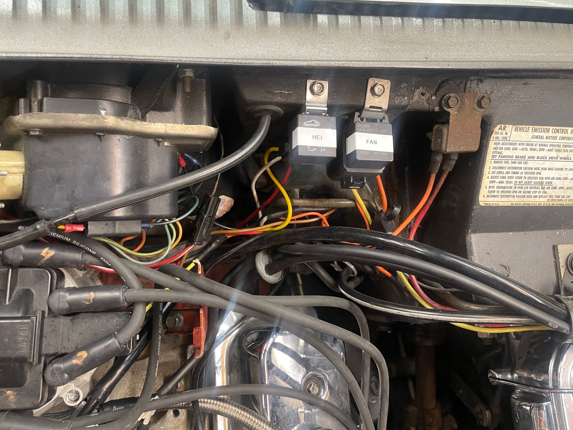

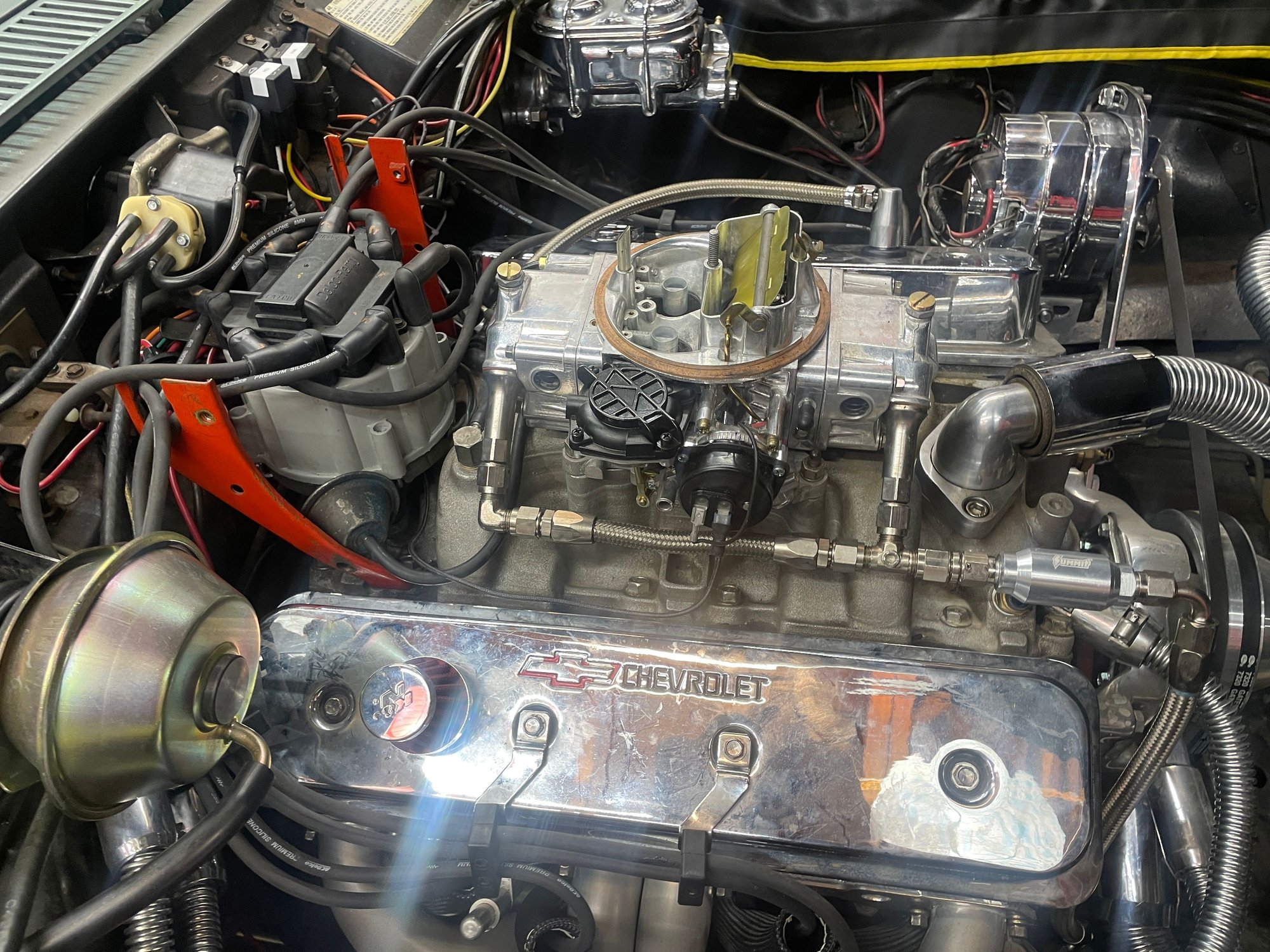

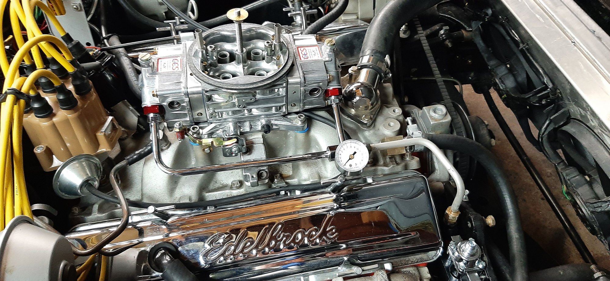

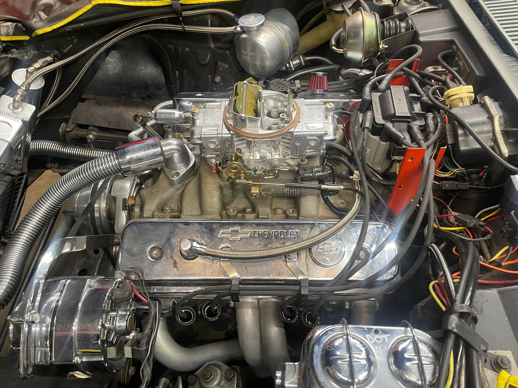

Ok the carb is back
seems to be running well.
I still have to set total timing after borrowing an adjustable timing light.
I added a relay to power the hei with good clean 12v power.
I think I will shop for another carb, there is nothing wrong with my Holley double pumper I have I just want to tinker with the car.
Pics of my non - ecu set up.
