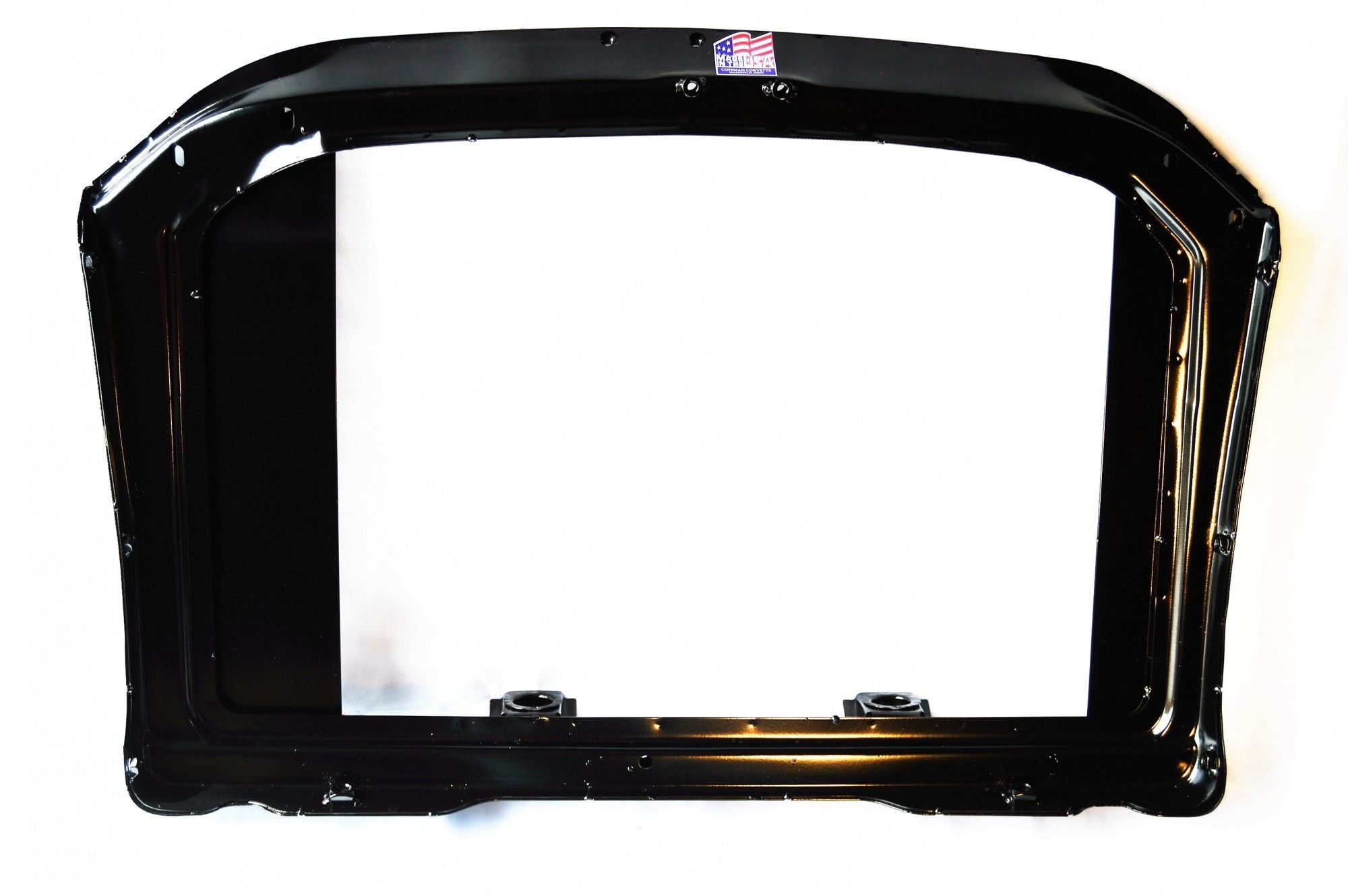

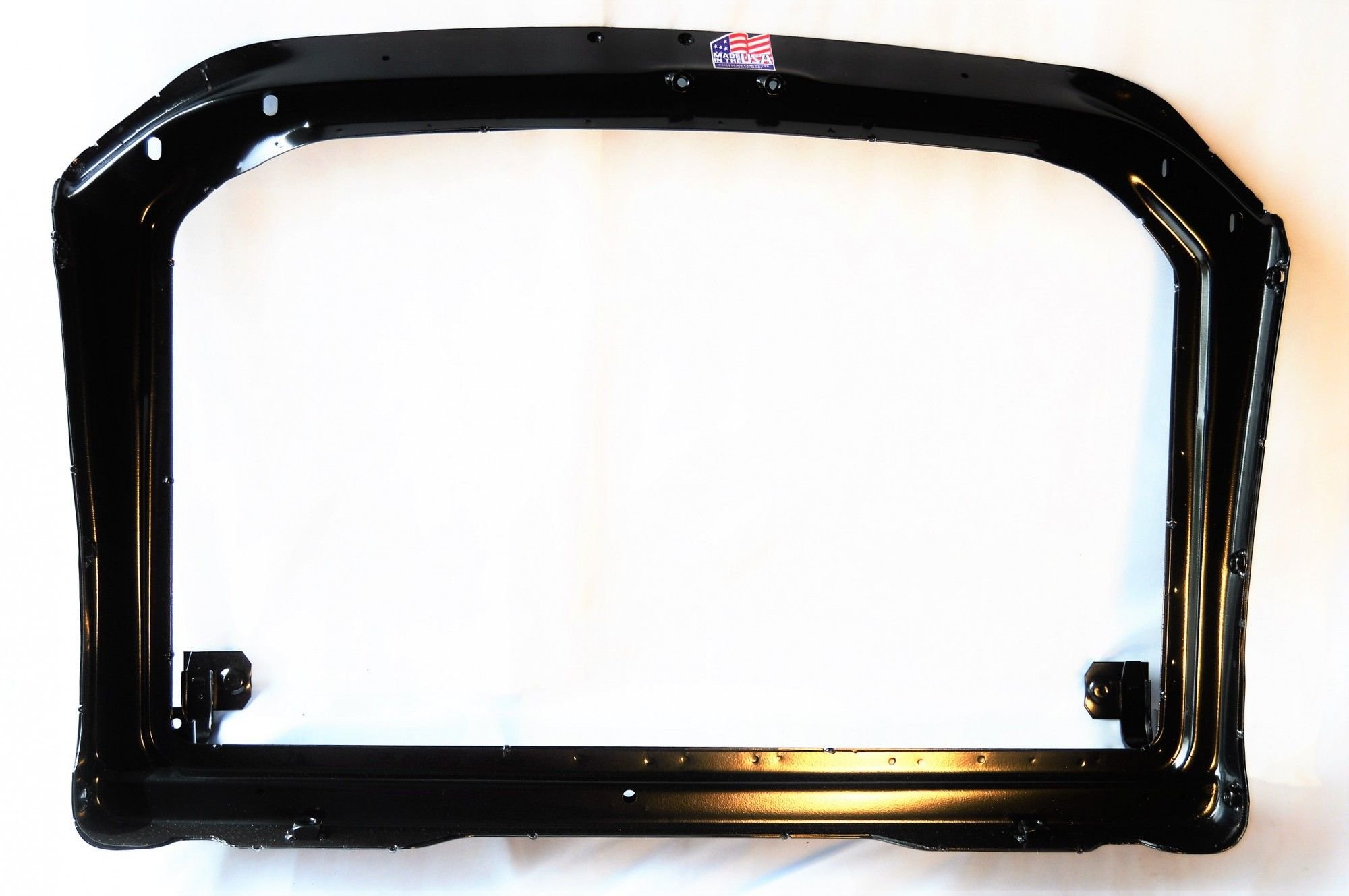

if trying to stay with current rad, i would weld or have welded the orig rad support. last thing you wanna do is buy a new 3 or 400 buck small radiator rad support then find out you need more cooling than you have. you can usually find a 100 buck harbor freight welder for 50 bucks. the bad spots on the rad support are in a place where your ugly first ever welds will not show at all...

here is the diff. you could probably cut the sheet metal sides out of your support to match the bigger hole in the AC and BB and newer rad support. and redo the mounts for the different radiator. but this is why i feel you should make do with a patch job on your support until you commit to a bigger rad and electric fans and shroud from a C5.
