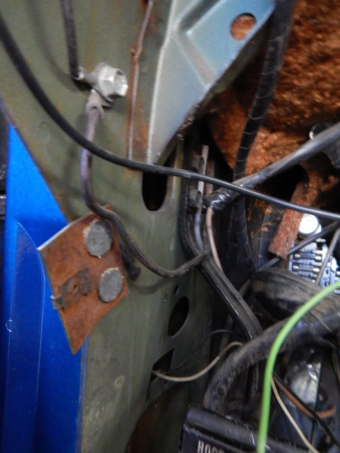

After having removed the seat and steering column for another project… I found that the ground wire is there and looks very healthy.
Hmmmmm.
Old Jul 30, 2022 | 12:15 PM
Fly skids up!'s Avatar
Fly skids up!
Joined: May 2021
Posts: 2,271
Likes: 1,316
From: Fleming Island, FL
That doesn't mean the dash is grounded. How's the body to chassis ground?
