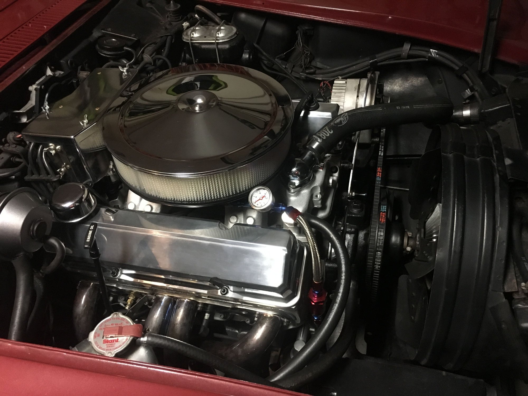

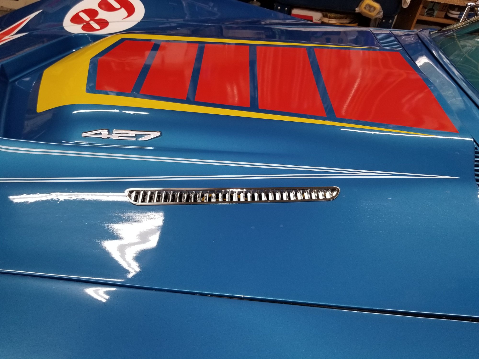

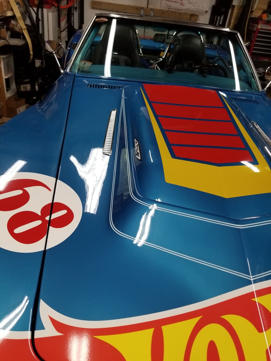

The hood vents would be in front of the engine and would let the radiator heat out but not he exhaust manifold heat out. There are plenty of pics of vents from the newer camaros grafted onto the hood to vent it. I got some 396 vents from a 66 to vent my header heat, and they work but I wanted the big 69 camaro vents to vent a lot of heat but there isnt enough room to fit them on the sides. Im still using the cold air intake so it wouldnt work in the center.
for engine cooling we all know turning on the heater can vent enough heat to help cool an overheating engine. I wanted to add to small radiators with fans forcing the air though them and out he side vents. I thinmk it would cool event he hottest motors. A lot of the super cars run multiple radiators to do this

That's a detail on your car I hadn't noticed before... nice and clean installation!

Thanks.
No one has brought them up at any of the shows ive been too. Just small enough to go unnoticed

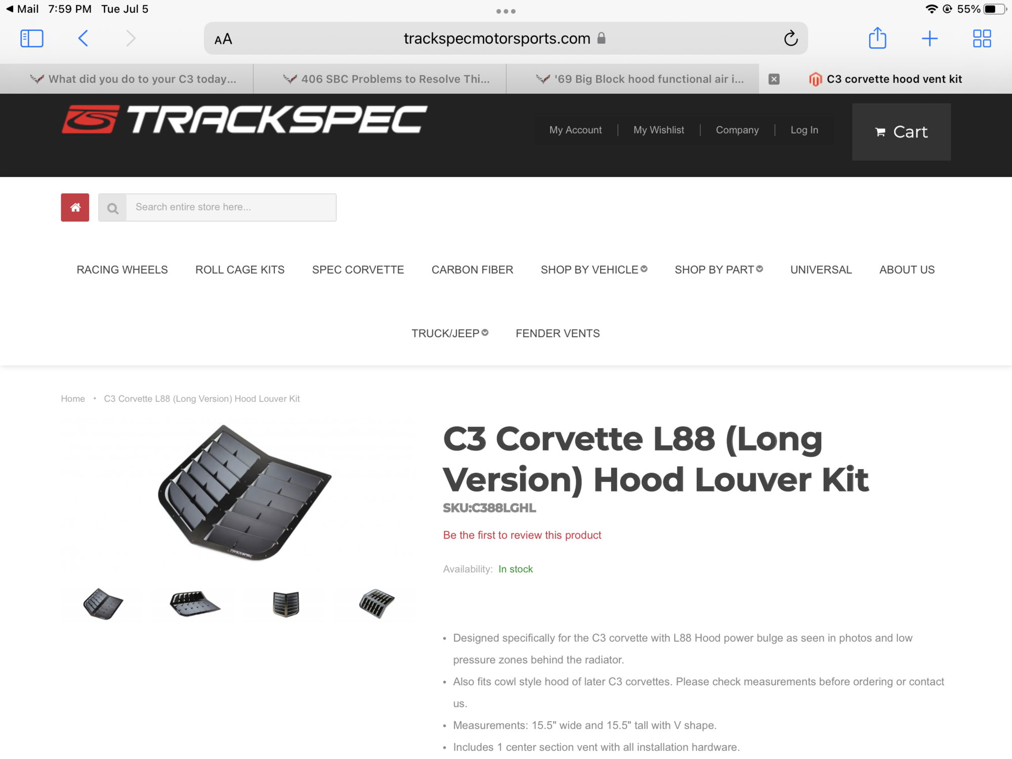

I'm trying to do everything possible to draw out as much of the heat trapped under the hood.
Several years ago, I drove home from a car show, was stuck in bumper-to-bumper traffic for close to two hours when the outside temp was 112 degrees.
When I finally made it home, I opened the hood and found everything under the hood was too hot to even touch.
Some of the things I'm in the process of doing is, removing everything blocking the movement of air flow around the side gill fender vents.
The charcoal canister, and the wiper washer tank have been removed from the driver's side.
The oem ac will be replaced with a Viintage Air system which will open the passenger side vent.
I'm going with an DeWitts radiator and dual spal fan set up which removes the lower portion of the oem fan shroud allowing additional air to be forced up from behind the radiator.
I am also installing an oem chin spoiler extension to help.
My oem 73 hood has been replaced with a tall L88 hood for the additional clearance needed for my 496, intake, spacer and carb set up.
The top of the hood will be opened up and I'm adding a hood vent that will draw in ambient air at speed and allow heat to vent out at slow speed and when stopped in traffic or parked.
I'm also leaving the rear of the hood open which will draw in ambient air and allow heat to escape.
This is not a picture of my car, but a picture of the vent I'm installing.

OldCarBum,
That vent seems like it was made just for that spot. What is it from?

Originally Posted by Big Block 69
OldCarBum,
Rick
It’s specifically made for C3 Corvettes.
It’s a really stout yet ultra lightweight piece.
Give them a call, they are great to work with.

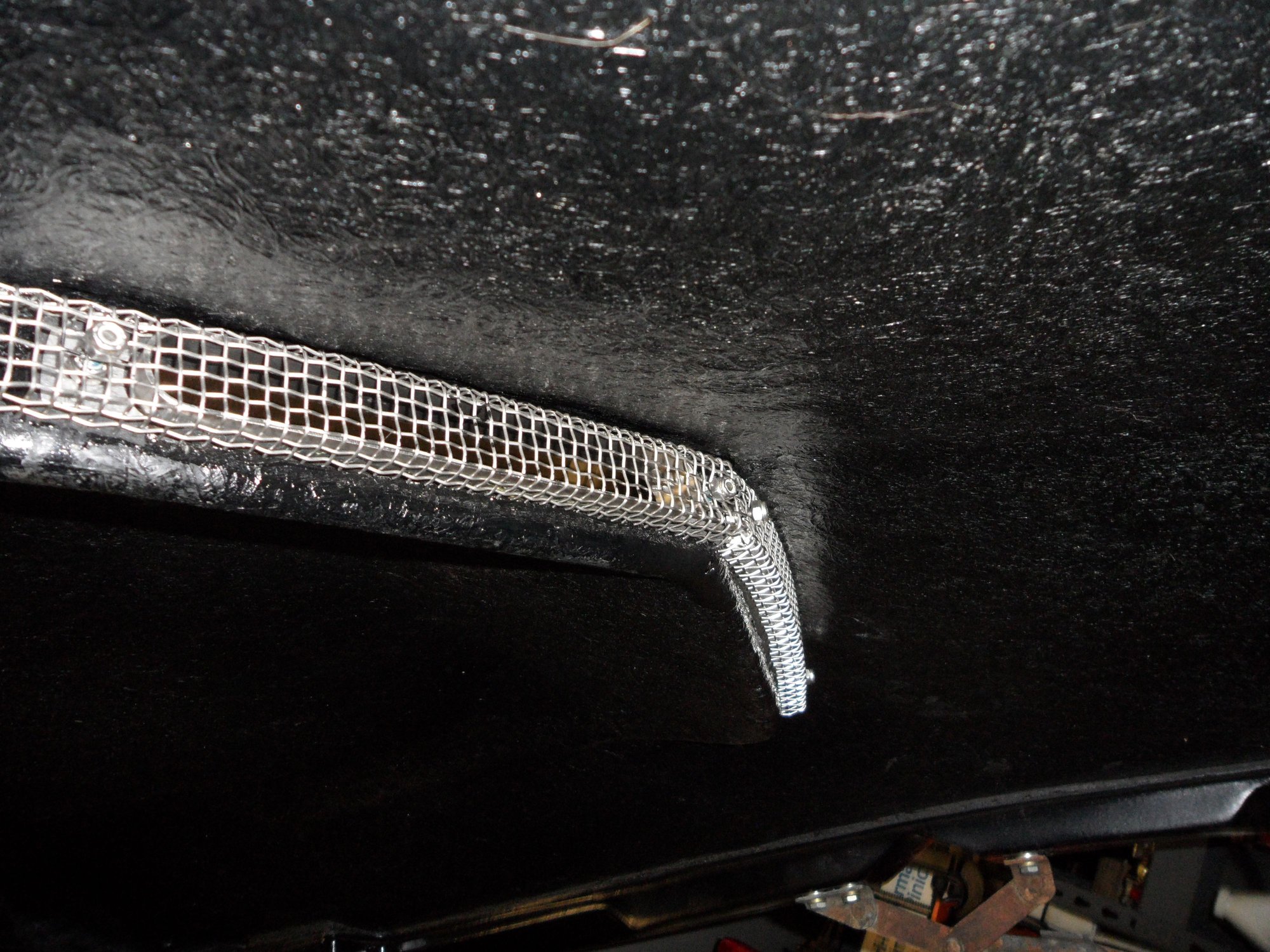

downside is that during torrential downpours, the rain water drains onto the alternator belt, alternator stops charging, windshield wipers flapping, defroster blowing, etc. never bothered to make a rain shield. or rain drain catchment diverter do-hickey, just do a better job of checking the weather report. heat is definitely coming out of those vents. 540 big block. you'll burn yourself touching the vents after driving. if I had to do it over, I would've integrated the functional vent style with the hood faux vent style better, swoopier. I was desperately just trying to vent under-hood heat.
ETA: video is a boring errand run, no banzai burnouts, no engine revs, nothing, just driving to the post office on the freeway. nothing exciting, boring all the way to the end. so don't waste 10 minutes of your life watching it to the end.

Wow. How did you shape the screen on the backside? That looks REALLY clean -looks like something you would buy from a vendor that was already formed.

how did I shape the screen? can't remember, 10yrs ago, but nothing sophisticated, stone-age tech, probably just the odd piece of wood, the big 8" jawed vise, and a honkin' rubber mallet. IIRC, the oval pieces started off as 5" SS exhaust tubing.
