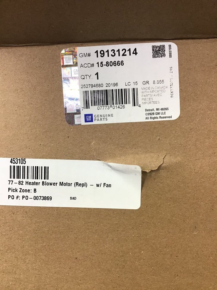

Not sure if newer fan fits but here are some comparisons old original vs new..and some vids
i personnally don’t need more air than a 79 puts out..
and made in Canada 🇨🇦..not the chinesium one..about 3x cost..
i would also say a newer good quality fan should outperform a worn out old one..i do know for sure the off/ low speed fan setting i could hear louder than the old one so it must have be moving more air at least on low comparatively
https://www.corvetteforum.com/forums...d-working.html
