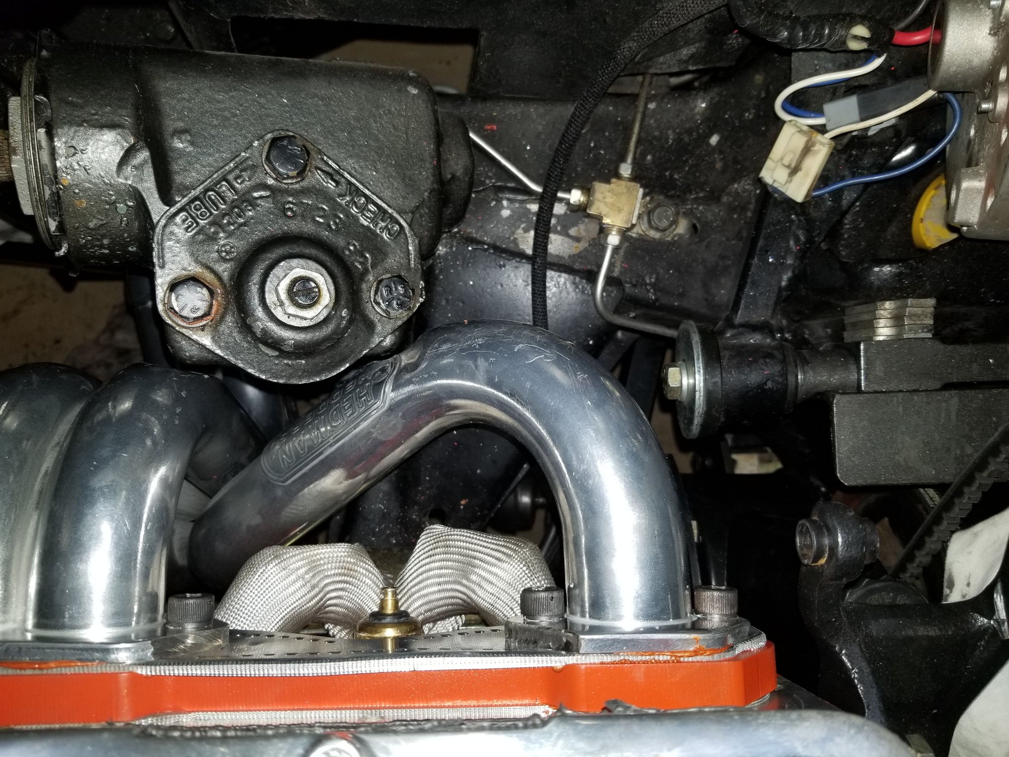

I had Hedmans that interferred but had to use them with my side exhaust, so I added some marine exhaust spacers and it took care of all the issues. The added issues was massaging the drivers side to fit the steering box and buying longer bolts to bolt it all together. I bought allen head bolts with lock wire holes so I could wire them in place once they were torqued. I also used aluminum gaskets to eliminate and possible leaks.

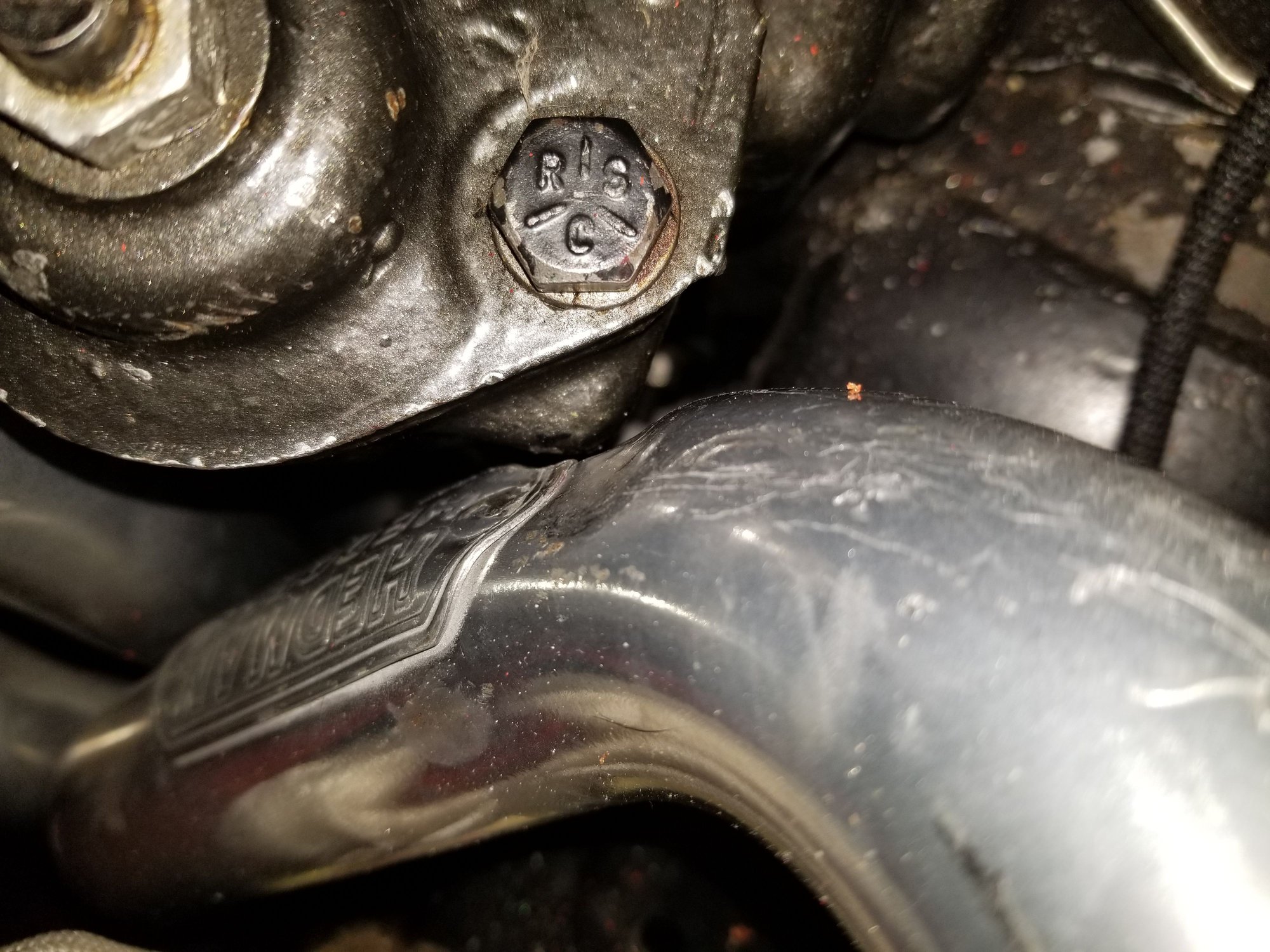

Rescue Rodgers. In the third picture, Is that a crack on your idler arm just above the Zerk fitting? Sorry I'm not computer savvy enough to reproduce the picture with a circle around the crack.
