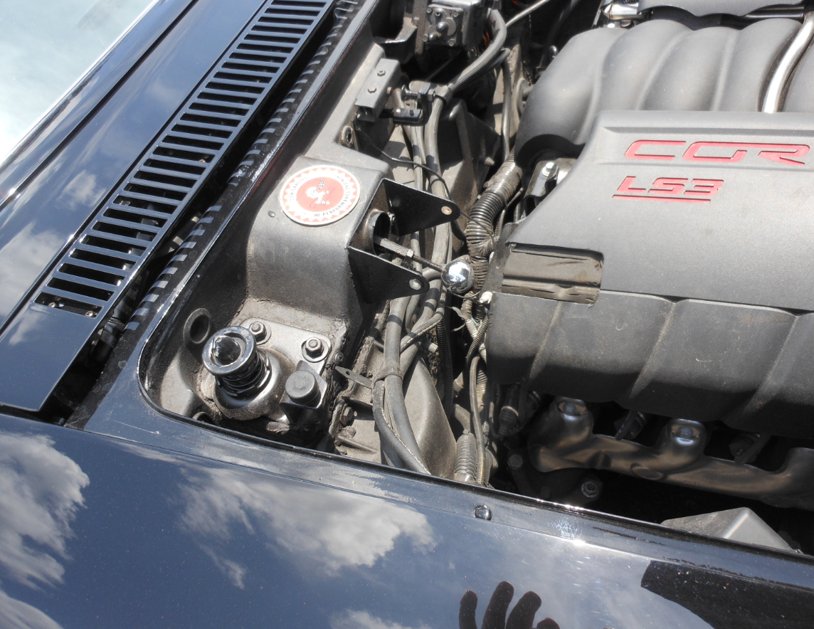

- Is there a way to make them work "mechanically"? Like could I open the hood, push the lever and then the wipers work?
Thanks in advance.
Chinese Junk....

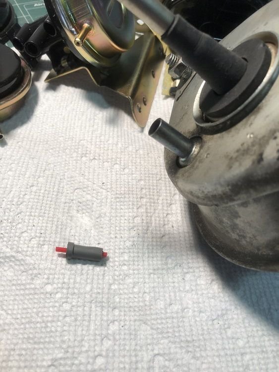

Mechanically? Like this?

So......Chinese junk collapsed the reservoir? There have been threads recently on the switches being bad too.
Is that mechanical method a real option...i.e., can you just open the hood, push it, the door opens, and THEN select the wipers on and off? Or,....as soon as you push it, the wipers run till you get back out of the car and pull the lever? I know its sorta Bubba......but honestly, I avoid the rain most of the time, and when I get caught, its an easy thing to do. I used to open and close my headlights manually as well, but decided to get the vacuum system working.
Yes.
The factory set up allows you to remove a rubber plug on the vac actuator and push open the door using any blunt instrument in the event of vacuum loss. The **** in the photo is just a handy extension so you don't have to use a blunt instrument.
To close it you just push down on the door itself (after shutting off the wipers). Without vacuum to the actuator, the door will stay in whatever position you manually put it in.
I manually opened/closed my door for several months after buying the car until I found the simple problem that was preventing operation, and fixed it.
