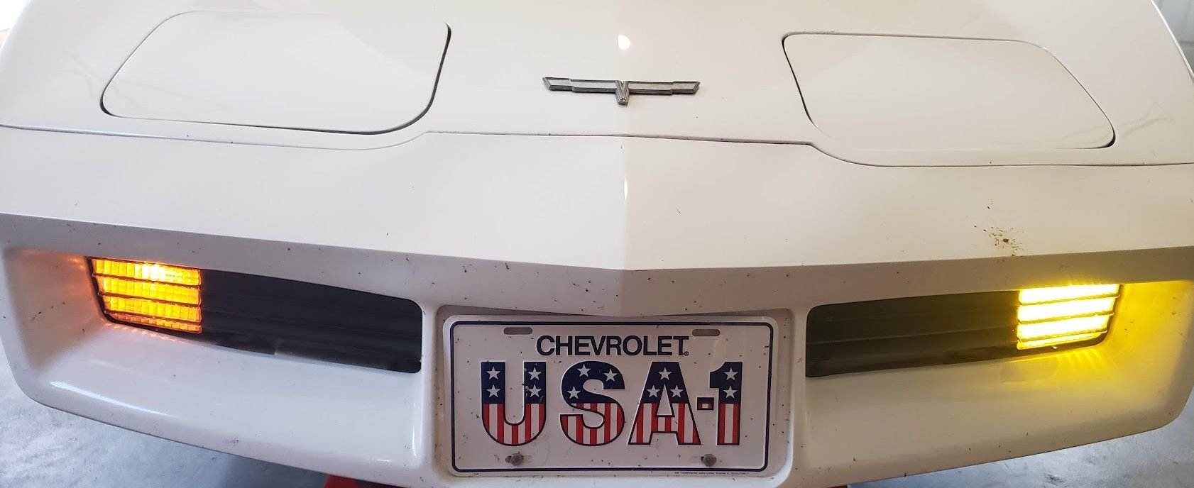

Thanks! Those specs look similar to the bulbs I am using. The key, as you pointed out, is the amber flash overrides the white. That, plus a diode fed always-on tap for the white part of the circuit, and a 3-wire LED flasher (2, one for turn signals, one for hazards), and you should be set, if you keep incandescent marker lights. I'm not sure if the marker lights will ever go out 100% in that configuration with your headlights on. You can do it with LEDs and Blinker Genies, though (it's all in my thread).
White DRL on the port side (shining through a tinted lens, so it still looks bright yellow, you won't have this problem), and the "on" part of the turn signal on the starboard side.

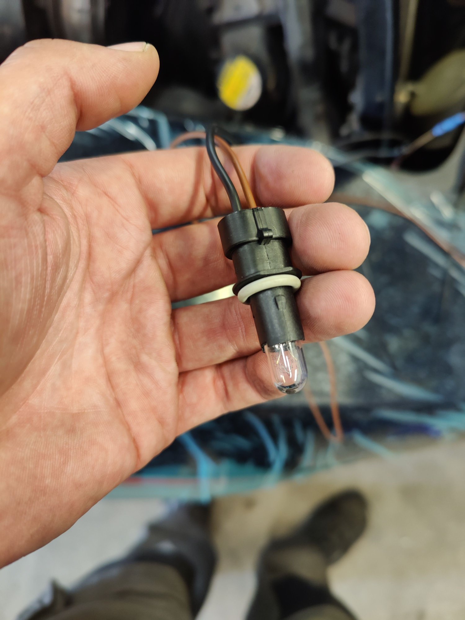

​​​​​​Yes. I made it today. Cut the brown wire, and wired it to the new 5watt drl housing, and made a new ground. Did it on both sides, and it is like it should be now. I am just waiting for the orange bulbs to arrive now. The 5 watt is on at all times when the switch is on. And the blinkers blink and does not just dim when blinking.

Using my original turn signal extension harnesses I installed the Switchback LED bulbs.
Park and Turn worked perfect without the need for the 50 WATT 6ohm Load Resistors.
Original Flasher Relay still installed.
I then tried the Hazards, well right side flashed but left side just one or two of the amber LEDS lite up and didn't flash.
So I installed the Load Resistors on the 2nd set of turn harness extensions and no problems at all.
These White park or DRL are really bright.
Little heat as the LED bulb frame is aluminum not plastic like some.
$10.00ea new bulb sockets.
$7.00 for the pair of load resistors.
$14.00 for the LED bulbs.
No cutting or splicing wires as I used the correct PACK-CON 1 Terminals.
