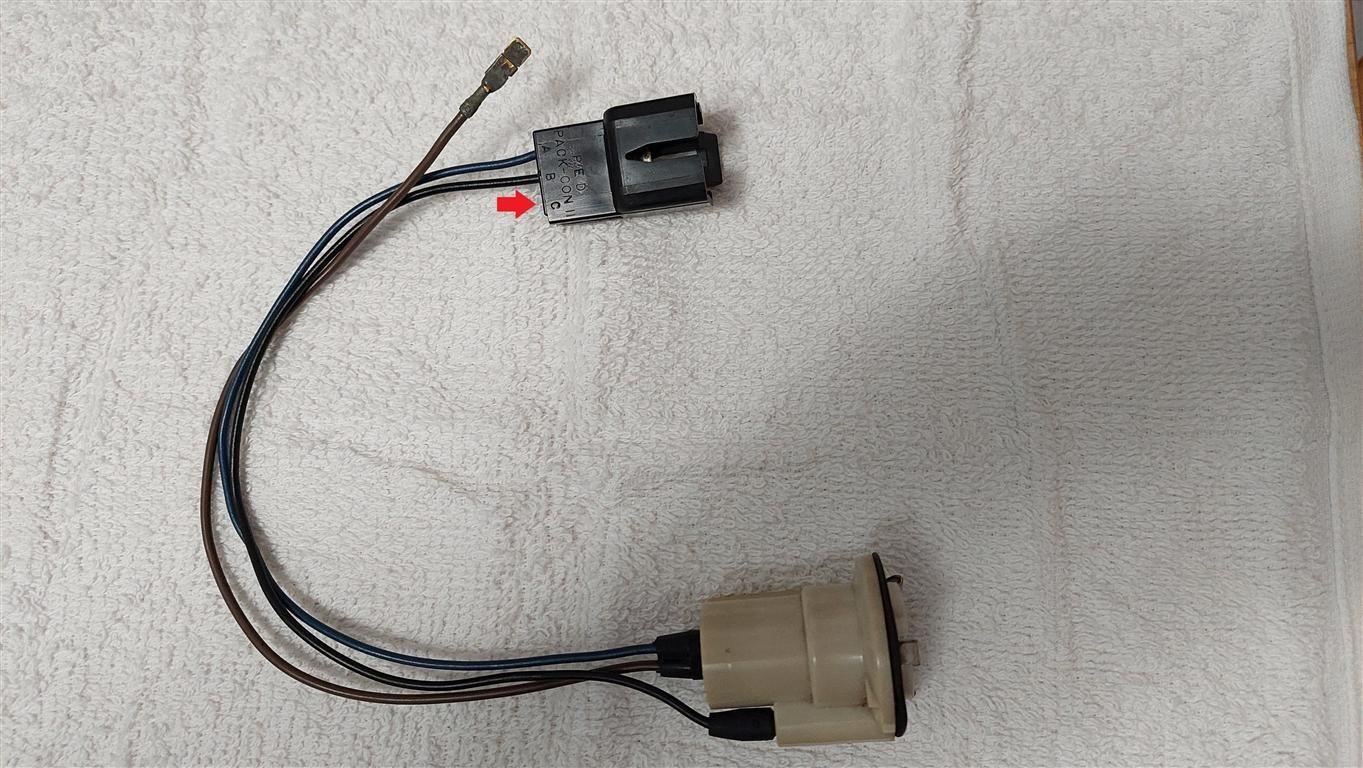

Headlight Switch ON Circuit #9 will power one side of both front #1157 Bulbs.
L or R turn selected either Circuit #14 or #15 powers the other filament of the front 1157 bulb(s)
If any of the bulbs are defective in the L or R circuit it can affect how each circuit(s) work.
This photo is from the 1978 Corvette Electrical Troubleshooting Manual with circuit operation included.
I omitted the Brake Light portion of the circuit operation text...
I would say other than a possible faulty front left 1157 bulb it looks like the circuit is working as designed.

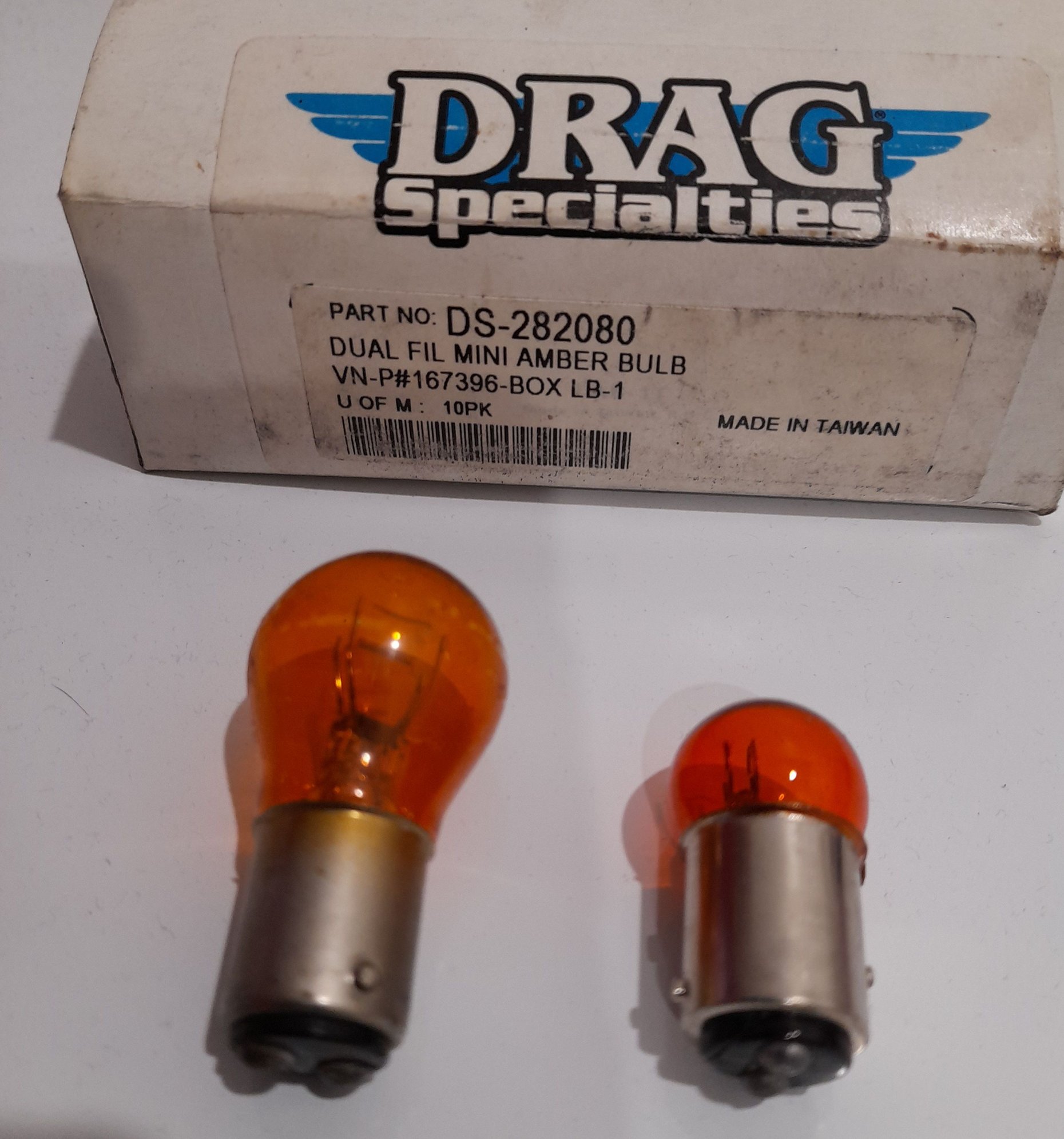

Backside of turn signal housing. Note the large white socket is the factory socket. as you can see it's offset to the left. the new socket is a socket I cut out of an old gauge. It holds a clear single filament LED bulb. Simply cut the running light wire off of the original twin filament socket and run to this new socket. Perhaps you can tell by the photo, this modification was done some 15 years ago. Still working fine.
Standard front running/turn bulb on the left. replacement mini bulb on the right. with the standard size bulb the white light shown through the amber bulb creating a amber edge on the front light. With the mini bulb no issues. These mini bulbs were used in Harley's with custom signal lights. Try an aftermarket Harley type work shop to locate them. The drag Specialities part number is on the box. I bought a box of 10 15 years ago. I have 7 left.
With 2 separate sockets. your amber bulb will go out completely. even if your running lights are on.
Got me compliance in Australia.

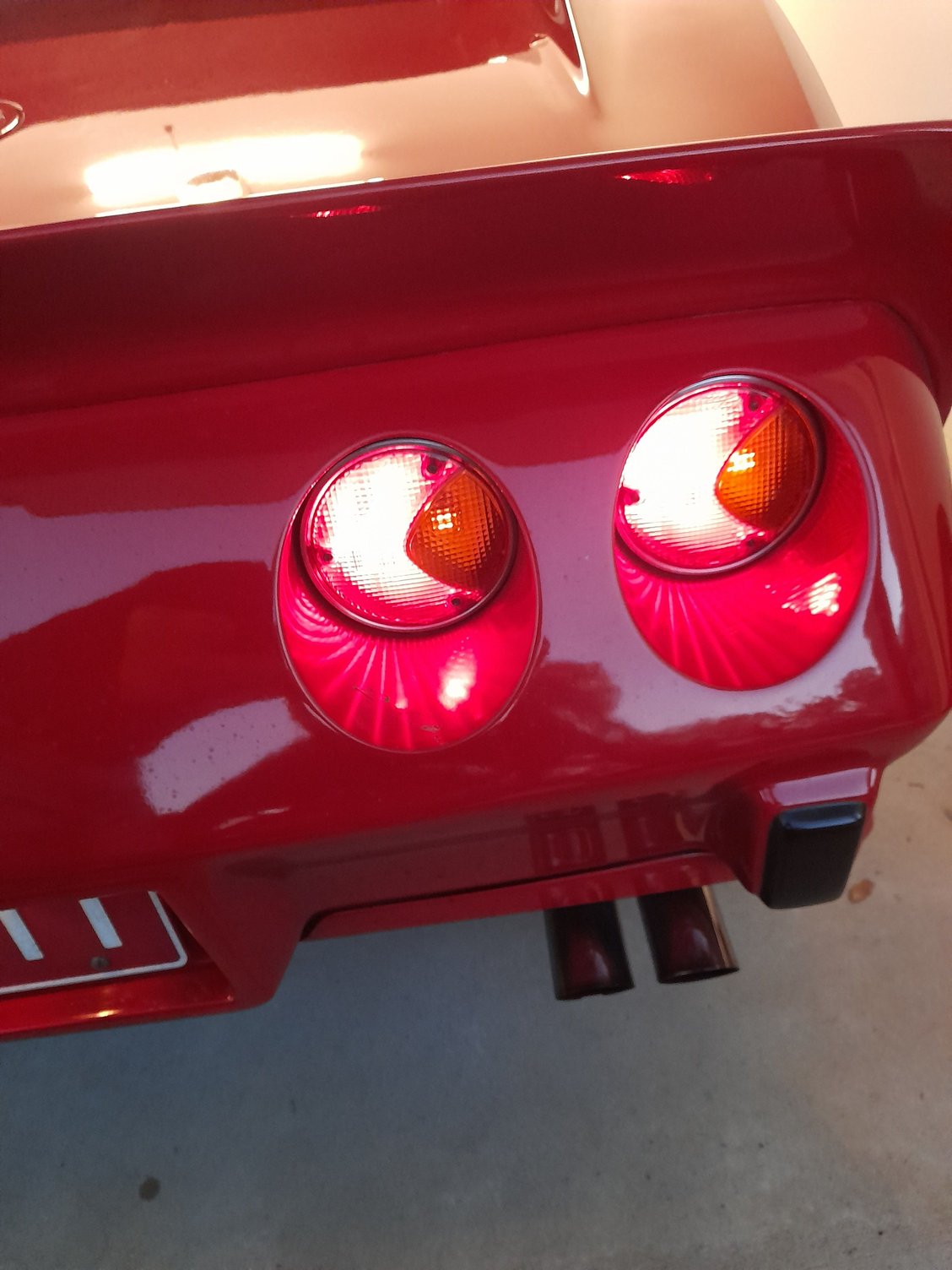

OK. trying to get good photos of turn signal lights seems near impossible. And posting a video on here is beyond my talents. But here's my best shot.
Front light with just running lamp lit. it's white now instead of amber which makes the Australian government happy.
Best attempt at getting a photo of the amber signal. I assure you it looks much better in real life. And goes out completely with running light on or off. As now running light is white there is no confusion.
Rear lighting solution, Also need amber signals in the rear here. Also a twin socket setup. In this photo tail light only is on.
And signal flashing, once again, very hard to photograph.
Hope this helps.
Hope this helps.
Thanks. If you want, you can upload to YouTube, and link the video here, that's easy enough :-) i would love to see it live, and show it to my MOT guy before i do the job.
So that new plug you added holds the daytime running lights, and the new orange bulb is in the original socket, and when you blink, the orange bulb is so powerful, it blinks so bright, it overrules the white led?

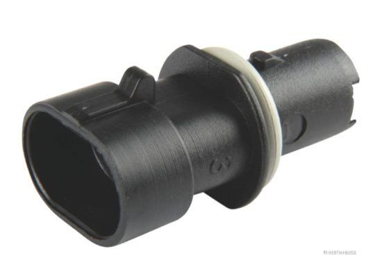

So that new plug you added holds the daytime running lights, and the new orange bulb is in the original socket, and when you blink, the orange bulb is so powerful, it blinks so bright, it overrules the white led?[/QUOTE]
Yes. definitely over powers the white.

So, one of these in each lamp with a 5w white bulb in it, run the 9# wire to it, and a new ground. replace the original bulb with a orange bulb, Jobs done?

Yes, cut a hole in the back of the light housing for the new socket. Cut the running light wire that went to the original socket, now send it to the new socket, new ground wire. Jobs done. I'll check the bulb I used for the new white running light. I'll get back to you.
