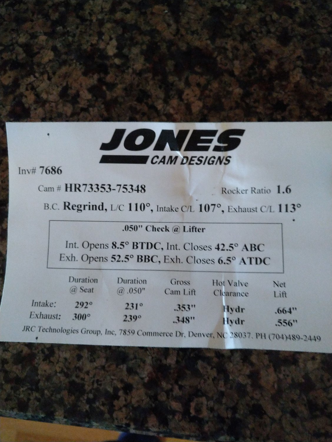

I Think it was something like $280. This Cam is for a Vortec 4 Bolt Main Block with AFR 195s and a Accel Super Ram Intake. (C4,)

I would be Leary of some company that doesn't even know what lobe lift and rocker ratio adds up to? 1.6 X .353 = .5648 not the printed .664
Regrinding cams... Locally Erson cams used to do it. But it required welding with hard rod, machining, and then retempering. Because the lobes are set on the original you can't really change LSA. The lift total and ramp rate could be changed.
I caught that too. In the recomendation it had the correct math.

as far as Mike Jones' cam card is concerned; isn't a recognized leader in the field permitted an occasional typo or two? Can't we easily adapt to such minutia?
