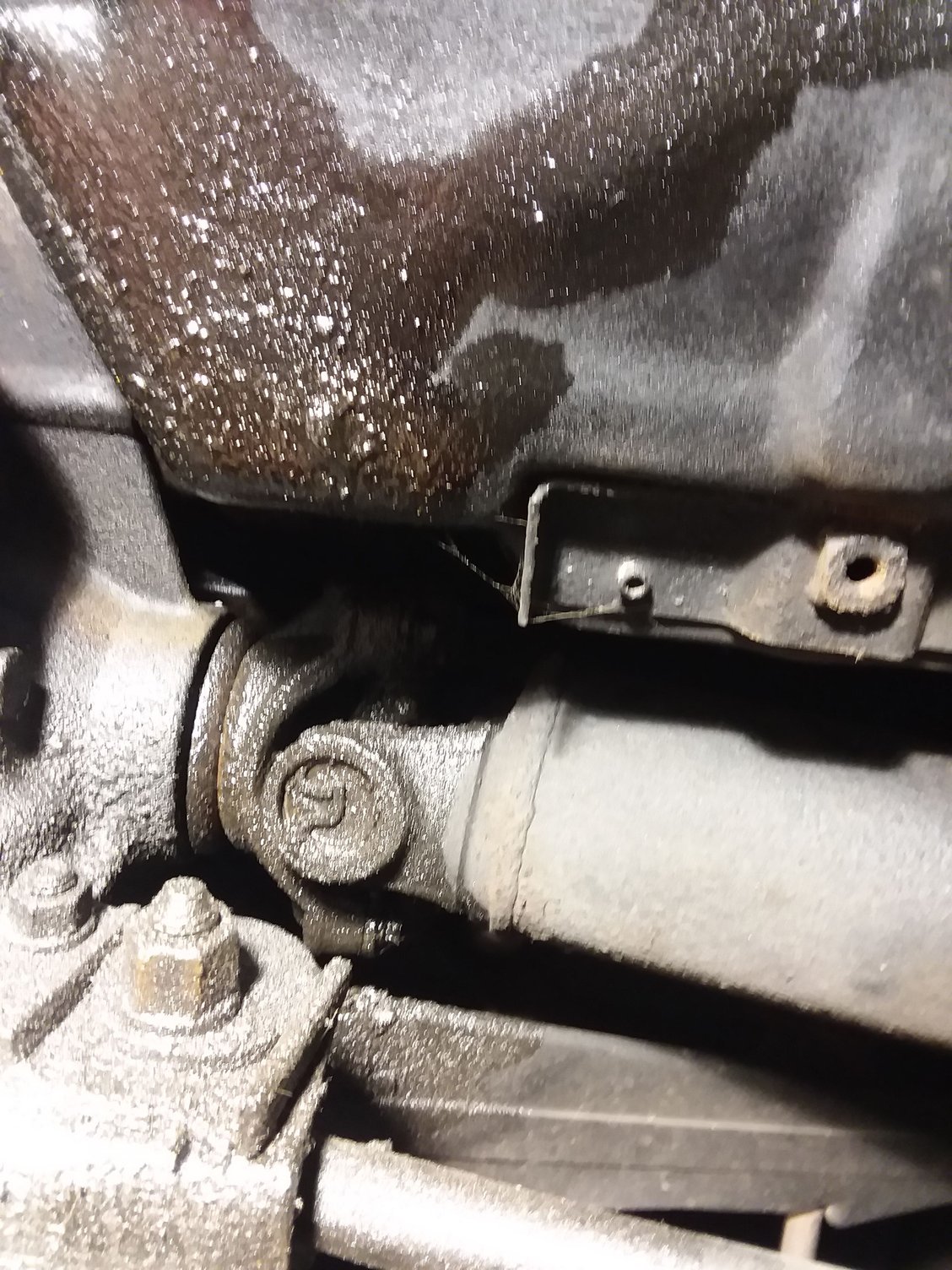

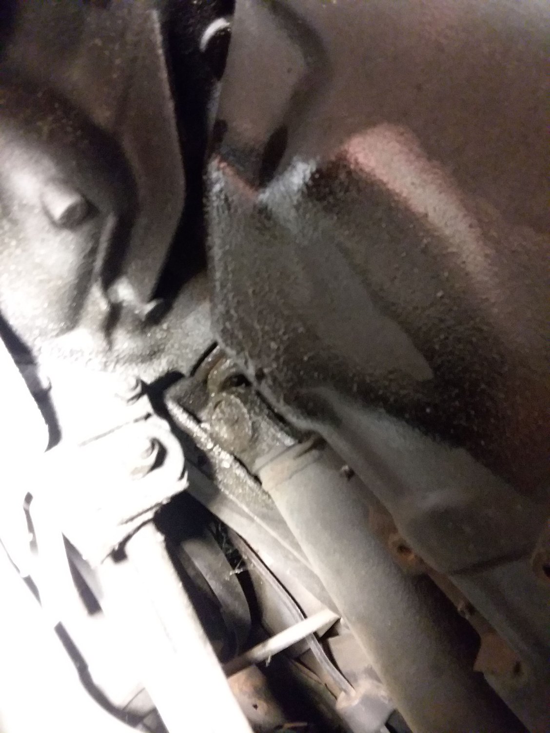

Default Rear gear
I will take some pictures,but looking at the back of my car,it appears someone in the last 5-10 years,just guessing though,but they replaced rear shocks and replaced the spring,I’m assuming that’s what that one thick bar is,but can also tell on the drivers side a spot the size of a footbal,just in front of the u joint on that side,so,appears leaking between u joint and differential,is that common?
