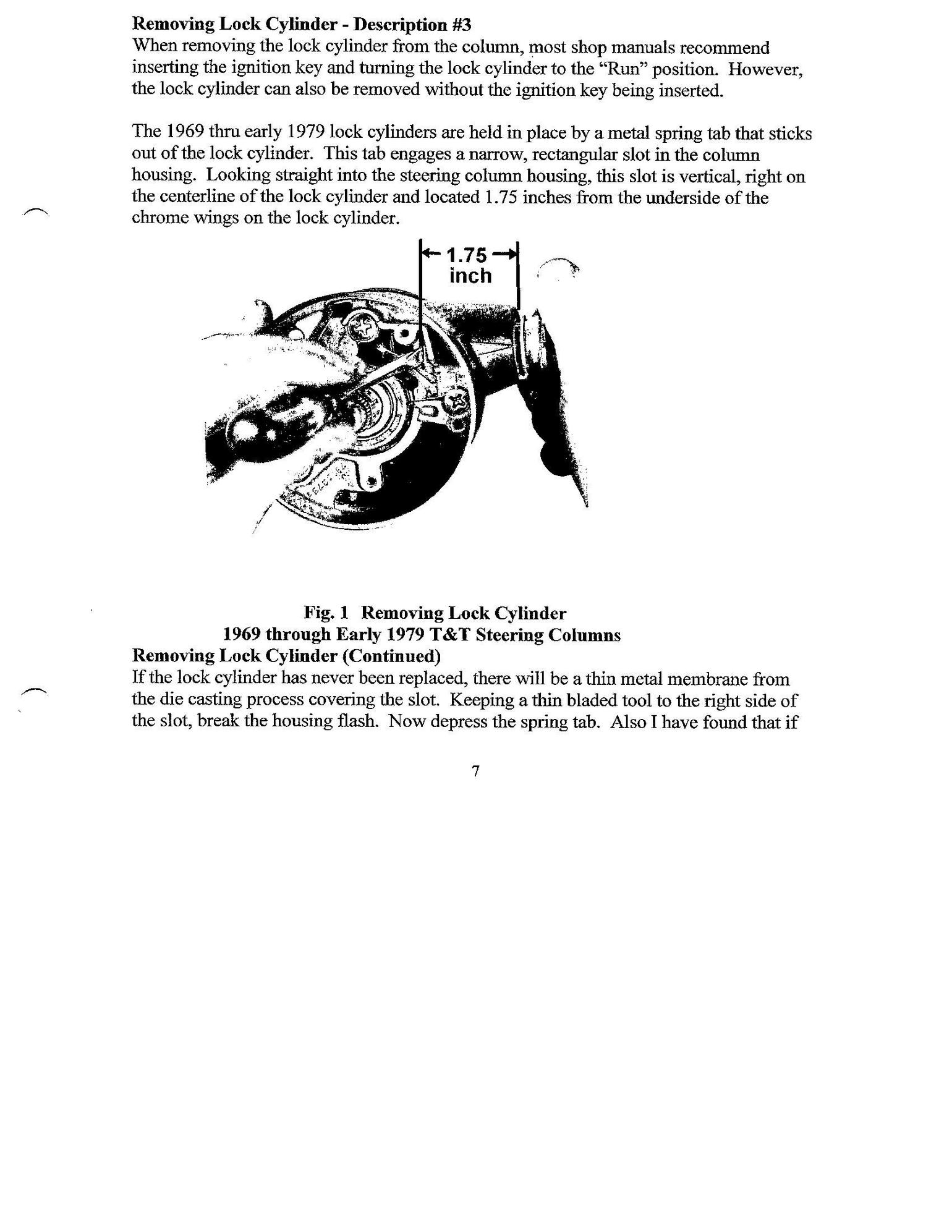

Have you seen this, it might help.....
http://jimshea.corvettefaq.com/
Old Jul 14, 2022 | 03:26 PM
Peterbuilt's Avatar
Peterbuilt
Joined: Aug 2006
Posts: 7,426
Likes: 1,559
From: mount holly NC
From Jim Shea's papers

ok tank tou buddy, i see this hole but mine is not open should I open it? it does not come open tank to answer have nice day

is my translation is good: yes is me to open because is never changed in my car have nice day buddy, i say when all is good

i open but the cylinder d'ont come buddy and my plate is not the same of the picture, + i have some dificulties to tranlate in french

do you have info for me belgian buddy ? i open the ole but the cylender d'ont come

When you opened the hole, did you insert a small punch or screwdriver in the hole. If it is like a '72, you have to push something in that hole to get the cylinder to let go.
Lorsque vous avez ouvert le trou, avez-vous inséré un petit poinçon ou un tournevis dans le trou. Si c'est comme un '72, vous devez pousser quelque chose dans ce trou pour que le cylindre lâche.

tank you verry much to answer buddy, yes I have now opened the small rectangular hole still closed on the photo, and inserted a rod but it does not come to me, and in the square hole something is also I think if you have idee say me please ? merci beaucoup mon ami, vous parlez français ? oui j'ai ouvert maintenant le petit trous rectangulaire encore fermé sur la photo , et enfoncé une tige mais ça me vient pas, et dans le trous carré quelque chose tient encore aussi je pense je ne comprend pas si vous avez une idée , merci d'avance

The only other thing I can think of is that as you push the rod into the hole, turn the keylock slightly clockwise pulling out at the same time. I just can't think of any other way to help you. Sorry.
La seule autre chose à laquelle je peux penser est que lorsque vous poussez la tige dans le trou, tournez légèrement le verrou dans le sens des aiguilles d'une montre en tirant en même temps. Je ne vois pas d'autre moyen de vous aider. Pardon.

ok buddy tank you verry much to answer i make it , have nice day from belgium
