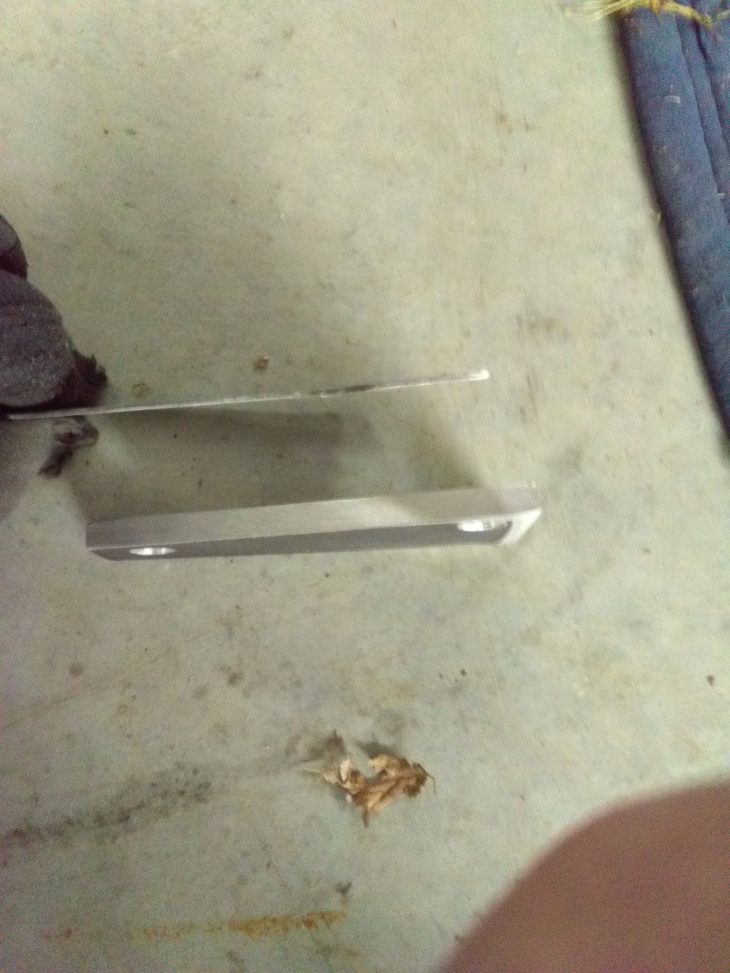

Here's the alternator bracket, problem solved almost. Now belt alignment. again

Nice catch on the belt! i didnt notice that. It's a summit bracket. $72. Had to make a shim.

Nice machining skills. More pro looking than a bunch of 10 cents washers for sure.

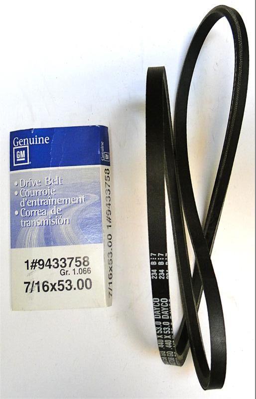

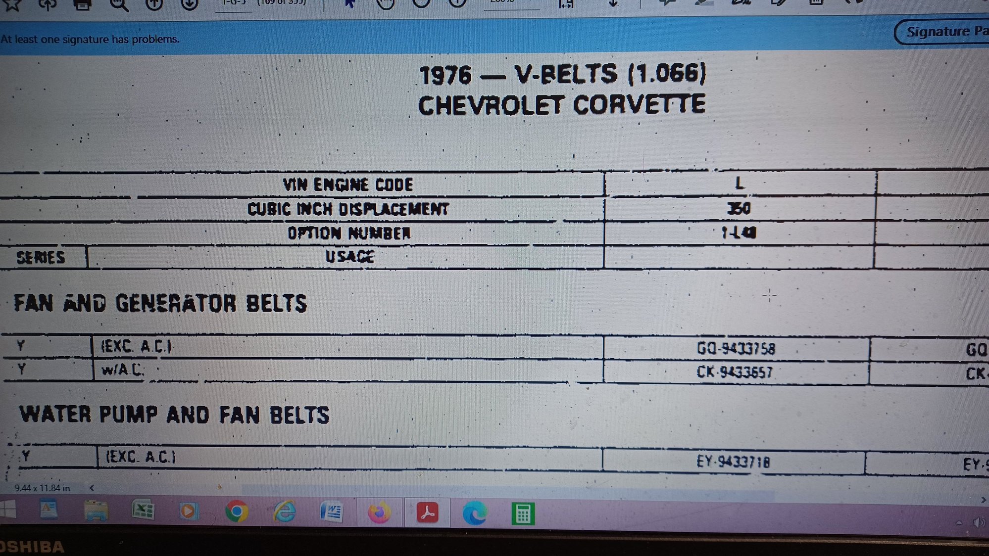

The belts are done! I had to make a THICK shim. The thin ones weren't doing anything. My Dad's a science teacher, he said "take the thickness of the shim, divide it by the number of pulleys touching the belt, and that's how much it will actually move. It worked
