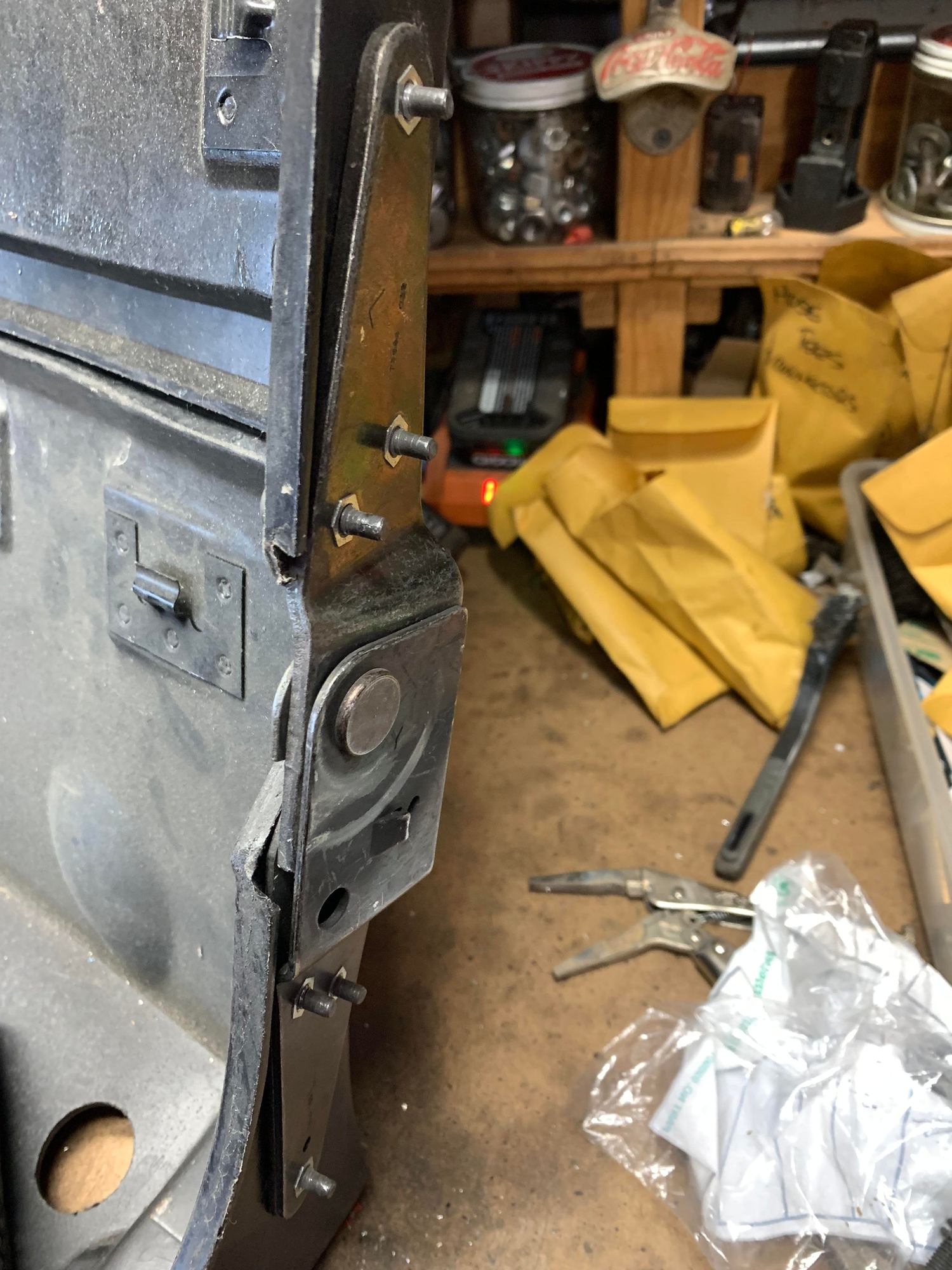

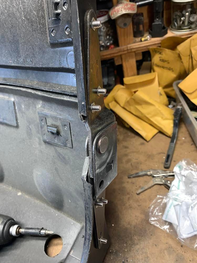

I mean the plastic covers that cover the hinges, not the back of the seat, Unfortunately, the safety lock is on both hinges. I had trouble with my seat not wanting to fold, but the lock was only stuck on one side. Yours might be both.
Heres what the hinges look like uncovered. The small lever looking thing on the outside of the hinge is what you need to move (If I remember right).
Dave

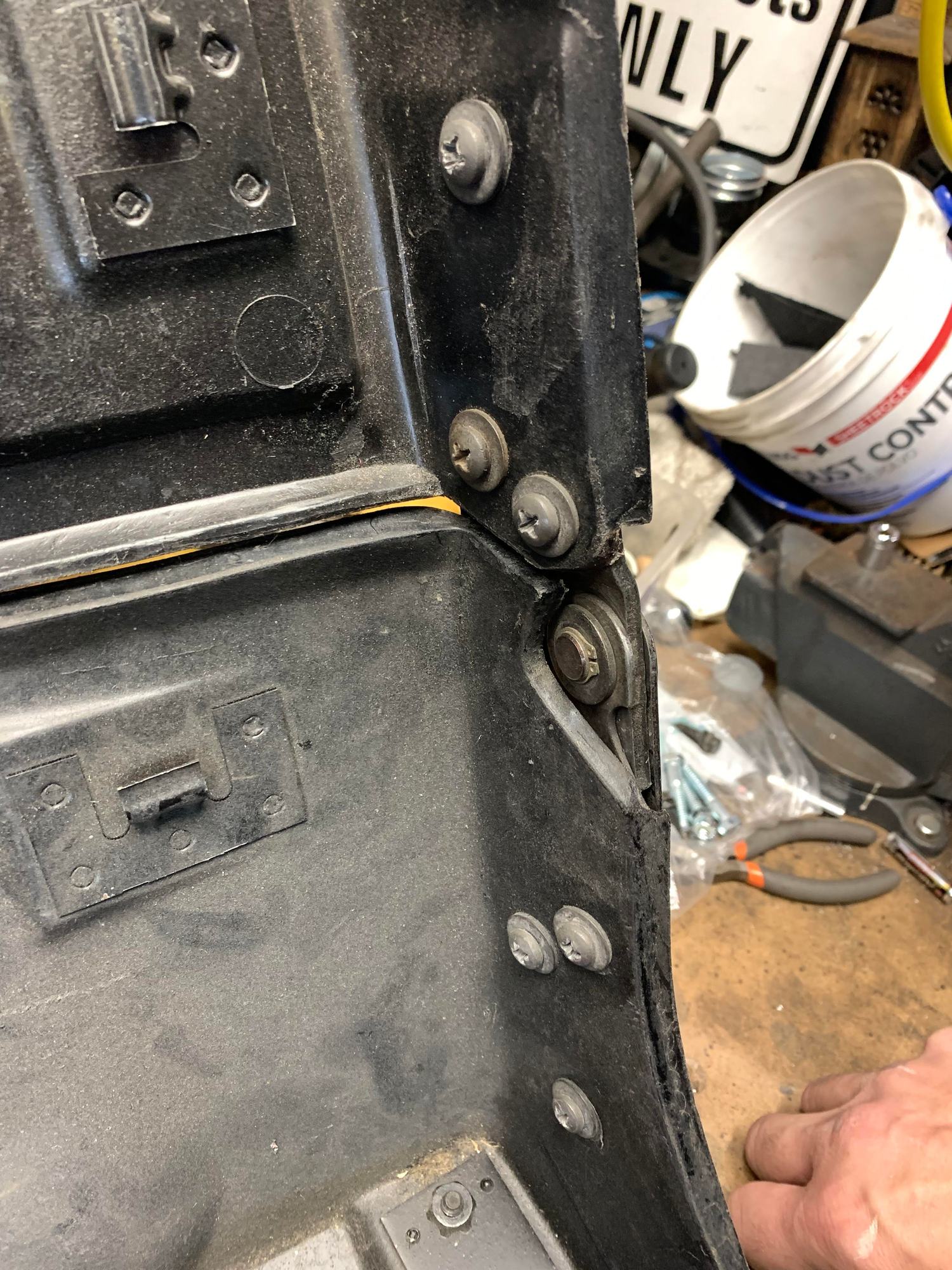

If you have those covers, and want to get them back on, i replaced the original screws that hold on the hinges with bolts. Then i used threaded acorn nuts to hold the covers on. It worked out very nicely and hold the covers on way better
