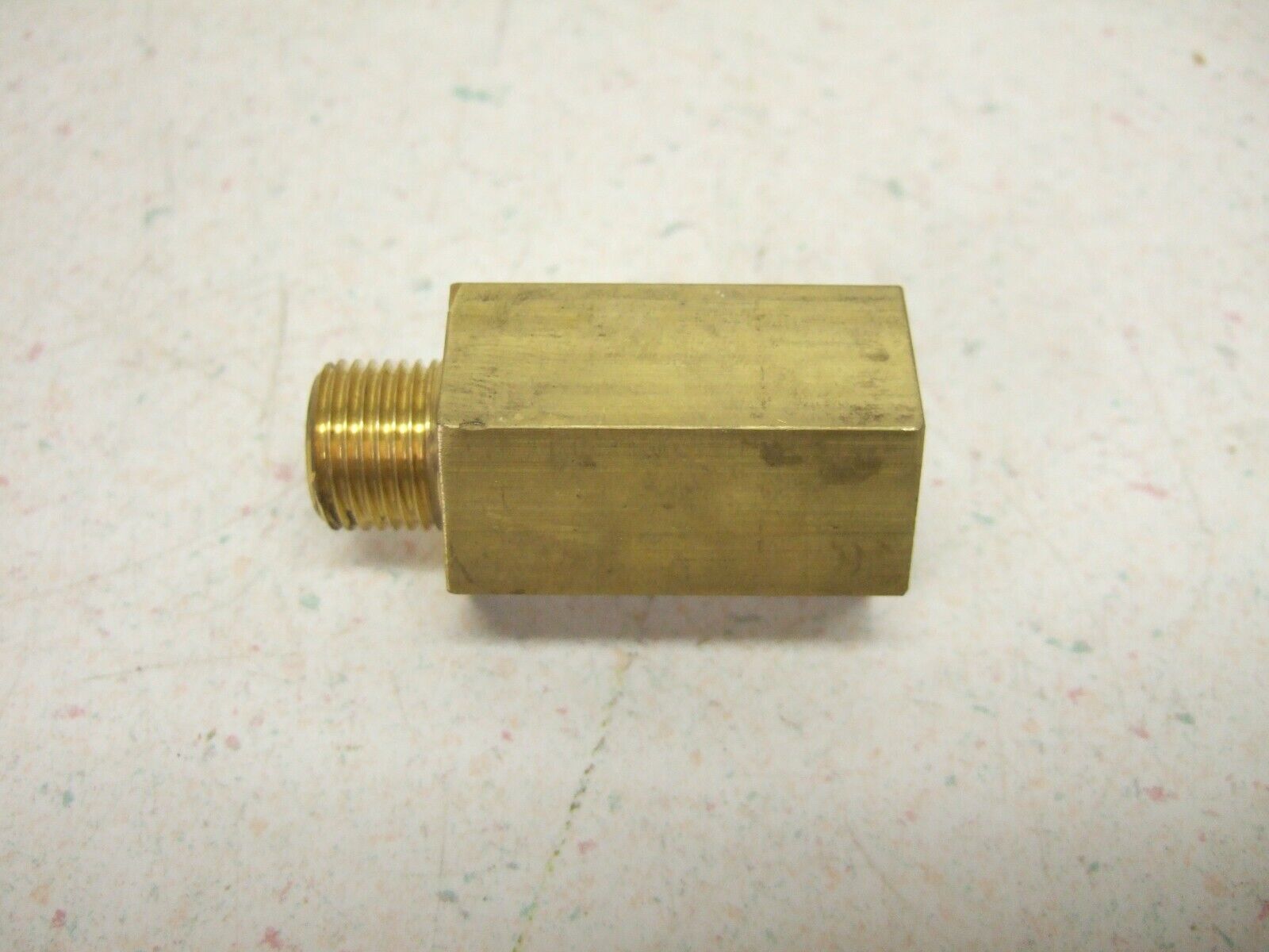

Here is a nice deep one such that the sensor doesn't bottom out....even though I think a regular one would be fine:
https://www.ebay.com/itm/22499125513...QAAOSwkqFig~Gc
and an image for when link dies:

this is 3/8 NPT to 1/2 NPT
