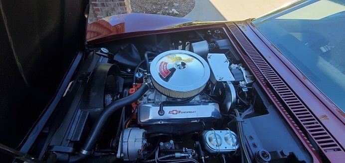

Understood, my question was specifically whether the standard brackets and pump would work with this motor - e.g. do the bolt holes on the front of the block line up the same as an early 350 and is there clearance for a standard pump?
post a pic of the water pump and belts, fan.etc and we will know what it is.
This is the best picture I have at the moment:
Was also curious why there appear to be two belts running between the water pump pulley and the alternator...

Judging by the stock alternator lining up with the pulleys I am going to assume you have the stock pulleys and a power steering pump would bolt in... I strongly advise you consider a Borgeson power steering kit vs the stock kit however as it would be a noticable upgrade with less leaks and better road feel.
ps, Im not sure if its the angle of the camera or what but your engine looks to be leaning towards the drivers side pretty bad in that photo almost as if the drivers side motor mount is broken? even the distributor looks to be leaning badly?
Just to clear this up for anyone who didn't read my original post: this isn't a car I own, it's one that I was looking at as a potential purchase.
I was already on the fence with it having a crate motor and the thought there may be issues if I want to add power steering isn't helping.
Hopefully the leaning engine thing is just an optical illusion...

its an optical illusion. Yes the holes should be there. It could be a later year gen2 with those heads. Getting the block numbers is the easiest way to tell
Haven't got any more information about the motor from the seller other than confirmation it has iron heads.
That combined with the centre bolt valve covers leads me to believe it's probably a 350 HO base engine @330hp - certainly nothing to get excited about.
My car had that belt arrangement too before I added power steering. If the AIR system is not installed and there is no AC on the car, only one belt is technically required. There is no one groove crank or water pump, that I have ever seen. A two groove alternator belt allows you to fill up the grooves on the crank and water pump. The extra belt grip will help to share the wear and is a great redundancy if something breaks.
If you put on a power steering pump you will need to reroute one of the belts to go to the power steering and not to the alternator. This will leave one groove open on your alternator, or you can replace it with a single groove.
