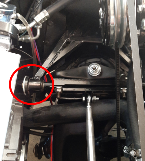

Hi,
On my project car (71 vert) the previous owner provided a set of VBP's square tubing upper a-arms. Installed them but hear a clunking noise when I brake going forward, the again when braking going backwards. Thought it was calipers, but then saw the upper arm shifting back and forth about 1/8th inch on the rod. Less than 500 mi on the car. Thought maybe VBP messed up the bolts and so replaced the 1 1/4 bolts with 1" to see if that would allow proper torque. Torqued tight, but still doing the same thing.
Anyone seen this one before? Or have any ideas on what I can do before I toss these in the garbage and pay $800+ for a new set? Ouch.
In the pic below, you can see the 1/8" space where the cylinder on the arm is not touching the wider poly bushing.

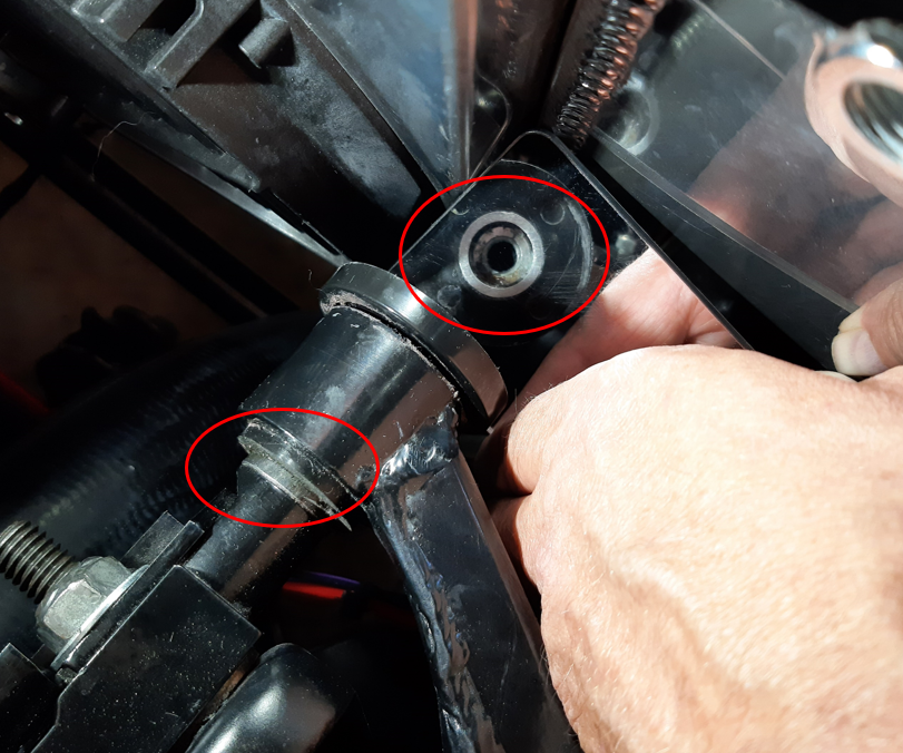

Well, mystery solved on this. Maybe.
The pic below shows the structure of the bush and upper A-Arm. There is a poly bush, but it sits on a metal sleeve and buts up against the pivot shaft. In the pic, a mirror is showing the end of the a-arm bush and pivot bolt. The red circles show where it hits the pivot shaft and also where the sleeve is flush with the bushing. That's why a quick stop on the tightening process.
Looks like these out-of-the-box a-arms have a sleeve that is about .048 too long, which is the gap between the a arm and the bushing.
So can return them, or complain to the mfg. Wait, VBP is out of business, so on my own.. Damn.
So for no good reason, have to re-pull these a arms, grind the .050 out of these spacers and reinstall.
And that involves pulling the radiator, headers, etc. to get these a-arms off. All to fix what was a new part in the box. Jeez.

Problem solved this weekend. Fabricated two washers that go under the existing washer and bolts on one side. But the ID of the washer fits around the metal sleeve holding the poly bushing.. Had to grind and file it down to around .060 thick to fill the gap, but not put too much stress on the bushing. Did the front bolt on the pass side, and the rear on the drivers side. Drove it and all quiet now, and done in about 3.5 hours time including trip to hardware store. Posting this in case anyone out there has experienced the same issue.
