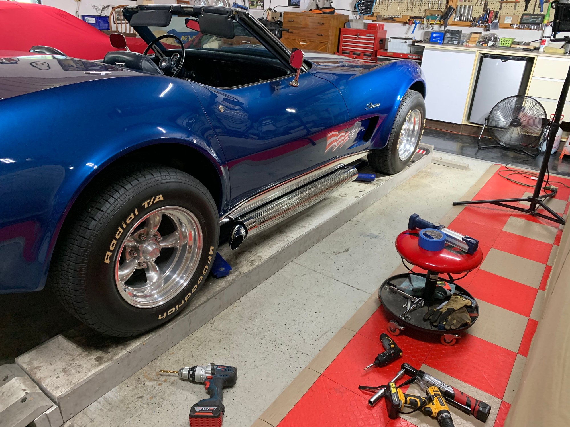

Actually I do have Side pipes

Problem solved!
